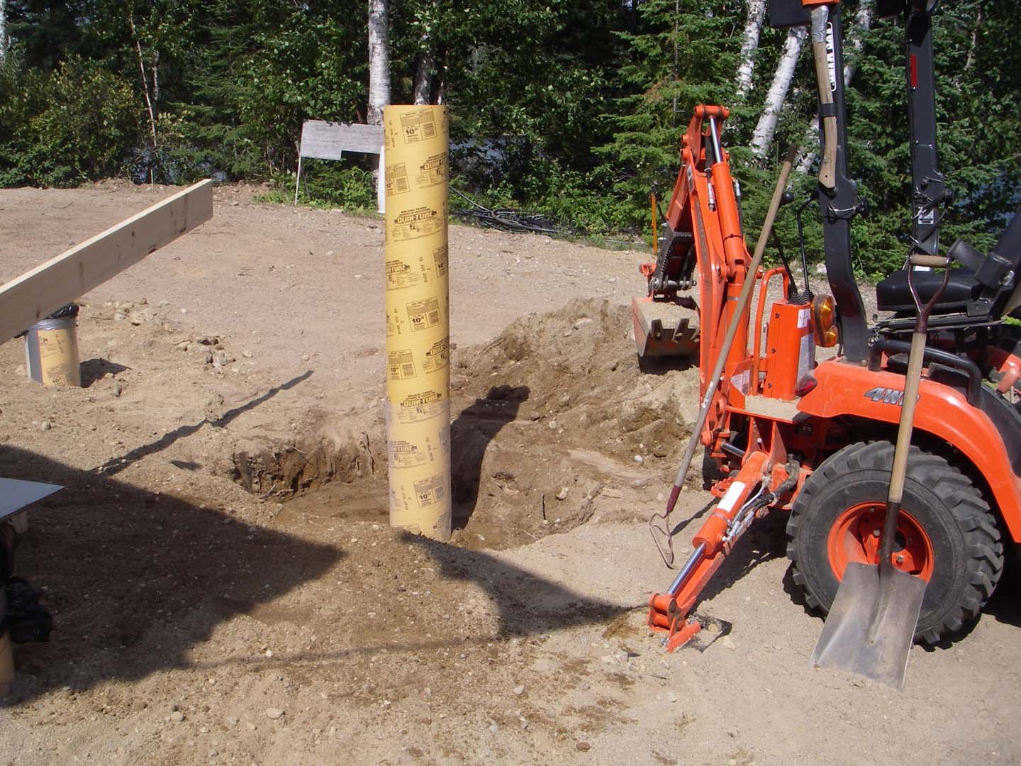

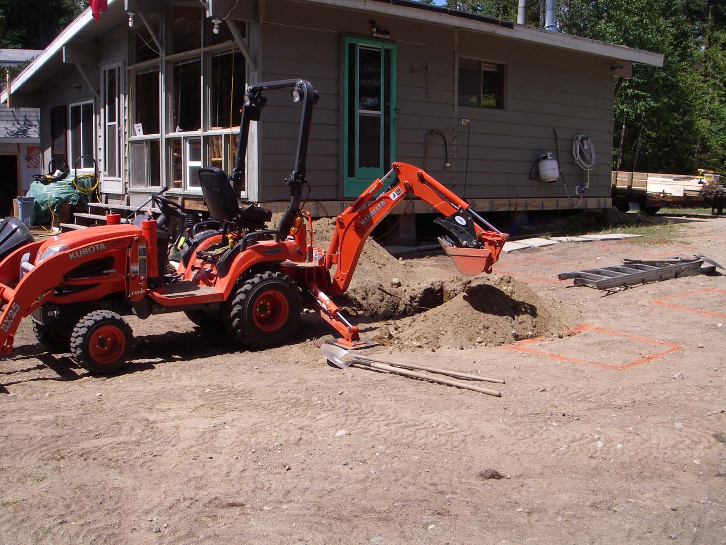

I am 61 and I've had more knee operations than I care to count. I currently am sitting in a beach front condo waiting for spring at home so I can get to back up to my camp and start using my tractor again. :drink: Seriously though it does depend on how much you will use it, how much you can afford and how close rental equipment is to you. My camp is 3 1/2 hours away from the nearest dealer or equipment rental place. When I bought my BX25 I opted for the backhoe and it has proven itself invaluable at the camp. Everything from digging trenches for drain tiles or culverts, digging 14 holes for sonotube / bigfoot footings for my addition, digging grey water tank holes, pulling stumps, putting a pole in for a sat dish, and repairing the camp road. With the thumb I've even moved rocks and other things for my wife's gardens. Two years ago I sold the BX and upgraded to a B2650. The first option I chose was the backhoe. I used some posts from TBN as a guide to upgrade the Kubota manual thumb to a hydraulic thumb. I find I can maneuver the machine around quite a bit without getting off the seat while digging. Takes practice and patience. An excavator or TLB would be way easier but for me it just isn't practical. I leave the hoe off the tractor until I need it and then leave it on till I need one of my 3pt implements. It's pretty easy to take it on and off.
Bonuses with the backhoe - it makes a great rear ballast and the outriggers make a perfect jack for lifting the rear tires off the ground if you need to add chains or ballast or spacers.
