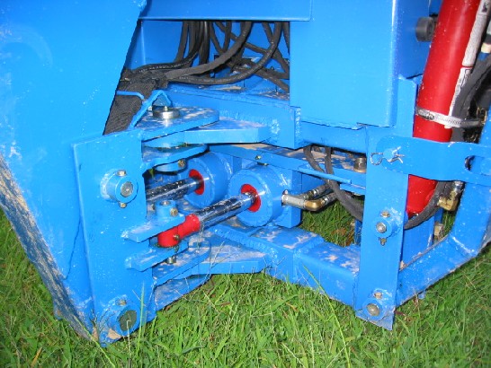

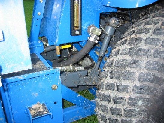

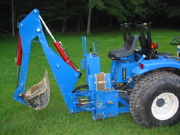

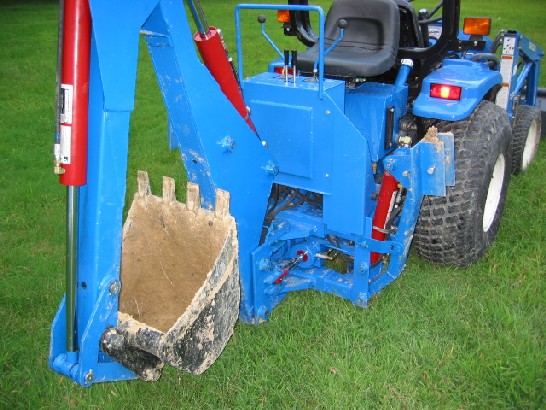

Well, here is my baby. I designed it myself taking some cues from the NH 758. I couldn't find the appropriate trunion mounted swing cylinders so I had to make adaptor sleeves to use conventional rod end cylinders. All the hydraulics are from Prince. The guys there were very helpful and I can't count the number of phone calls I made to them. The only thing that needs some tweaking is the pump and/or hose size. You can read about the problem in the beginning of this thread. I used Pro/Engineer to model everything in 3D cad. I do this for a living as I am a mechanical engineer. I have drawings for all the parts but as always I made some changes and groomed some parts to fit better along the way. The pins are 4140 hardened steel and I had them hard chromed hoping to get longer wear. NH said they use s.s. for some of their bushings at the pivot points. I find that hard to believe since s.s. makes a poor bearing material. It tends to gall. Anyway I used bearing bronze which may be a tad too soft. So I might have to replace them a little sooner than expected. Oh well. The thing performs really well. I rented a full size bh once, and of course it doesn't compare to that, but it does the job. I live in western central New Jersey where we have a lot of clay and rocks. Its amazing what hydraulics can do...
There are 4 pictures in total.
I am still interested if anyone has any thoughts on schematics or routing the plumbing to hook my bh up in series with the fel.
