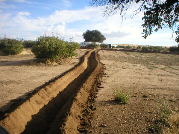

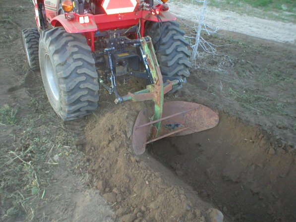

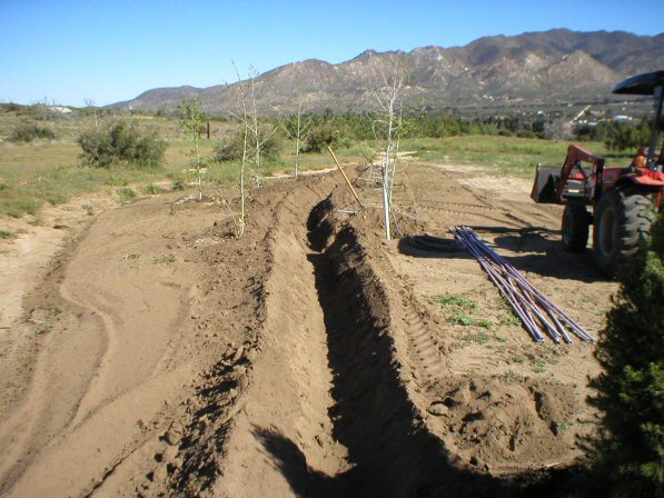

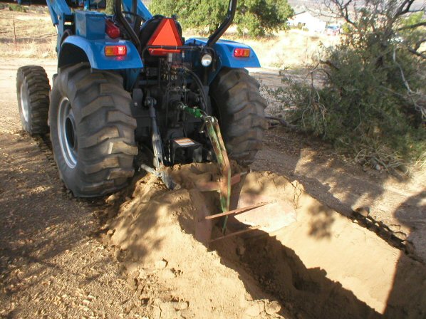

A good middle buster works great for trenching. Mine makes about a 20" deep trench. Way faster than any other way that I know of. But I think that you would need to have rock free earth for it to work good. I have dug a 300' trench in only a few minutes. As long as you don't need to go very deep, mine works very well. :D
With dirt like you have, anything would work well, LOL.
Last year I tried that approach, not with a middle buster but with the single tooth subsoiler. All was going well and then suddenly it twisted, bent the top of the subsoiler and twisted and broke the heavy duty toplink!
I found that it had hit an old buried fence post and tried going sideways :(
I finished the task with the backhoe.
