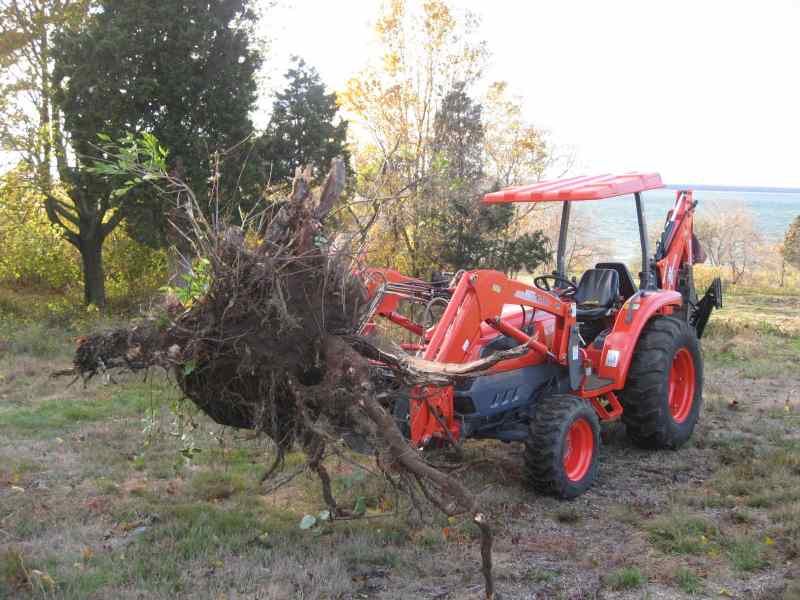

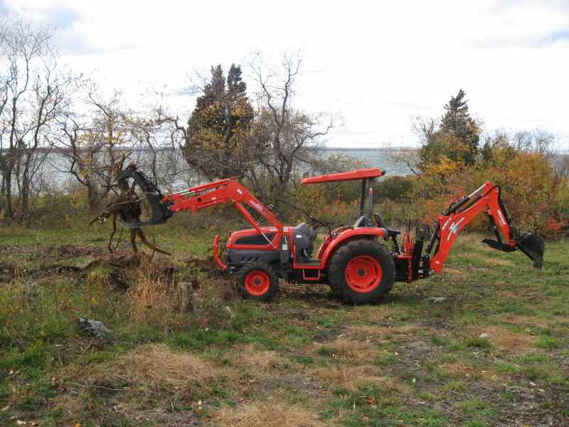

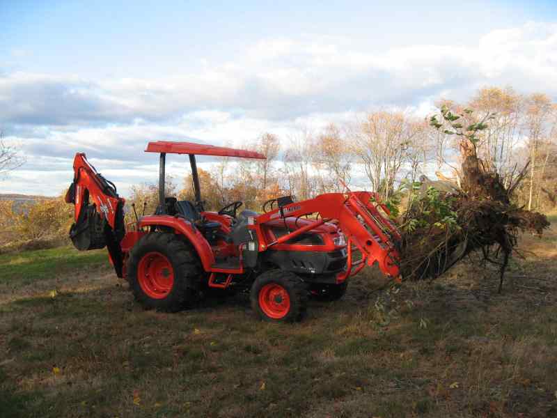

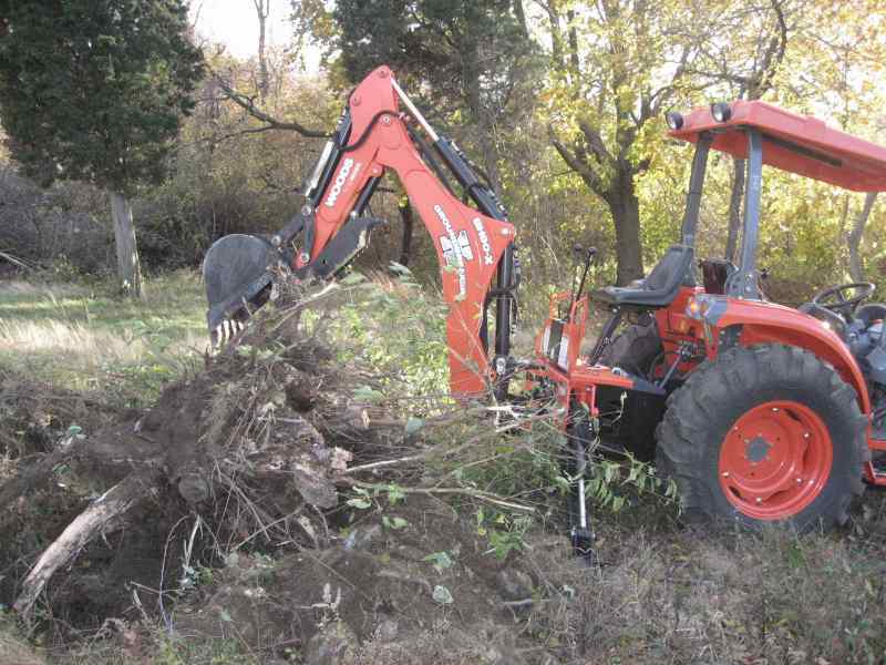

I have a Woods BH90x with a mechanical thumb. Although I am not the greatest fan of BH thumbs, I would probably get that set up again. As I recall the hydraulic version, which is nice, cost and extra $1200-1500 as I recall which seemed a lot for the occasional convenience. To be honest I don't use the thumb as much as I thought I would based on TBN discussions. I have a grapple on the FEL so I find myself digging to get a rock or stump free and then I just close up the BH and use the grapple to get the object and move it to where I really want it rather than just a few feet from the hole. I can see that the thumb would be more critical for digging deeper holes or trenches where the grapple wouldn't be able to reach and that is why I would still get a thumb if I replaced my BH. I would need to be doing an awful lot of digging of rocks however to justify a hydraulic version.
   / Backhoe questions
Thanks for all of your inputs. I think the hydraulic thumb would be a worthwhile addtion, but am now leaning toward adding a grapple instead.
   / Backhoe questions #8

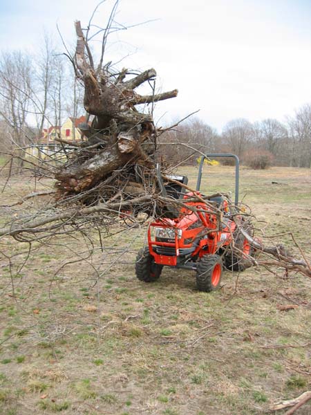

A grapple is a very helpful tool when digging up stumps. You can reach into the hole to pull it out and can even break it loose after doing some preliminary work with the BH (i.e. digging around the stump so you can push it with the grapple or get underneath it with the grapple). It depends of course on how big the stumps are, I am describing using it on 8-10 inch stumps. With experience you can avoid digging big ugly holes and just free the stump up enough to get the grapple access then just pull it out. Obviously this depends on the strength of the loader too. Even if you need to dig out the whole stump with the BH, it is still a big plus to be able to just grab the thing and move it without getting off the tractor to chain it to the FEL. I haven't got a ripper claw yet for my BH but I think it will make getting these medium size stumps out even more efficient and disturb the ground less especially when combined with a grapple and strong loader to lever the stumps out of the ground after ripping through the side roots.
I would definitely advise spending the extra $1200-1500 that a hydraulic thumb costs on a grapple instead. That should be enough to set you up with a light duty grapple or bucket grapple setup and diverter or rear remotes to control it.
