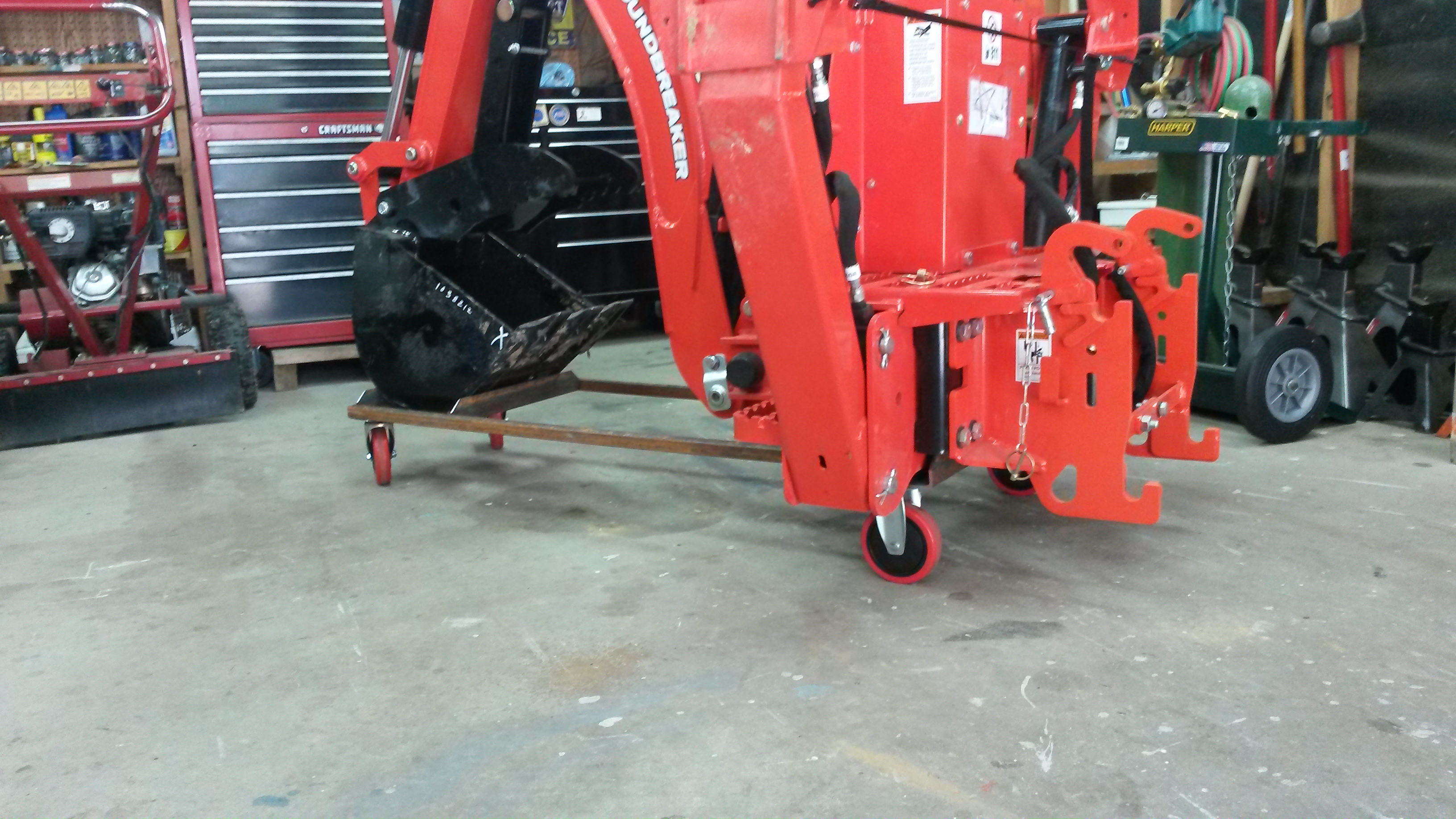

I have a Woods subframe mounted backhoe, and it is very easy to take off and on. Two pins on the top, and then use the backhoe hydraulics to lower it slightly to disengage the bottom pins. (They are solid pins that you can't take out) It is just as easy to reinstall. I just raise the hoe up using it's hydraulics until the bottom pins catch on the subframe, and then keep going until it takes a little weight off the back tires. Slip in the top two pins and away I go. The only downside to a subframe setup is I have to take the 3-point arms off each time. That is very easy to do, and just takes a minute, but it is worth noting I suppose. I like how solid the subframe mount is though-there is zero slop between the hoe and the tractor. It took me probably a half a day or so to install the subframe, but it wasn't really that hard to do. I'm sure a dealer would install it for you too if you would rather.
   / Backhoe removal and install ? #9
What Deere4720 said up there ^
Same experience.
