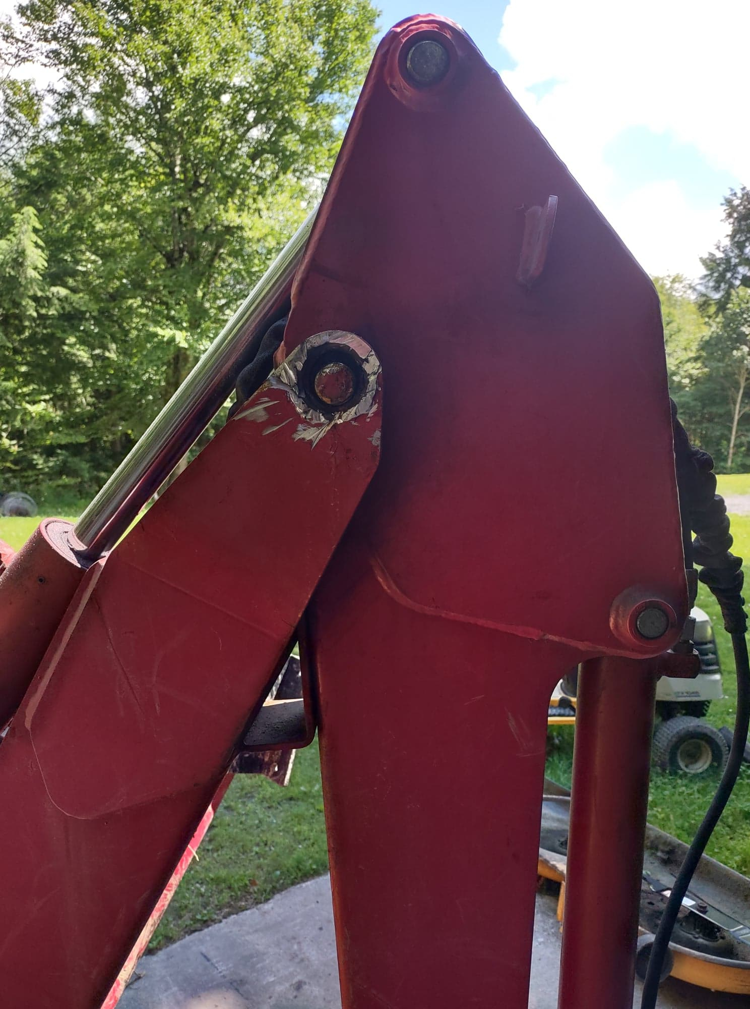

What's the proper fix for this? The hole is worn and everything wobbles. I cut away what I could. Its a massey backhoe.
Is it a "bushing with flange" that i need to put in there?
Where do I fnd what I need? Looks like the pin is 1-1/4 inch.

Could be done with a shouldered bushing. But if u want it done the “right” way, I would weld a bushing in to eliminate maximum pin slop.

Added new bushings to my friends skid steer a few years ago. Pretty simple if u can weld

You can buy "bushing stock" by the foot online. I would cut it out and weld a new bushing on. Along with putting a new pin in there.
