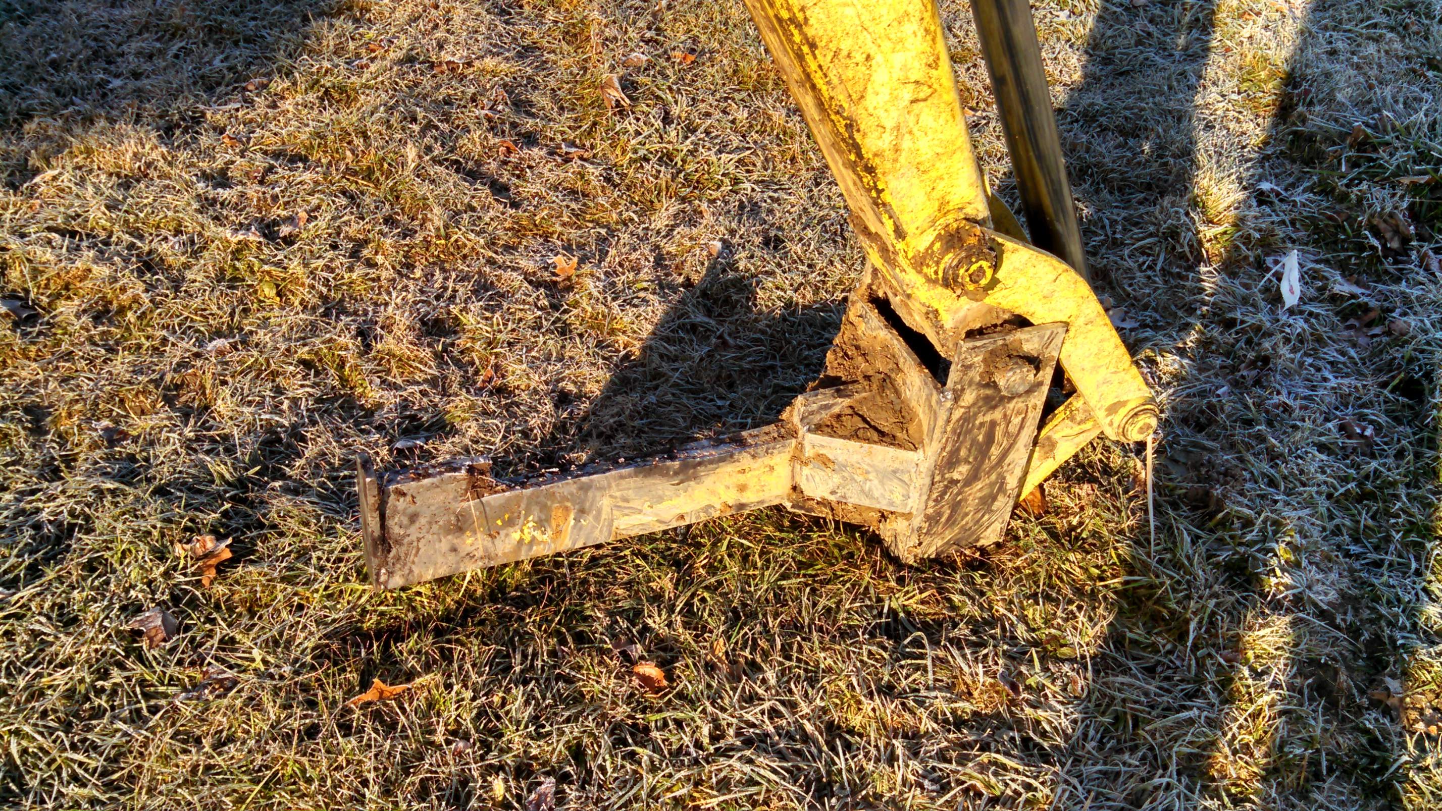

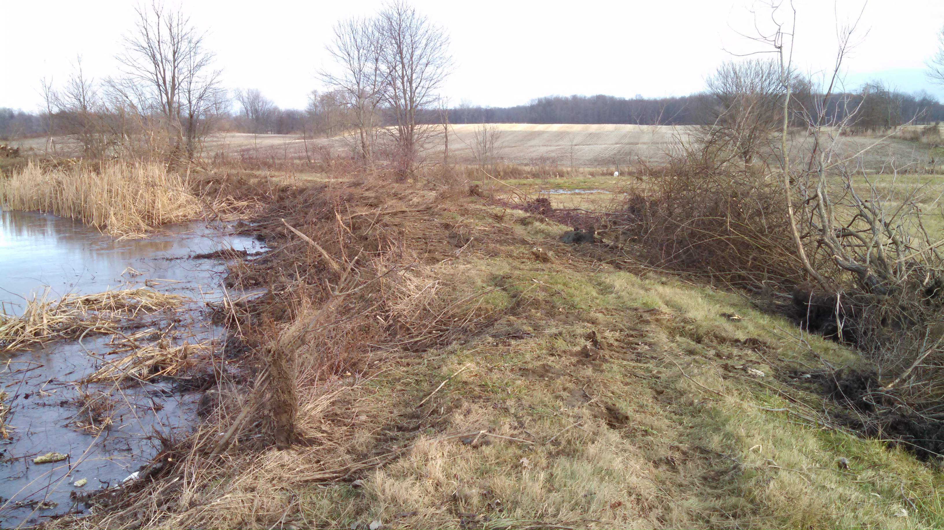

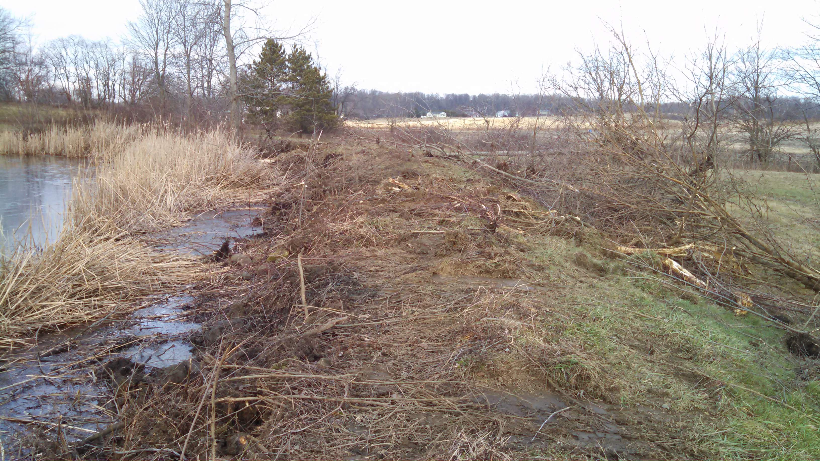

Thought I'd share some pics of a ripper I threw together a few days ago.
Was needing something to start removing trees from around the pond and clearing a fence row. I only had a 2' and 3' bucket and those make a big mess trying to remove 6"-12" trees.

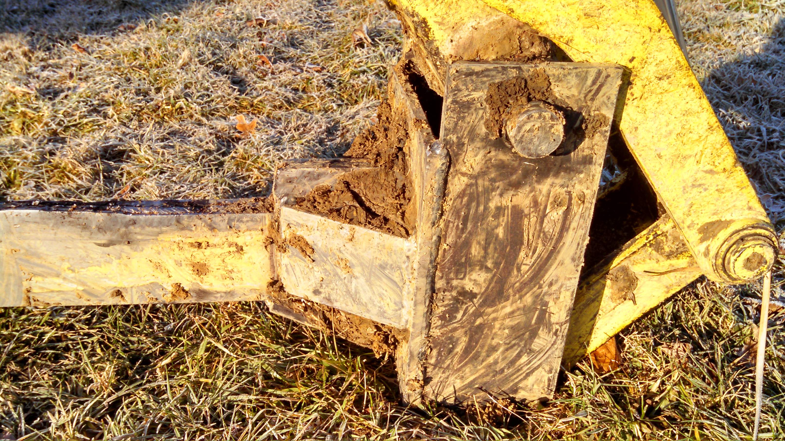

IT was just made with scraps. So nothing fancy. Its all 1/2" metal, and about 28" long. I was worried about the 1/2" metal for the mount where it attaches to the boom, but using it for a few hours yesterday, it looks like it will hold up to whatever my backhoe can dish out.
   / Backhoe Ripper
#2

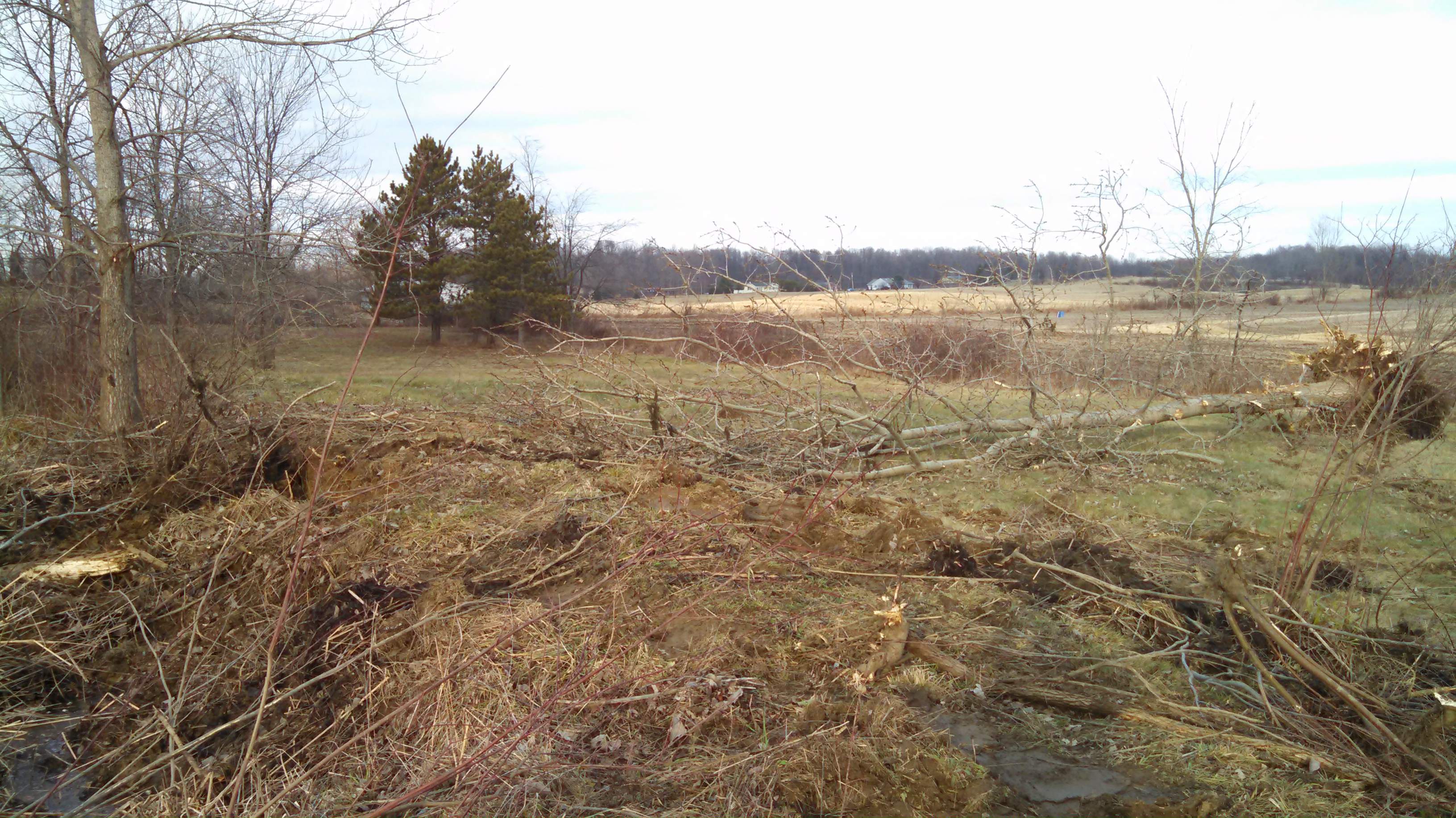

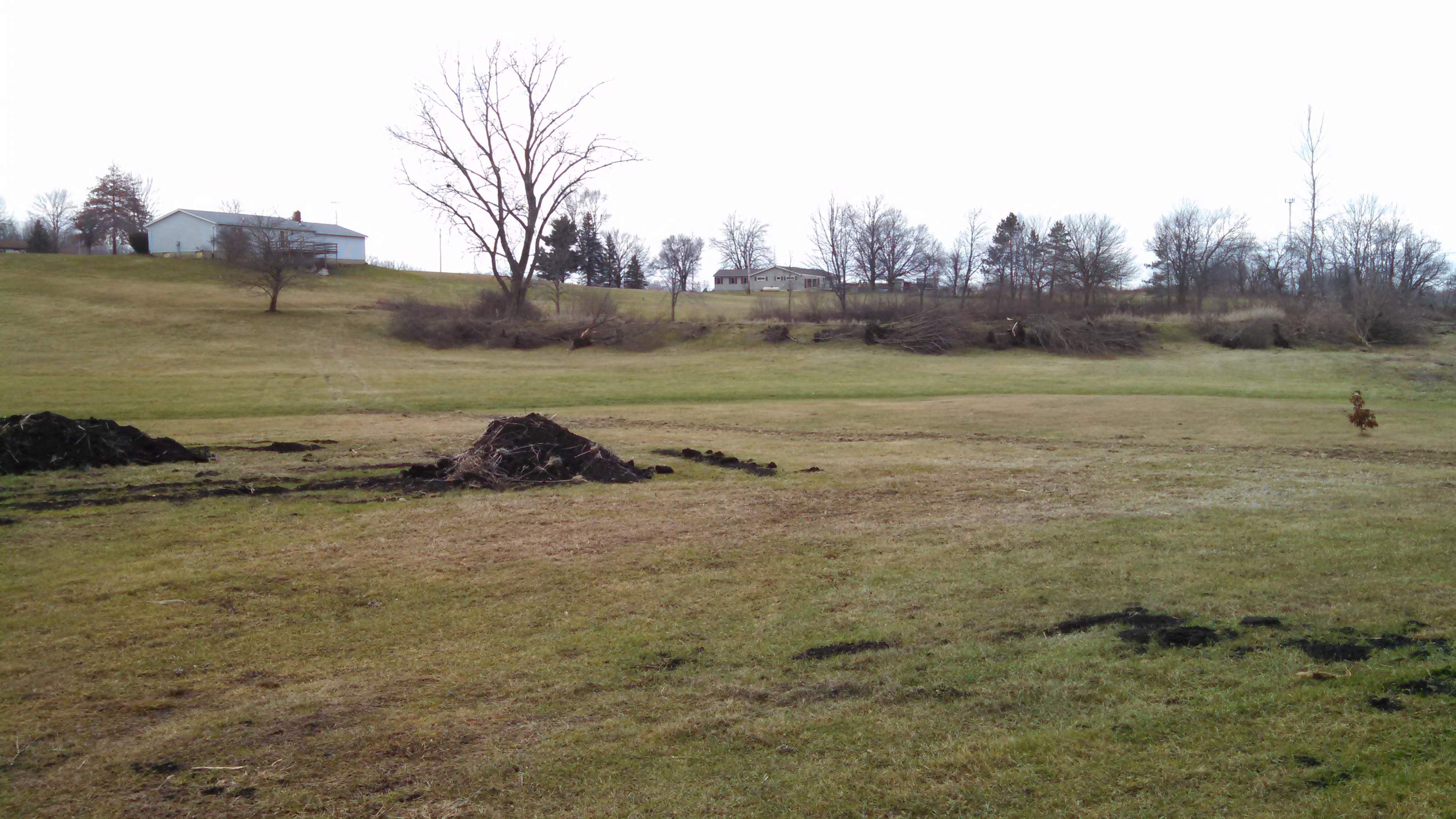

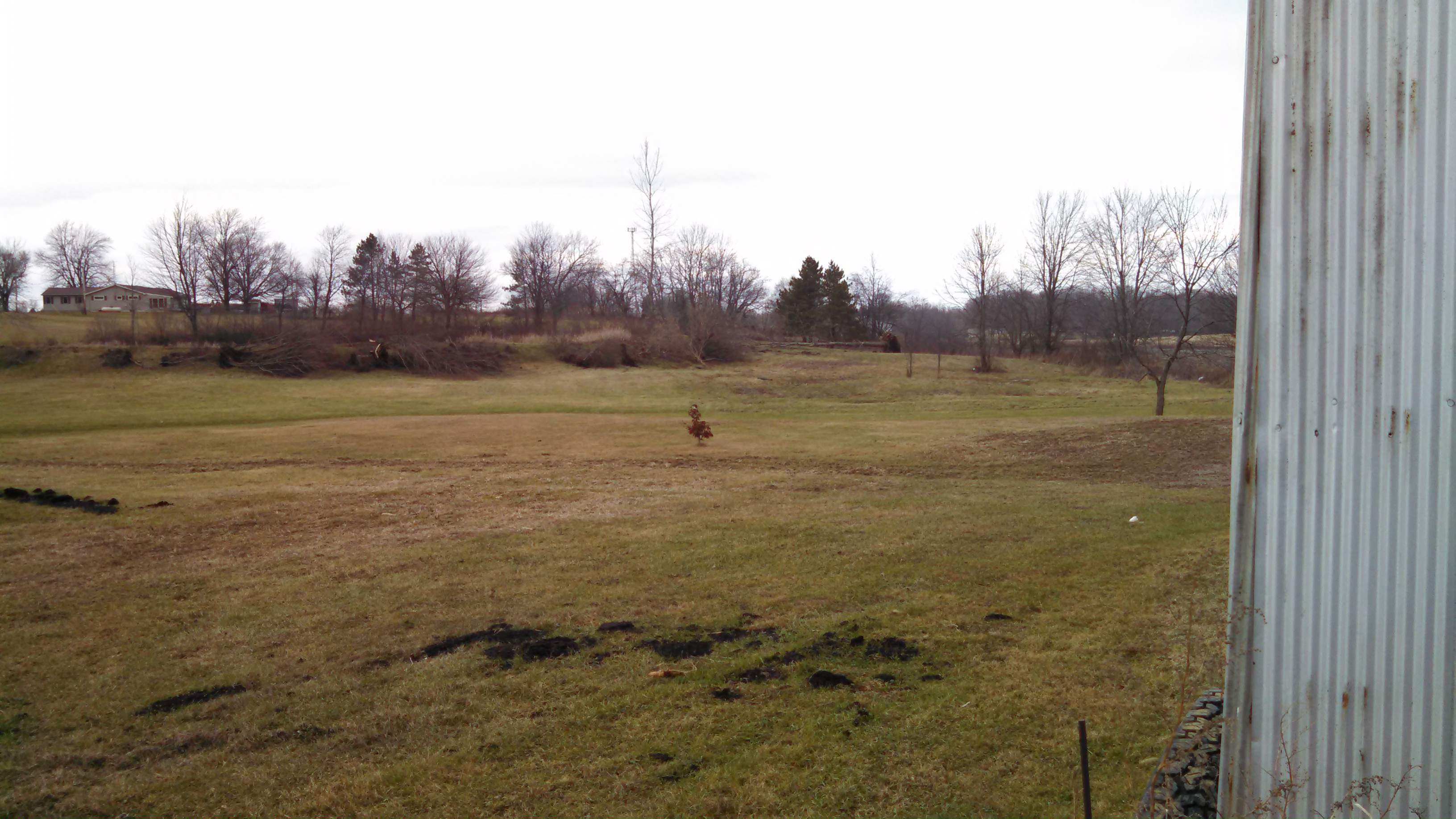

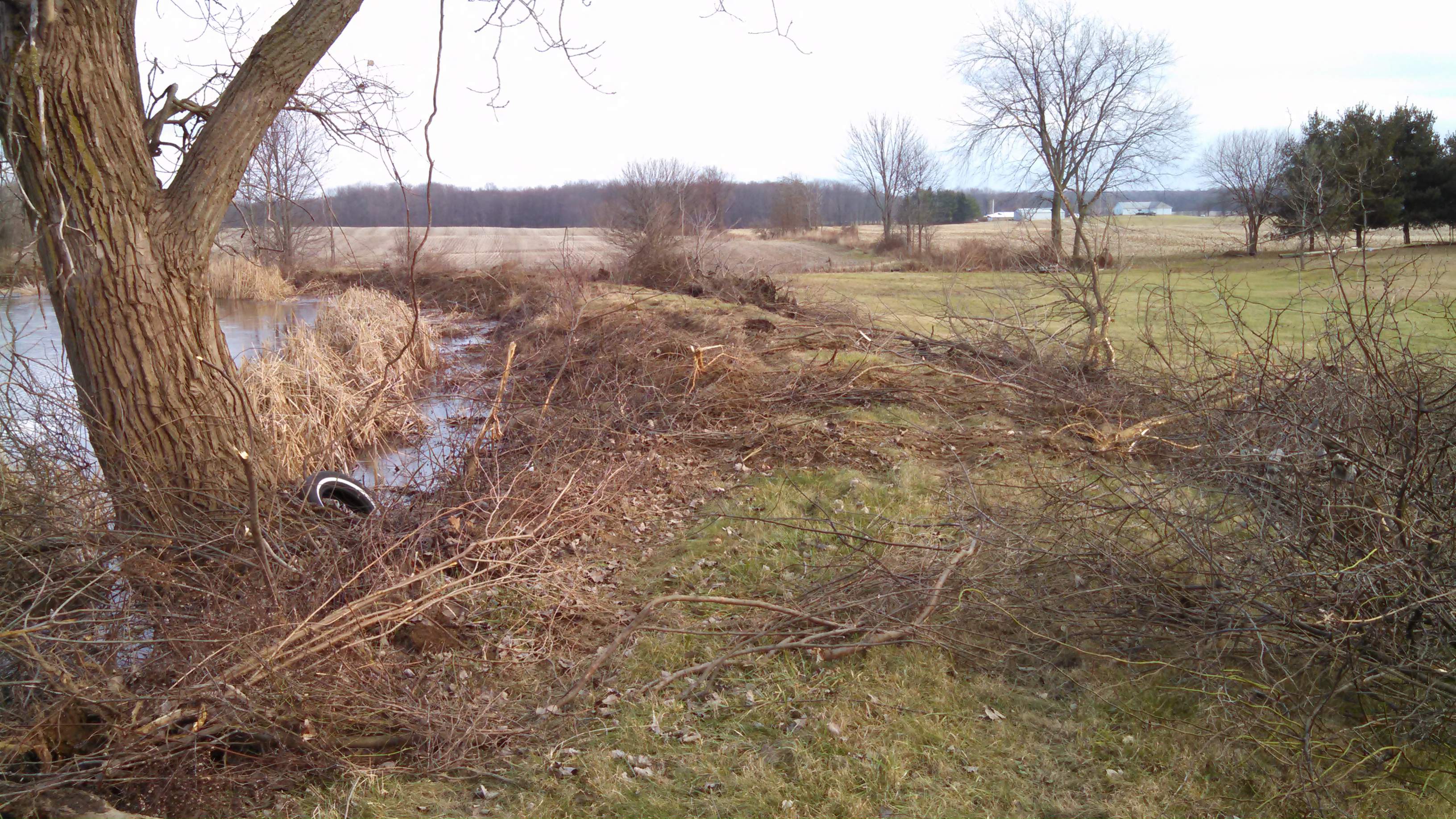

Here are some pics of the carnage from about 3 hours of play

Looks like it works fine. I'll probably be looking to do something like that in the future. It appears the cutting edge is just squared off. Is there a reason you didn't grind it a bit and give it more of a "V" shape to assist in cutting roots?

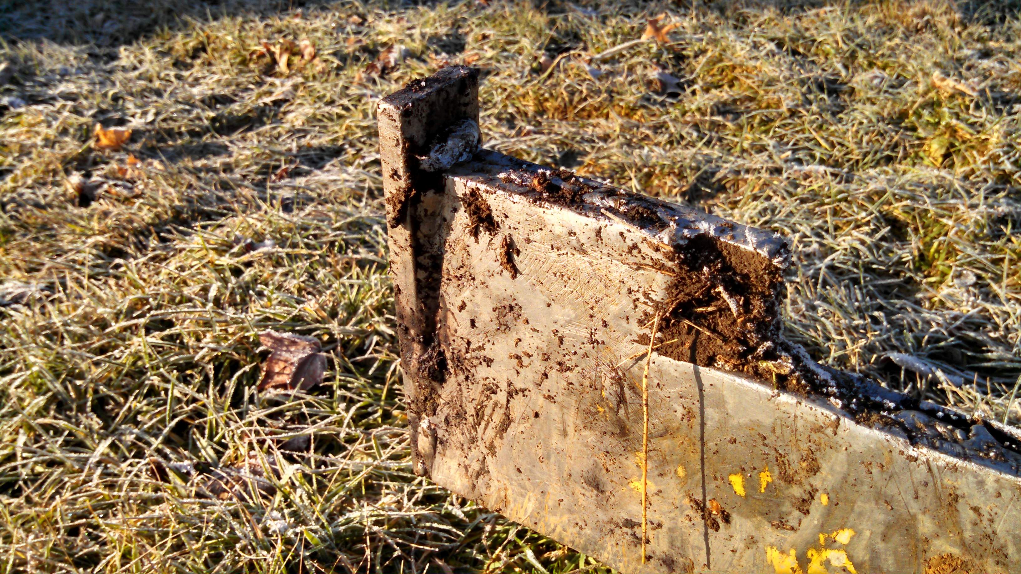

There are a few reasons I didnt "sharpen" it. But knowing that I always could later if needed.
Time consuming.
It would likely just dull quickly anyway.
Alot of the rippers I saw when gathering ideas were not sharpened either. Rather the ones I liked had teeth to help grip and pull. This one doesnt have alot of teeth, but left a step in the metal (was already there, remember scraps), them welded a piece on the bottom to also catch and rip stuff.
And likely the main reason I didnt, is cause I didnt want to slice through the roots. Since this is a pond bank, that will likely be getting reworked in the near future, I wanted to pull/rip as many of them out of the ground as possible, instead of just slicing them and leaving them in the ground.

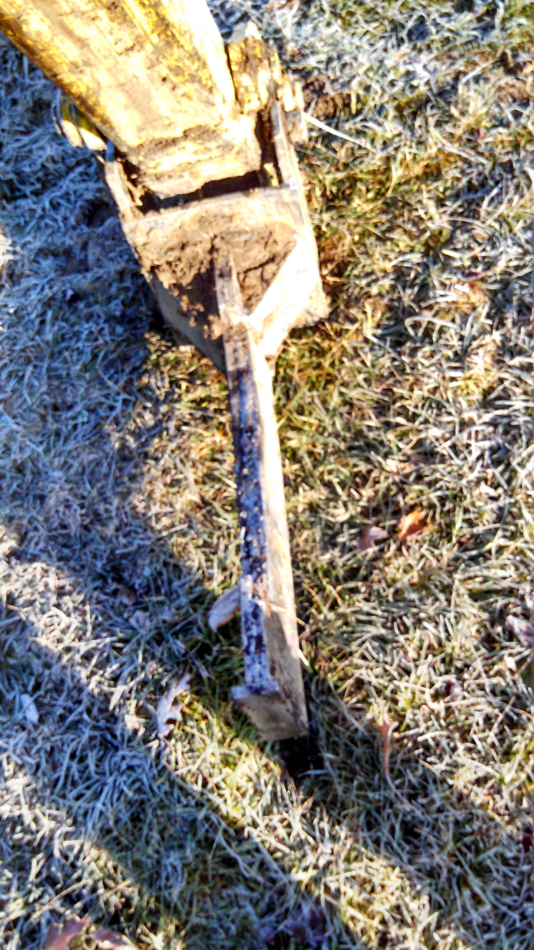

Did you laminate a couple layers of the 1/2" together for the shank?
   / Backhoe Ripper
yep. 2 pieces. touching in the front. and spaced by a piece of 1-1/2" steel at the back to make it more wedge shaped. And by design it wasnt really to make it like a wedge, but to gain some thickness so it had more side-to-side strength and not just bend over.
