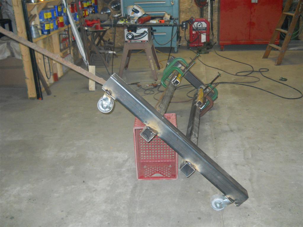

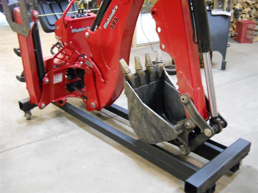

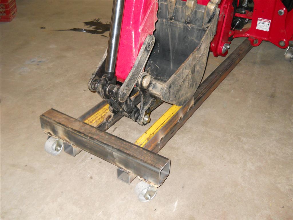

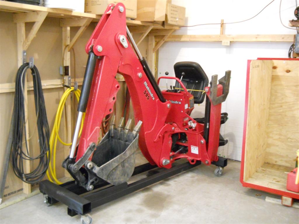

Homemade dolly ... [ not the blowup kind.. ] Warm and comfy ... tucked away for the LONG UNENDING winter.... :) [ don't have to do anything but wrap something on the hose ends to keep them clean. AND, tie a rope/use chain/etc. to keep the outriggers from drifting down ]
