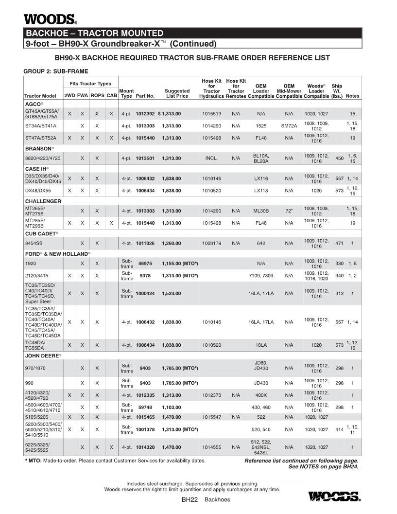

Hello NH owners,
I'm about to purchase a used Woods BH9000 backhoe complete with it's subframe kit. The BH was used on a 2000 or 2001 New Holland TC40. I have a 2004 TC35. Can anyone out there tell me if the subframe kit that clearly fits the TC40 will fit my tc35? I haven't had a chance to put the two machines side by side, but I believe the only differences between them are in the engine and not in the frame model. Your prompt response here would be great, as I am hoping to acquire the backhoe this thursday (the 4th of July).
Also, the swing cylinder for the backhoe is weeping hydraulic fluid. Can that cylinder be repacked easily?
Many thanks in advance for any counsel.
Jed

Jed, here is a page from Woods Subframe reference list.
   / Backhoe subframe compatibility 2001 TC40 vs. 2004 TC35
Thanks, Luremaker. While the page you posted is for the newer BH90-X backhoe (vs. the BH9000), it confirms that any subframe kit (regardless of backhoe model) that fits the TC40 would be interchangeable with the TC35. Can't wait to start digging!
