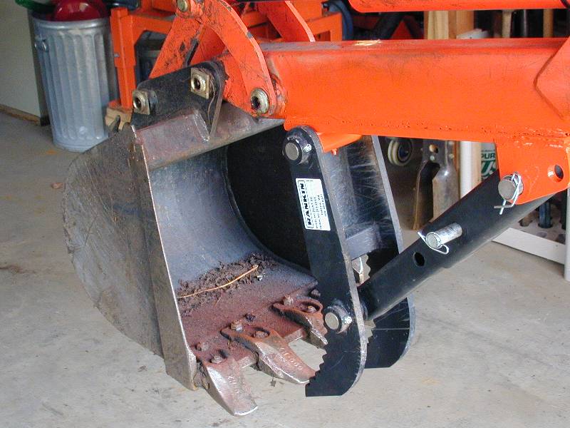

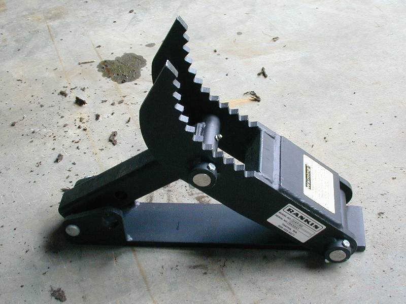

A number on months ago I bought a thumb for my backhoe, and finally got around to installing it this past weekend.
The Thumb is from Rankin Equipment, and is the smallest model they make. It seems to fit well on my 7 1/2' Kubota 4690 BH.
This picture is is thumb before installation.
   / Backhoe Thumb Installation
#2
Here's another shot of the thumb welded to the dipper stick. I do not have a career as a welder - that's for sure. At the same time, my litle Hobart welder did a pretty good job.
Here it is all together with the mounting base painted to match the tractor BH color. After LOTS of grinding and with the camera at a healthy distance, my weld joint doesn't look too bad (ignore the pock marks).

Nice looking thumb. Looks very well built. How much did you have to give for it?
/forums/images/graemlins/smile.gif
It was around $450 with shipping. It is quite beefy, yet I managed to bend it already, however it was totally my fault. I lifted a VERY large, long rock from one end, and it twisted as I lifted bending one of the tooth points. I'm luck I didn't do more damage. Stupid move on my part.
Lesson: Always lift something from it's center so it's balanced.
That said, the thumb is great. It's another one of those "I can't believe I waited so long to do this" attachments. I picked and plicked a number of rocks, stumps, and other crap. Very handy.
