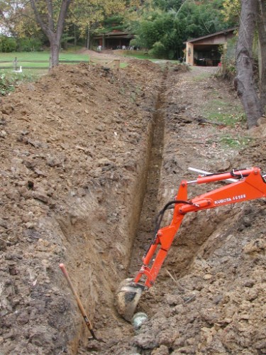

I dug a 250 foot trench with my BL4690 last fall. It was 42" deep. I think it took about 10 hours digging time, maybe a little more. I did not time it. Someone with more experience more talent might do it faster. (attached a photo)
It was all dirt with no rocks or shale. The tape around the stick marked 42" when the bucket was straight with the stick, and made gaging depth easy from the backhoe seat.
My guess is that with the BH75 you will get about the same performance. If you have to work IN the trench, you may wish you had a 16" or wider bucket though. If you are just dropping something in and backfilling, probably not an issue.
