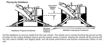

JMIII's picture shows it best. You do want to unload the tires(front & rear) as this will take the "spring" out of the system. You only need three contact points (in this case two stabilizers and 1 bucket) to define a plane (the ground).

This is excellent, John! Where'd you find the illustration?

I agree with the picture. When I had my 20000lb international I just took the load off the tires in the rear and just slightly lifted the front tire off with downpressure on the bucket. I kept the bucket flat as that distributed the weight over a largers area and seemed more stable than putting the edge into the ground. Never saw the benefit of lifting the rear tires 10 inches off the ground although I have seen operators do it. (Course I've seen enough stupid things done by "professionals" in various areas that I don't just automatically assume they're doing it the correct way!!!)

But you are ignoring the distinction and balancing of stress interests raised in Boondox's opening post.
Yes, taking the weight off the rear wheels may make the most stable digging platform, but does it add too much stress on the short 3ph arms that are now bearing the entire weight of the tractor? That is not an issue when there is a subframe, which becomes a giant lever completely underneath the tractor.
I think (this is completely all theory with no practical experience) that when you have a 3ph mounted hoe, you have to balance tractor digging stability agaist stress on the 3ph.
