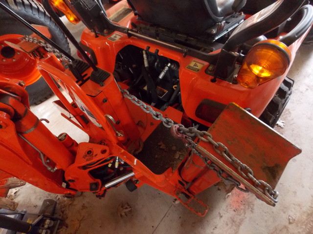

/ Backhoe when not in use? #13
I keep the boom on my BX25 pinned. The bigger problem was the creep on the stabilizers. I eliminated that problem with a chain between the pads.
/ Backhoe when not in use? #14
Mine don't creep (yet), but I still think a chain between them is a good idea. Thanks.

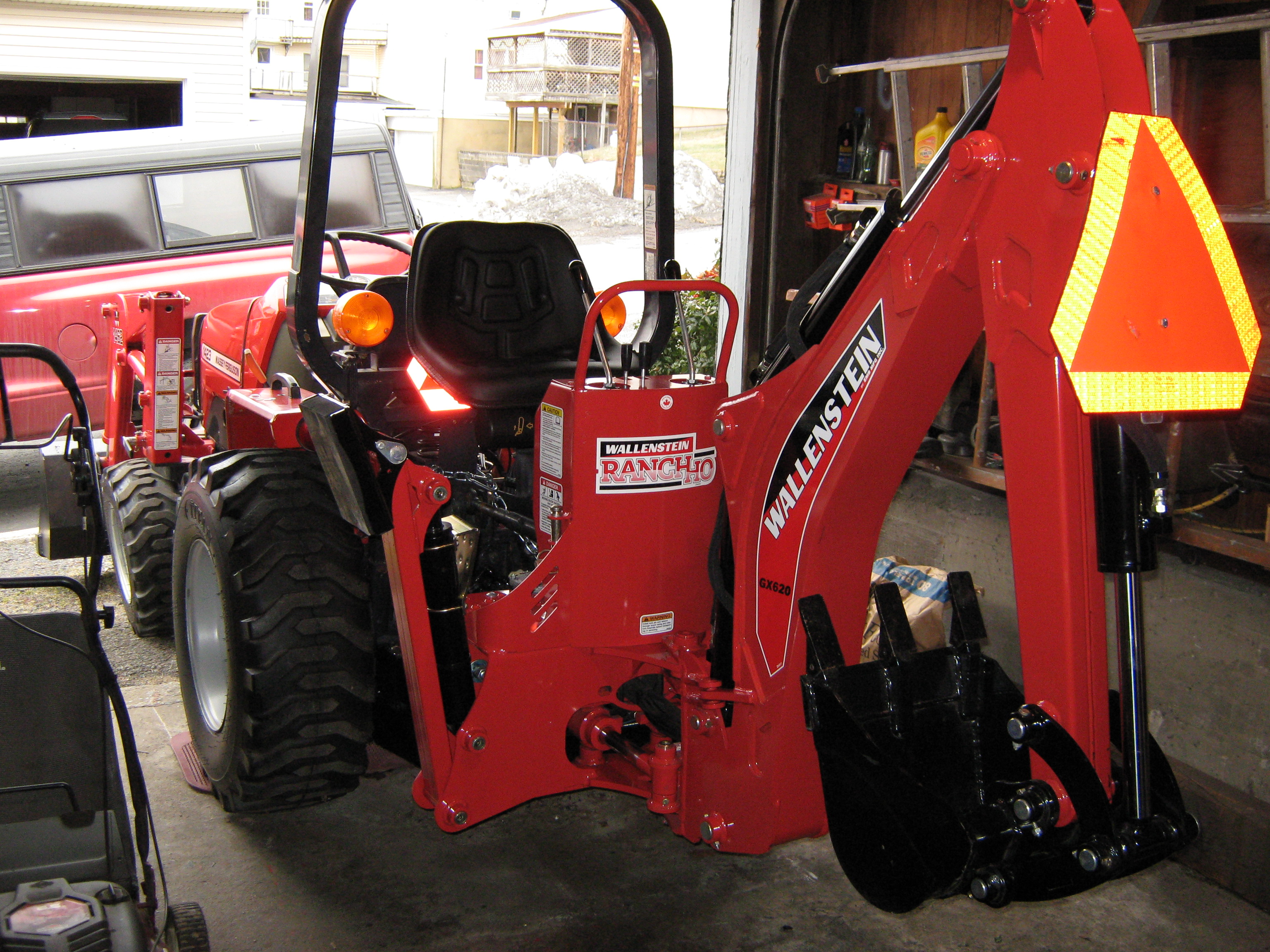

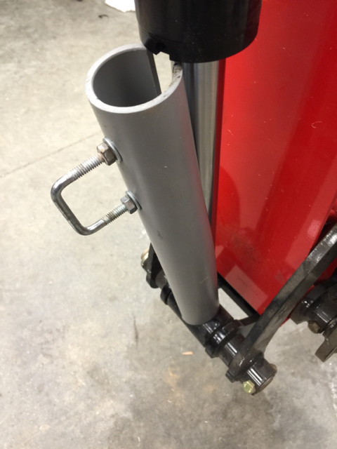

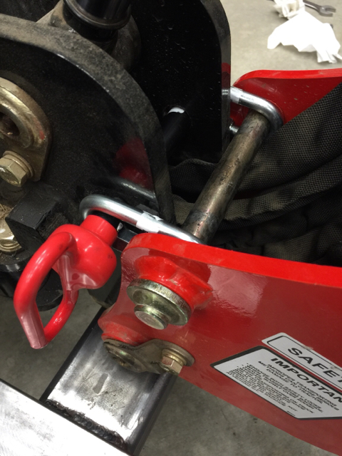

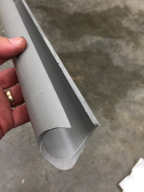

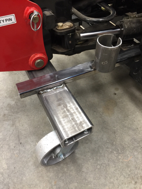

/ Backhoe when not in use? #17
I take my BH off and set them on mobile dollies that have "cylinder pockets" for the outriggers. I wanted to store it very compactly in my shop under my pallet racks and the outriggers were the widest points. I just unpin them and reset them upright just next to the boom and there's absolutely no pressure on them. The hoses still remain attached.
My lower boom are set resting on the pins but the upper boom had to be set lower to fit under the rack to conserve space. The bucket, which is now closer to the ground, stays curled using a piece of slotted gray plastic electrical conduit that are notched at one end and is snapped over the rods to keep the bucket from touching the floor.
I now can store the BH with less than 30" of width under the racks.
