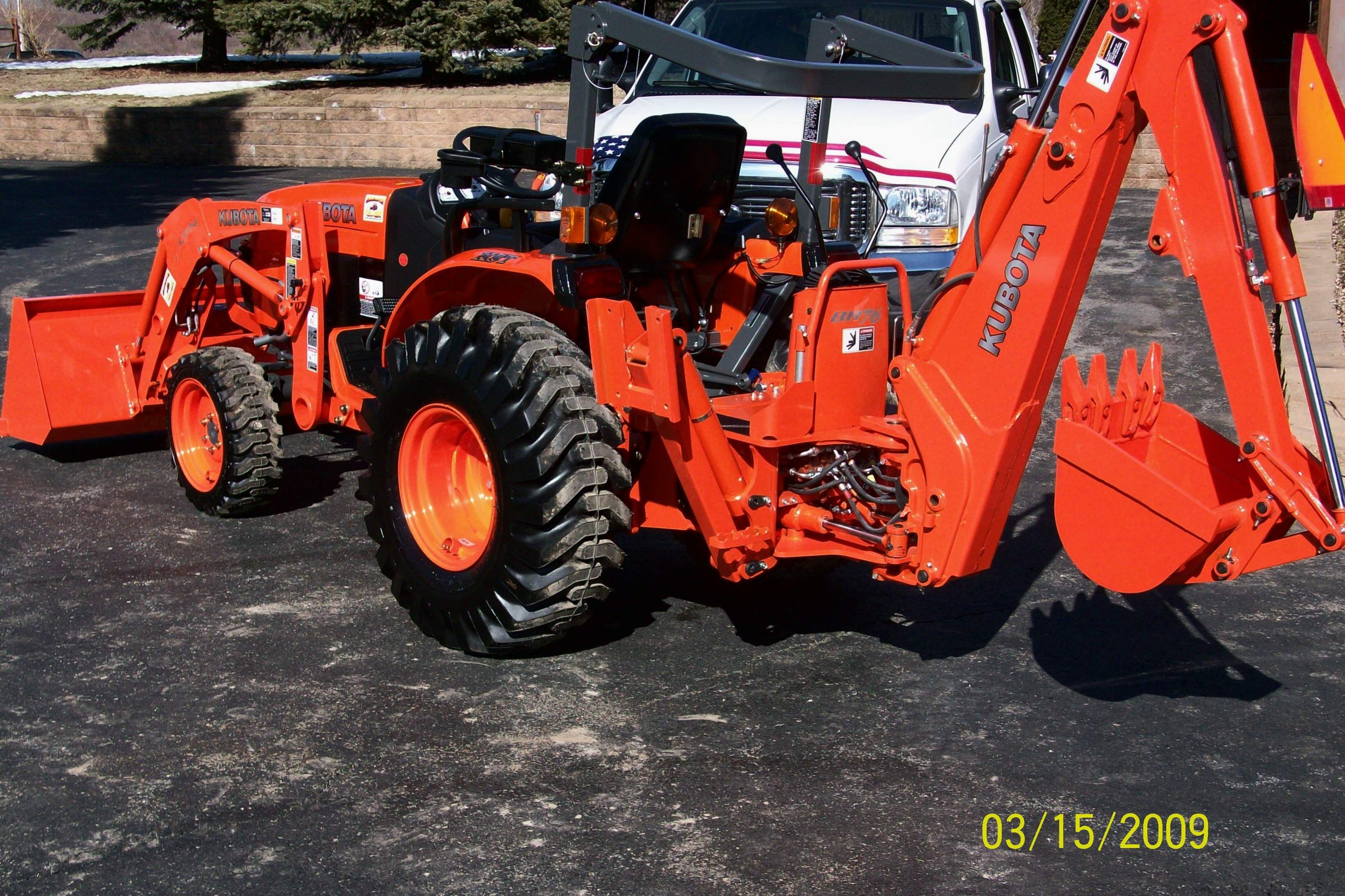

   / backhoe-Woods Bh70X-80X or kubota Bh75 #5
100_0263.jpg Wood's make great things, real strong and there backhoes are up to snuff. That being said Kubota engineers everything to match to there tractors, FEL's, MMM's, backhoes. The in-closed picture is my B3200 TLB with the new BH76:thumbsup:. Real strong hoe, but I'm not surprised because this is my second Kubota TLB that I've own.I would stay with the Kubota backhoe if it were me,makes sense to keep everything Kubota on tractor. Think of a Ford truck with a Chevy transmission. And the good thing is It's already orange.
