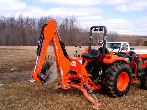

My wife has had such a good time operating the new TC45DA that all resistance to purchasing a backhoe has evaporated. Wasting no time, I intend to visit my trusty dealer to discuss the backhoe purchase. I have read enough over the past few months to be convinced that OEM subframe mount units are the best, if saving a few dollars is not critical. That said, I thought I ought to solicit any last minute comments that folks might be willing to offer regarding the 758C unit that NH offers for the 45DA. NH states on its website that the BH can be installed quickly, without having to remove the 3pt links. I suspect that it is trickier to install and remove than NH would have you believe, but I'll get use to it, I assume. Also, I have TnT, so I will make sure I find out from the dealer whether this complicates matters. If there is anything else I should consider before I pull the trigger on the 758C, please let me know.

The sub-frame mounted backhoes come off a lot easier than they mount but you will get used to the procedure. It gets quicker each time that you go through the process. There have been lots of guys including myself that have made dollies to make lineup a bit easier also. Just smile and think of all the holes that you are going to be able to dig shortly.
   / Backhoe #3
The 758C is a nice match to the tractor and you will be glad you got the subframe when you see how much force is exerted on the tractor when your digging a stubborn stump etc. As far as install/removal - I agree with Pine Ridge - it gets a lot easier on the second and third time and a snap after that. Just be sure to back up square to the subframe.

IMO go with a Bradco 509. On and off ia a lot easier the the NH model. Might be a few $'s more but it will be worth it if you want a strong hoe. Othere positive note worthy advantages no loss of ground clearence, better angle of departure, & heavy duty pistons.

Rhino builds the ones that I have seen.
My Rhino 85 is the same hoe as the NH 758c

I ran a 758 hoe on a Ford 2120 from 1987 to a couple of years ago when I traded it for a larger hoe for my TN. The Ford/NH hoe worked fine for the thousand or so hours I used it. I dug out many large stumps, and moved huge bolders by using leverage. Off was easy, and on was ok on firm level ground. I found a jack to be a great asset to get it on quickly and easily.
