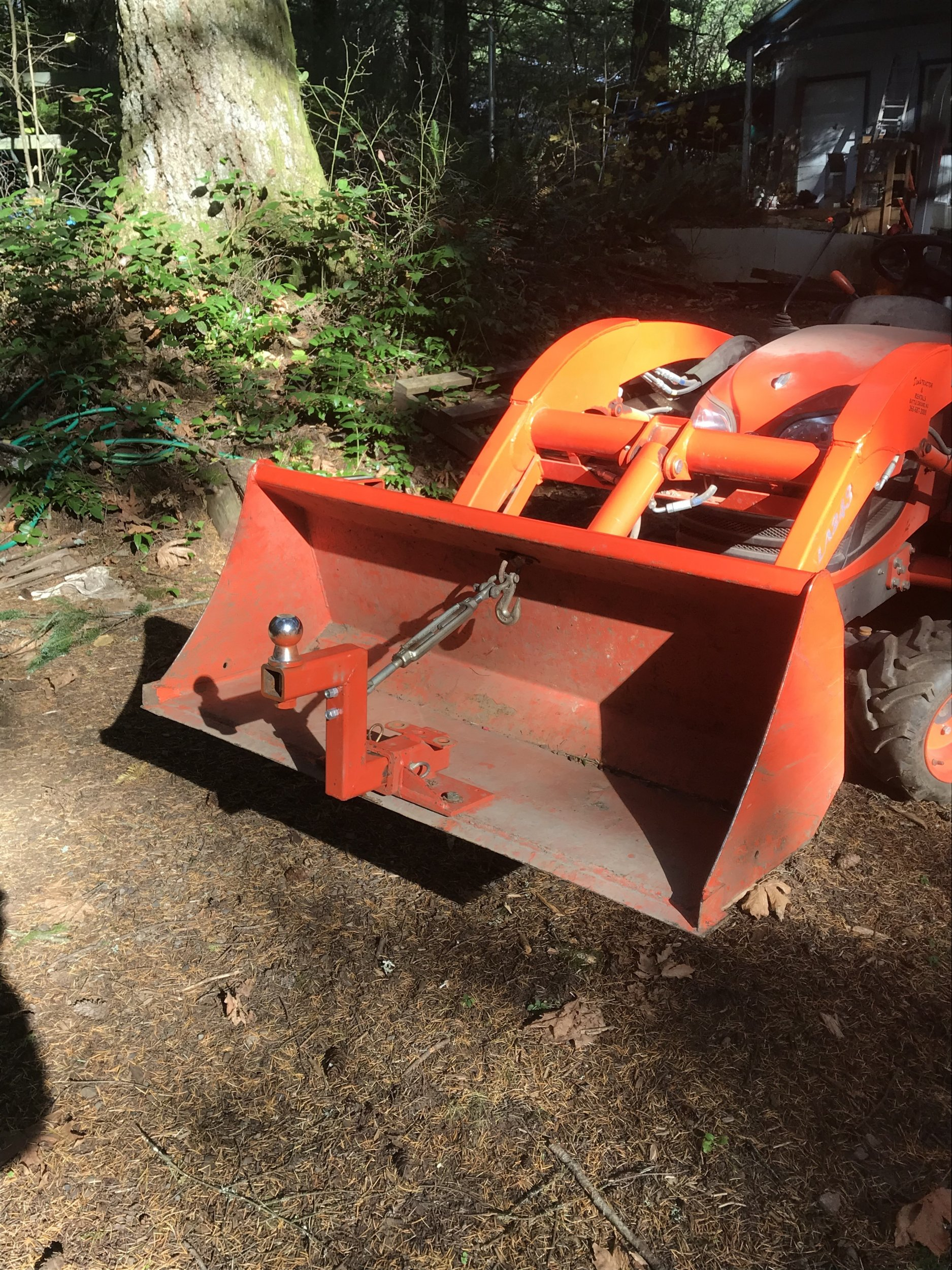

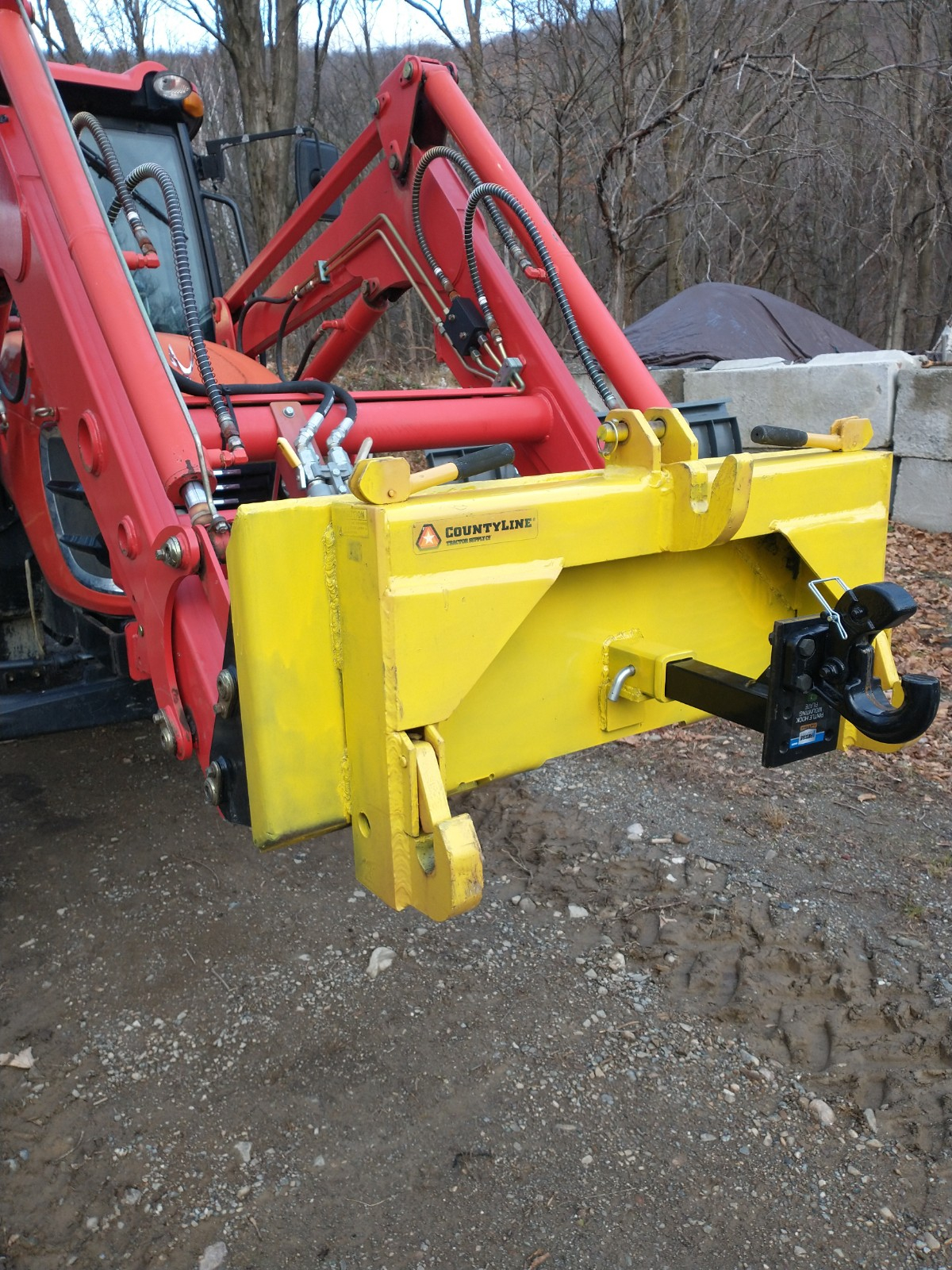

Maybe try getting a 2” receiver that clamps on the bucket and try pushing it in with the loader instead.
   / Backing up a Gen Trailer #4

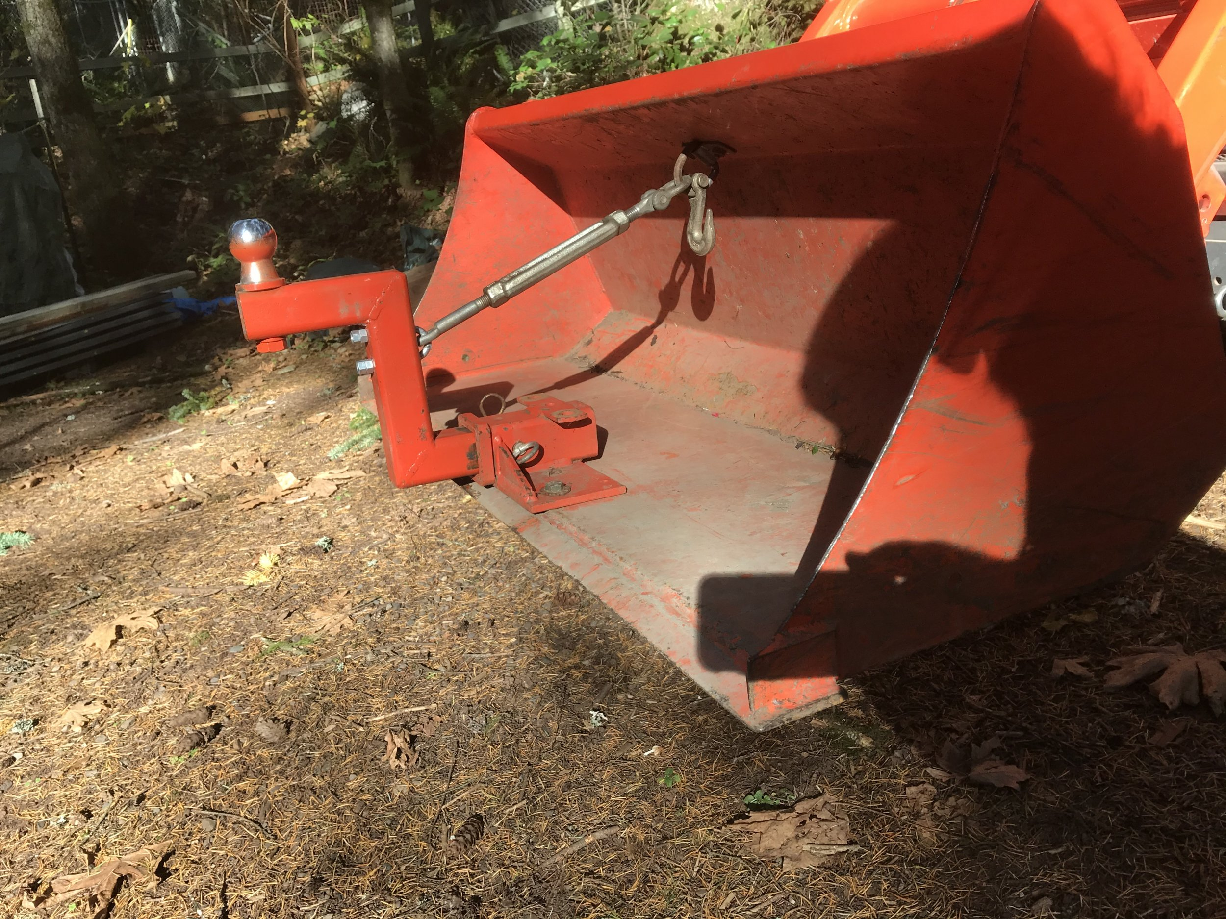

The ball mount was from a yard sale and it raised the ball so it was visible.
The brace was needed due to the lightweight bucket flexing a lot with all the leverage of the tall mount.

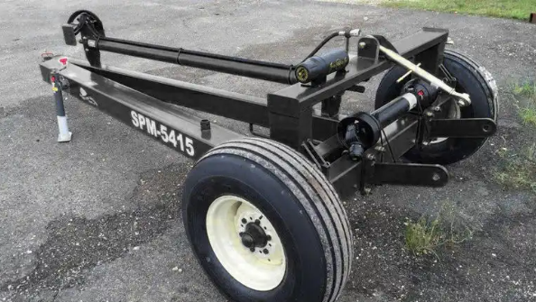

Several ways to front mount a hitch, or just keep working it as you have been a short trailer can be a pain in the butt.

Yeah you have no hope of backing up a very short trailer. It will jackknife in an instant. The others have the right idea of using a hitch on the bucket. There are many clamp-on ones out there for sale if you prefer to buy rather than build. For example:
I bought a similar one at Northern Tool.
