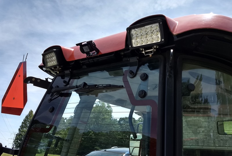

Added a camera up front and one on the back.
1080p resolution on a 2mp camera

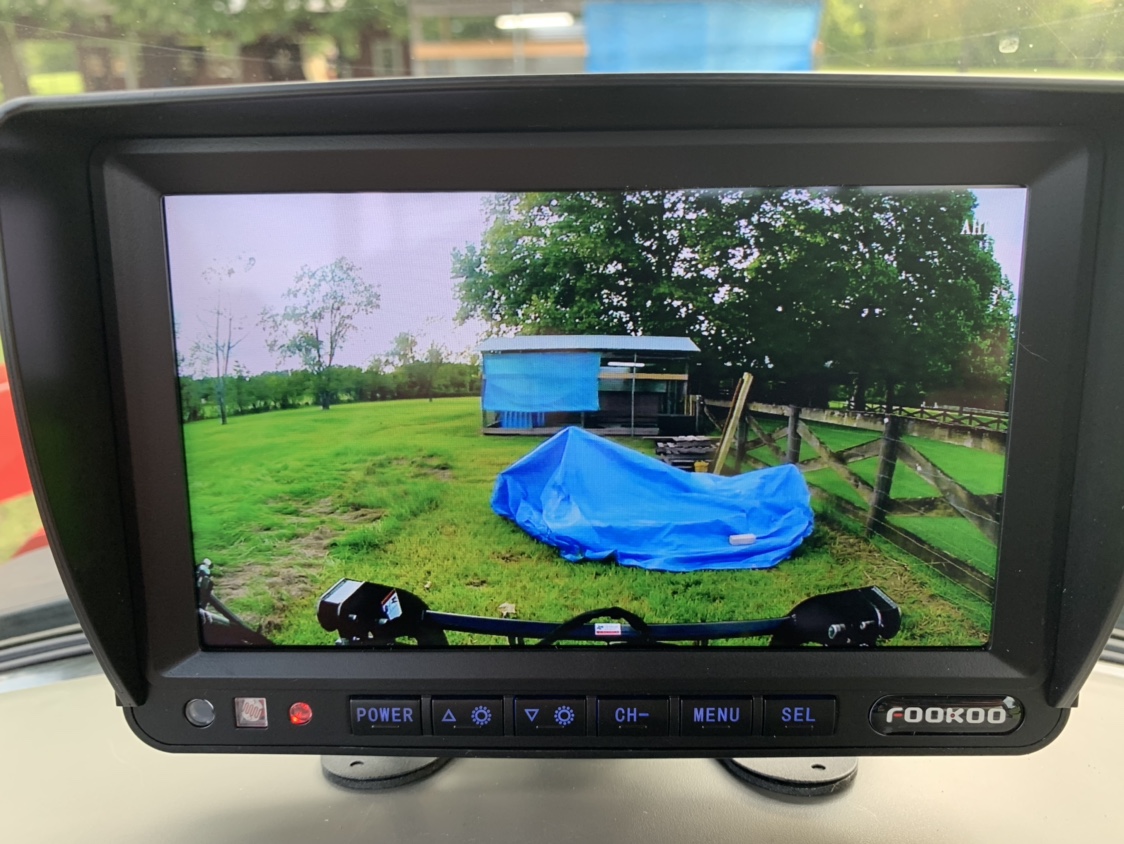

And yeah it’s lazy. I could easily turn around and look. But it has a little cool factor and what the heck, it’s my tractor.

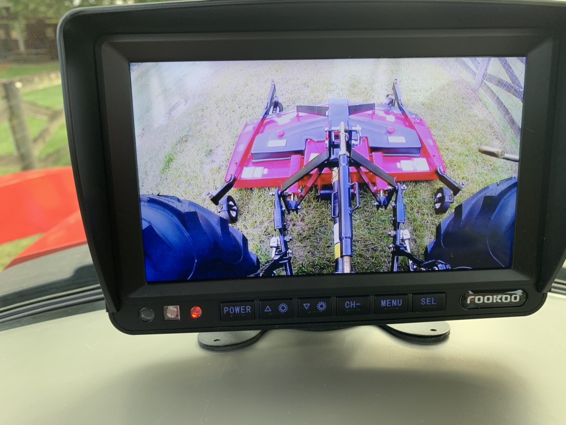

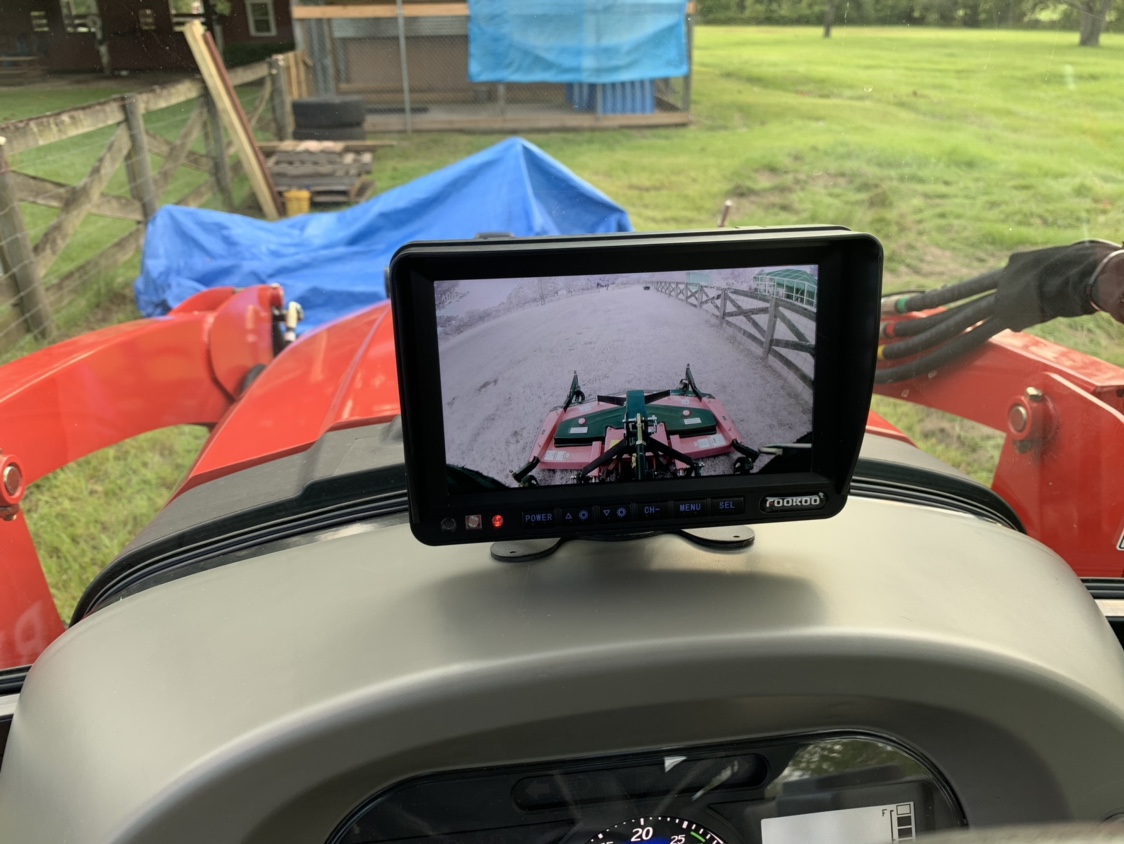

No, its not lazy. I couldn't see my pallet fork tips when they are right off the ground and level. I can now.
I can also swivel my rear one and keep an eye on haybine and baler without breaking my neck all day! Last week I used the rear one to watch my flail mower while trimming the side ditch for alignment.

I bought this....
Fookoo Ⅱ HD Backup Camera System Kit,7''1080P Reversing Monitor+IP69 Waterproof Rear View Camera,Sharp CCD Chip, 100% Not Wash Up,Truck/Semi-Trailer/Box Truck/RV (FHD2-Wired) https://www.amazon.com/dp/B07JQC51NB/ref=cm_sw_r_cp_api_i_vyypDbJ3HS7DG
The company has been great about service. Yes it is an expensive setup. But they are sending a replacement camera at no cost and expectation of a return for one of the cameras that is having some interference.
I used magnets to mount the camera on the back and front. This way I can move it as I want to.
The wiring was pretty straight forward, zip tie it out of the way and ran it through a rubber grommet in the floor. I tied it into the power on one of the fuses.
