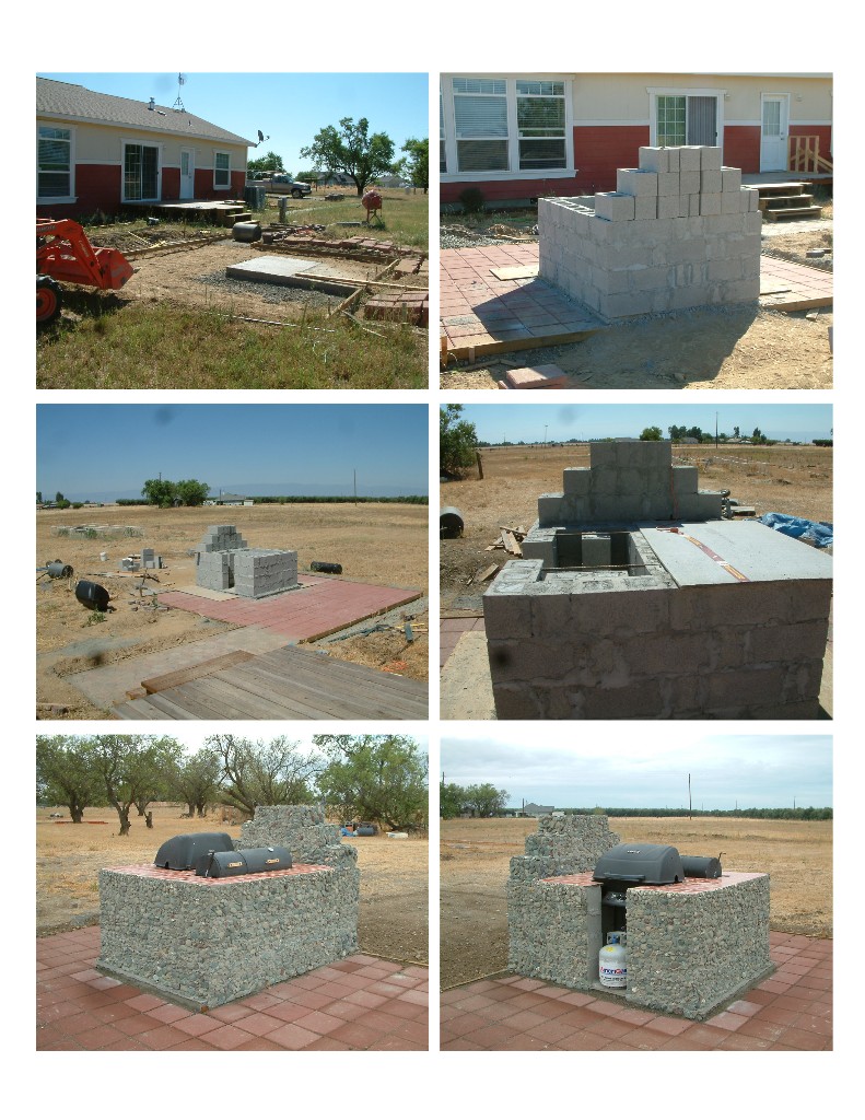

Installed the gas grill and the smoker in the BBQ pit yesterday.
Will give the grill a test run this weekend if the rain stops (first rain since May).

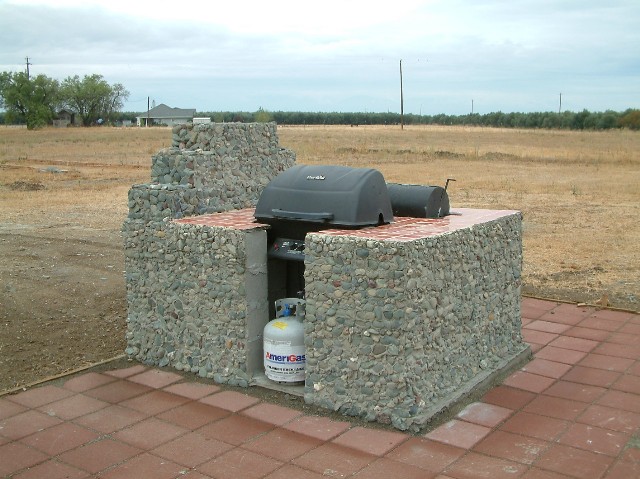

The stone facing is just drain rock left over from installing the septic system leach field last year. Just used thinset mortar mixed with enough water to make it really sticky.
Don't know how that facing will weather, but winters are pretty mild up here in the North Valley (no freezing/thawing problems).
I originally planned to used that cultured stone stuff (concrete cast in moulds and colored to look like stone). It would have been easier and quicker that way, but a lot more expensive. The masonry pit has about 120 sq ft of surface area and that cultured stone stuff is about $4-5 per square foot. I figure I spent about $50 in materials doing it with single stones. It took about 5 days to install the facing working at my ususal slow pace. But I'm retired, so time wasn't a problem.

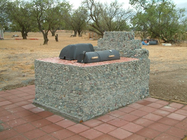

Sorry 'bout that. Here're the big ones. Enjoy.

I'll tell ya flusher, that is one nice looking BBQ and the entire patio area looks great. Great job man. I like the drain rock finish on the BBQ, it's unique.
