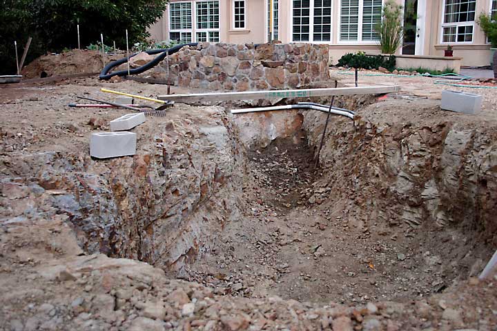

Digging a 10' x 15' x 6' deep hole into granite bedrock and need to smooth up the sides so I can use it for a koi pond. The sides are jagged where the jackhammer would break off chucks as I dug. I was going to use a stucco base coat but I think the gaps are too large even if I use a wire mesh. Any ideas on how I could get the sides smooth?
Ultimately I want a bowl shaped bottom with the sides nearly vertical. Once I have the sides smooth, I plan on sealing it with fiberglass cloth or a polyurea coating, so this smoothing coat doesn't have to be waterproof.

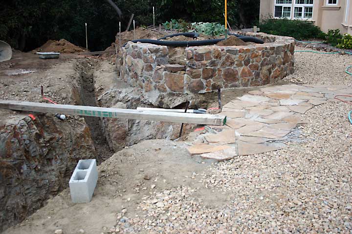

The first photo shows an overview. The pond itself will have an 18" stone wall (like in photo 2) around its edge to keep leaves and groundwater from entering the pond. The water level will be 10" above ground. A foot bridge will cross about where the 4x12 is now laying.
The 2nd photo shows the 30" x 100' curved stone wall I'm building around the "stream" that goes from the filters to the pond (had to do something with all that rock). Water will flow along a 35 ft. stream and spill into the pond through an opening/waterfall. The trench goes back to the filter pit and will be filled in after the pipes are laid.

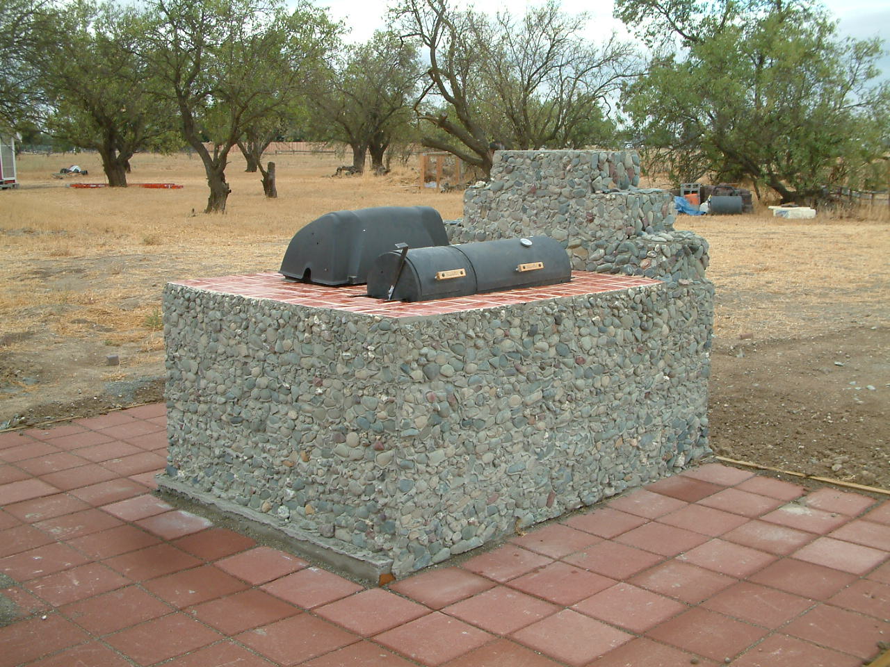

Wouldn't used concrete to fill the crevices. I'd use parging consisting mortar mix with the minimum amount of water to make it thick and sticky. That's how I attached the stone facing to my concrete block barbecue pit last summer. Then use the rubber liner. The weight of the water will keep the mortar from moving any.
I'm planning to start construction on a 5'x10'x5' deep formal-type koi pond in March 07. I only have gravely soil to contend with so I'll dig a 2' deep hole 3'x8' and leave a 1' ledge around the perimeter. Then I'll build a 3' H concrete block wall and parge it with sticky mortar. Plan to use a rubber liner. May use the same facing as the barbecue pit or might spend the money on some type of cultured stone facing.
