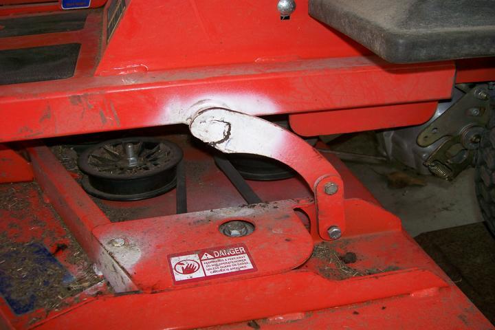

Hello Piperflyer,
I have one a 26 hp 48" cut zt. I have had problems but still think its a little beaut.
After 4 hrs a weld on r/h side lift let go. The agent 500ks away paid for a engineering shop to weld it up.
Later the other side let go, so I got a local farmer to weld it up.
Then the first one let go again, so I fitted a new shaft with reinforced arms and fixed with roll pins, no problems since. There is no provision to bush these shafts when they wear as they are welded to the frame so greasing is important. They use silly knock in grease nipples that point at the cutting deck with little room (and they fall out) so I replaced them also.
My deck is actually 3/16" not 1/4" but still the best deck I've seen.
They were better value ( to my thinking ) by a country mile than anything else I could find.
The addional H.P. will never go astray.
Hope this helps.

I thought BB is Orange... yours looks different than mine. Even the the lift on your pics. Maybe an older model? :confused3:
