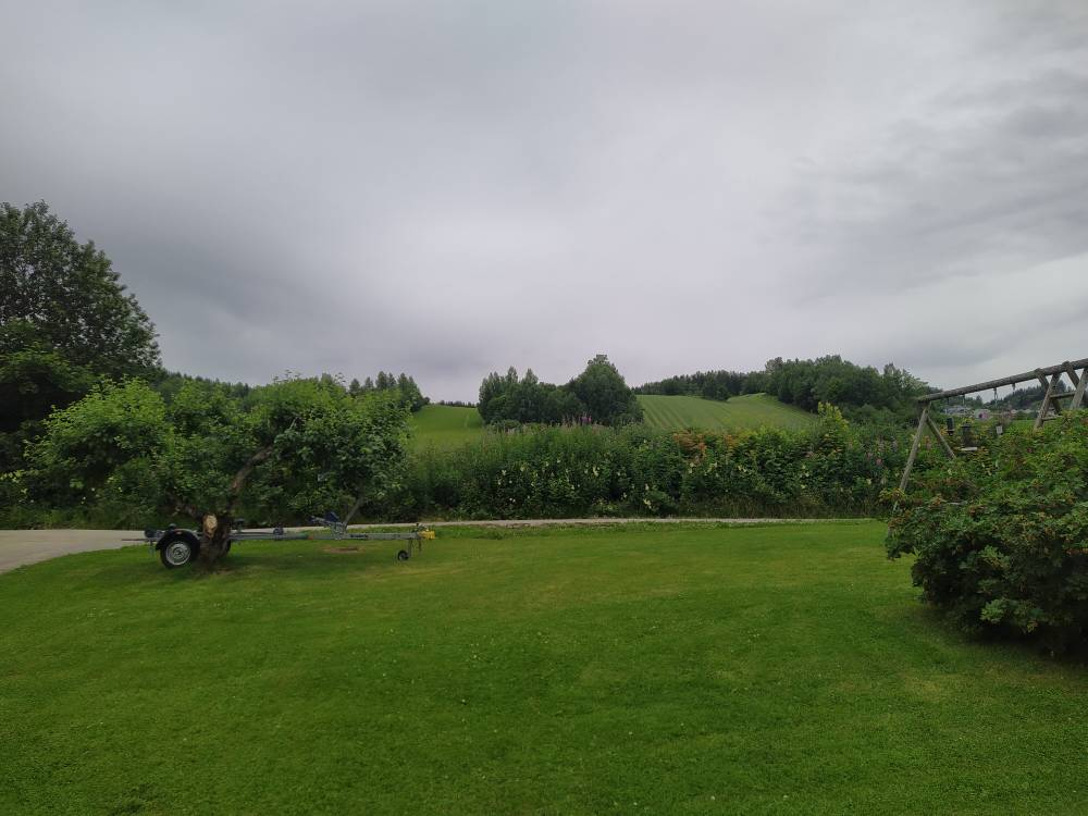

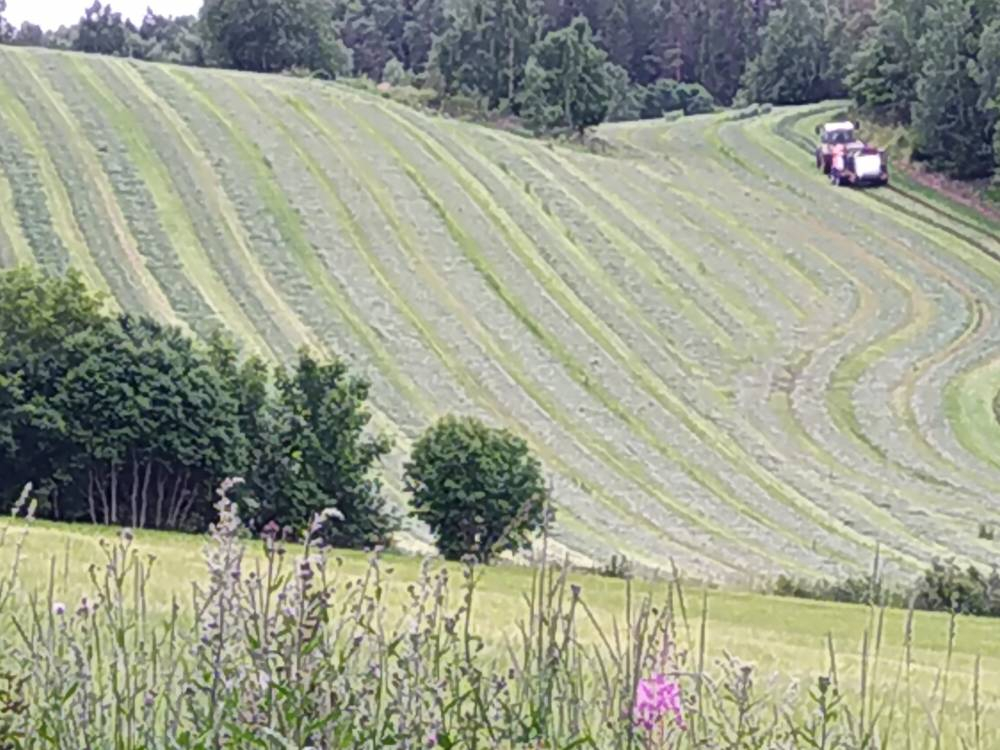

Just a pic of a field close to my home

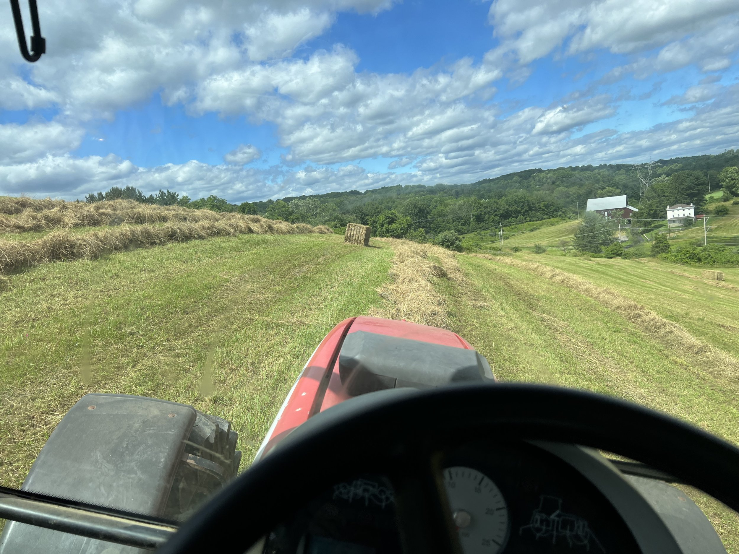

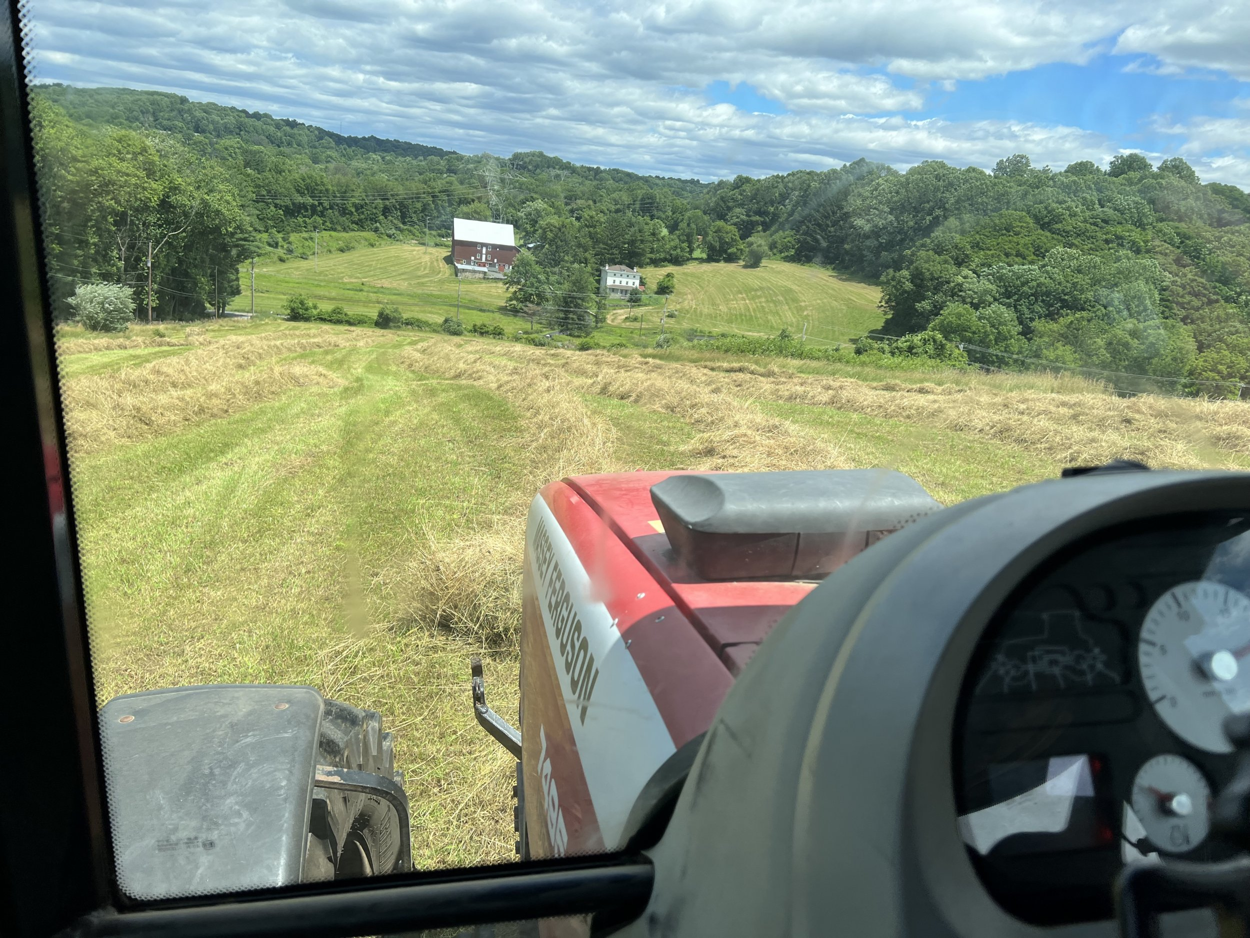

We do some crazy steep stuff. Other guys don’t have the balz to do it.
At the bottom of this steep hill is a 10’ drop off into a 2 lane road. There’s no flat area to make a headland or turn around.
Below: This hill has you hanging on pretty tight. Feels like the baler could tip and “gator roll” the tractor and me with it.
   / Bailing on steep fields #7
Hay dude
Are those big square balers as top heavy as they look? I have only been up close to one and it sure looked like center of gravity would be way above the axles.
