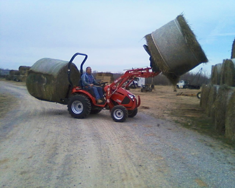

   / Bale Spear #6
This is my favorite pic for round bale moving!

This isn't a round bale but a 1200lb square bale on the back of a 26HP sub compact.
