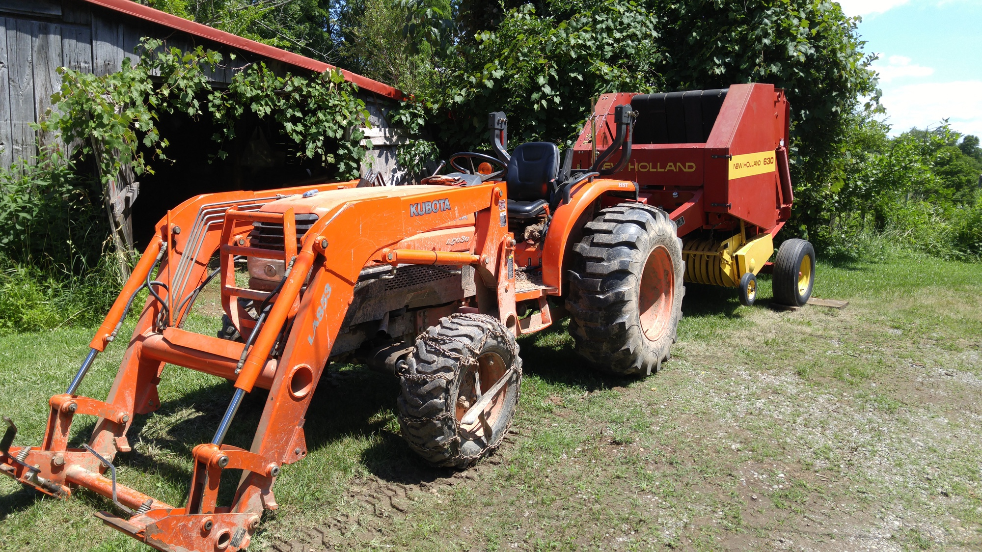

I haven't been involved with baling hay since I was a kid. I know I'm not really going to make any money baling hay, and it's probably going to take a couple years to even break even. But I'm tired of depending on someone else and having to buy hay. I will be baling less than 100 acres, unless I lease some pasture. Most of the hay I will be using for my cows and horses, and possibly sell a small amount to a couple neighbors.
I'm looking at used equipment. I have to stay under 15k total on equipment. I'd like to stay under10k, but will go a little more.
I'm looking for a 4x5 or 4x6 baler. Been looking at vermeer rebel's 5410, 5420, 504m, etc. Also looking at new holland br750, 658, br740, etc. I'm also open to other brands. Twine only is not a deal breaker. I would love to have net wrap, but prices are definitely better for the twine only models. It seems that I can get a better condition and newer baler for a lot better price than one with net. To get one with net I'll have to get one that has a lot more bales through it, or a lot older. I really prefer one with a monitor too.
For a cutter I've been looking at a few sickle mowers that's still useable. I know where a vicon disc mower is for 3k too, and it's in good shape. Also I've seen a few haybine's for good prices and the rubber still looks good on the rollers.
My thinking is buy a cheap rake for the first couple years. I've found a couple older bar rakes for 1500 and less. Also seen a few wheel rakes in that price range that's still useable.
What would you recommend for a baler? To start off I'll be using my tractor with 53 pto hp. Ground is flat and I know I'll be a little slower going with my current tractor. But I will be getting a bigger tractor in the future.
It won't be easy to get usable hay equipment with a budget of $15k for a round baler, cutter, and rake.
A 4x5 or 4x6 round baler that's not broken or completely worn out generally starts at $15k around here, although you might get one for closer to $10k if it's a twine only model as nearly everybody around here net wraps so they can store bales outside. 53 PTO HP and a 4500 pound dry weight tractor might do okay enough if you are doing dry hay on flat ground, back off on the bale size and density if needed. Smallest tractor I've ever run in front of a round baler was about 65 PTO HP and it did fine.

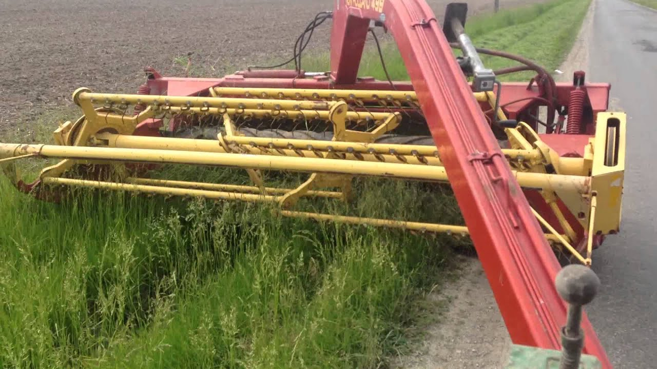

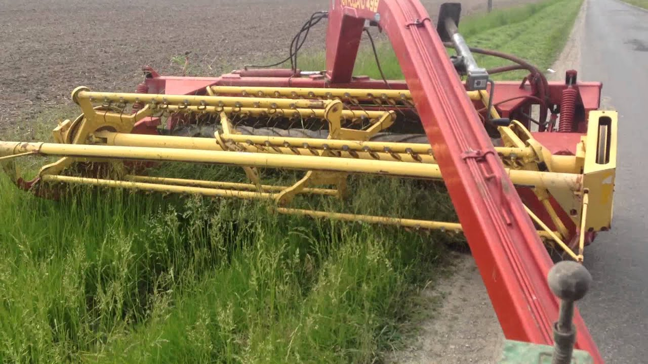

If you must do a haybine, check out a NH499 center pivot. They are cheap, plentiful, highly regarded and easy to get parts for.
Still better to get even a small old discbine, though.

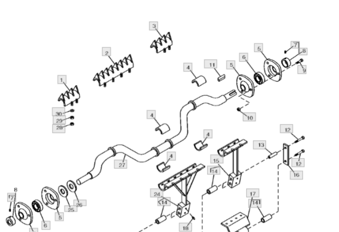

Absolutely sorriest baler I ever owned was a JD 466 with Mega-wide pickup attachment that I purchased NEW. After several 1000 bales the crankshaft under pickup attachment got worn enough that it was impossible to keep feeder fingers in place. Luckily I never found lost feeder fingers imbedded in a rear tractor tire. I think later style much improved Mega-wide pickup attachment from 467 up could be installed on a 466.
/ baler recommendations #33
466 Mega-wide pickup baler with middle set of feeder fingers(item 2) AWOL when baling grass hay but needs all fingers when baling Sudan/Sudex/Johnsongrass
