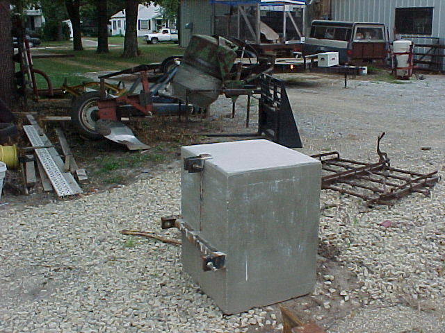

Here is a pic of one I built for my 4300

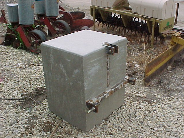

If I remember right. 26" wide 24" deep and 36" tall. should be 1600 to 1700 lbs with the steel
DDT
