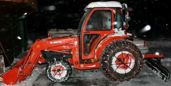

Tablespoon - Don't be afraid - You know its coming. Cold, Dark, Wet, Windy.
