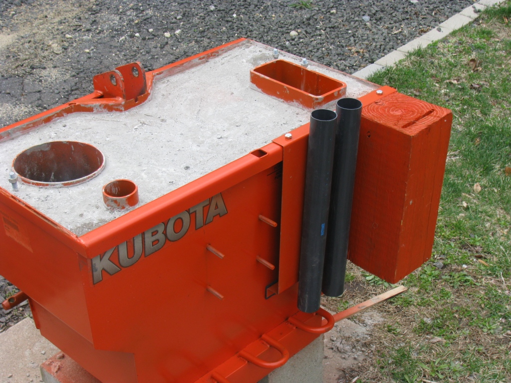

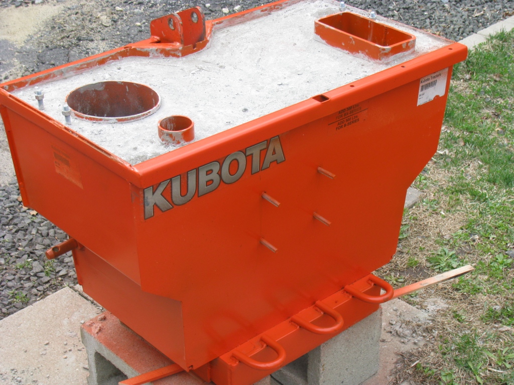

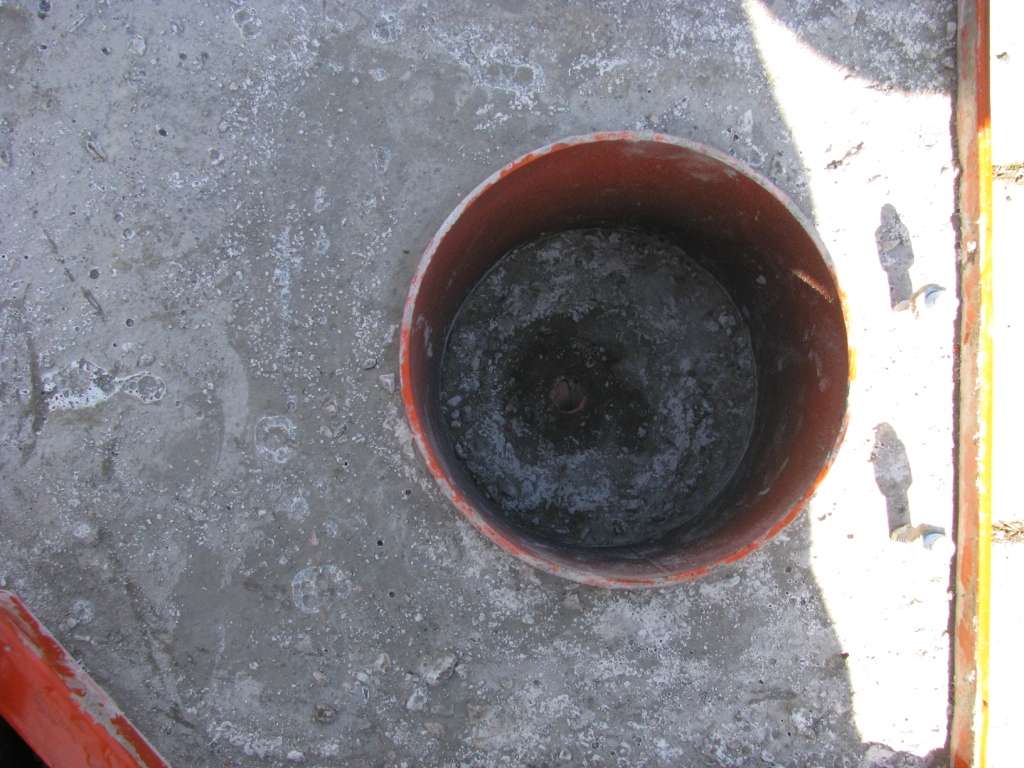

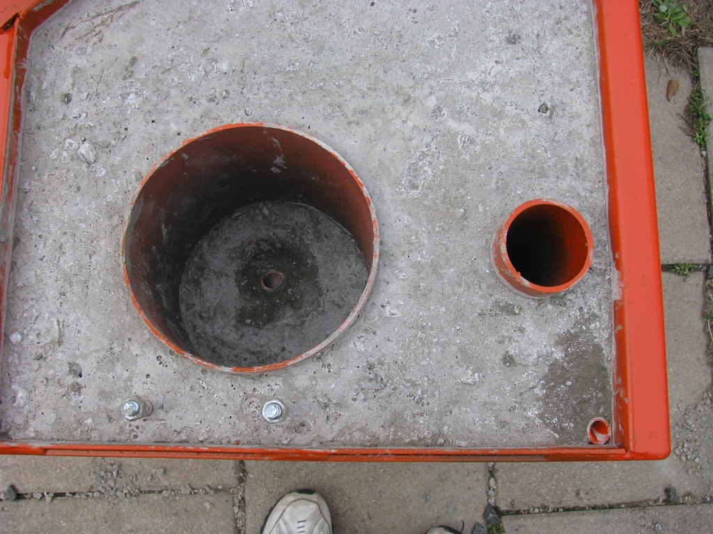

Here it is.
Around 480lbs of concrete and pieces of steel tubing for carrying items. The rectangular one is for towing chains, the large shallow circle is for gloves and ratchet straps etc.. and the small long tube is for shovels or rakes. I also embedded u-bolts for future use.

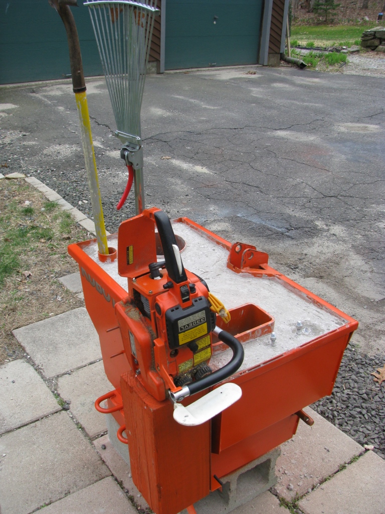

This other piece bolts on. It can hold more shovels, rakes and a chainsaw.

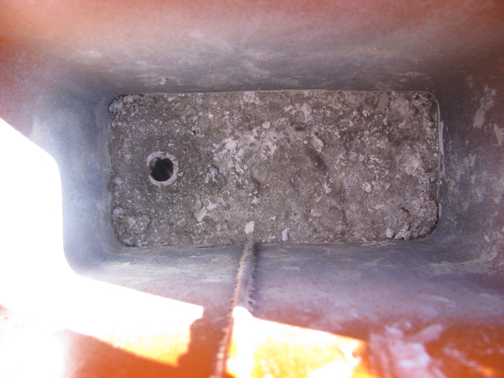

I used pex tubing and sloped the concrete to create drainage holes.

   / Ballast Box Question #6
Your creation can only be categorized as ART.
   / Ballast Box Question #7
^^^^^ I like your ballast box a lot. Well thought out well executed and beautifully finished.
