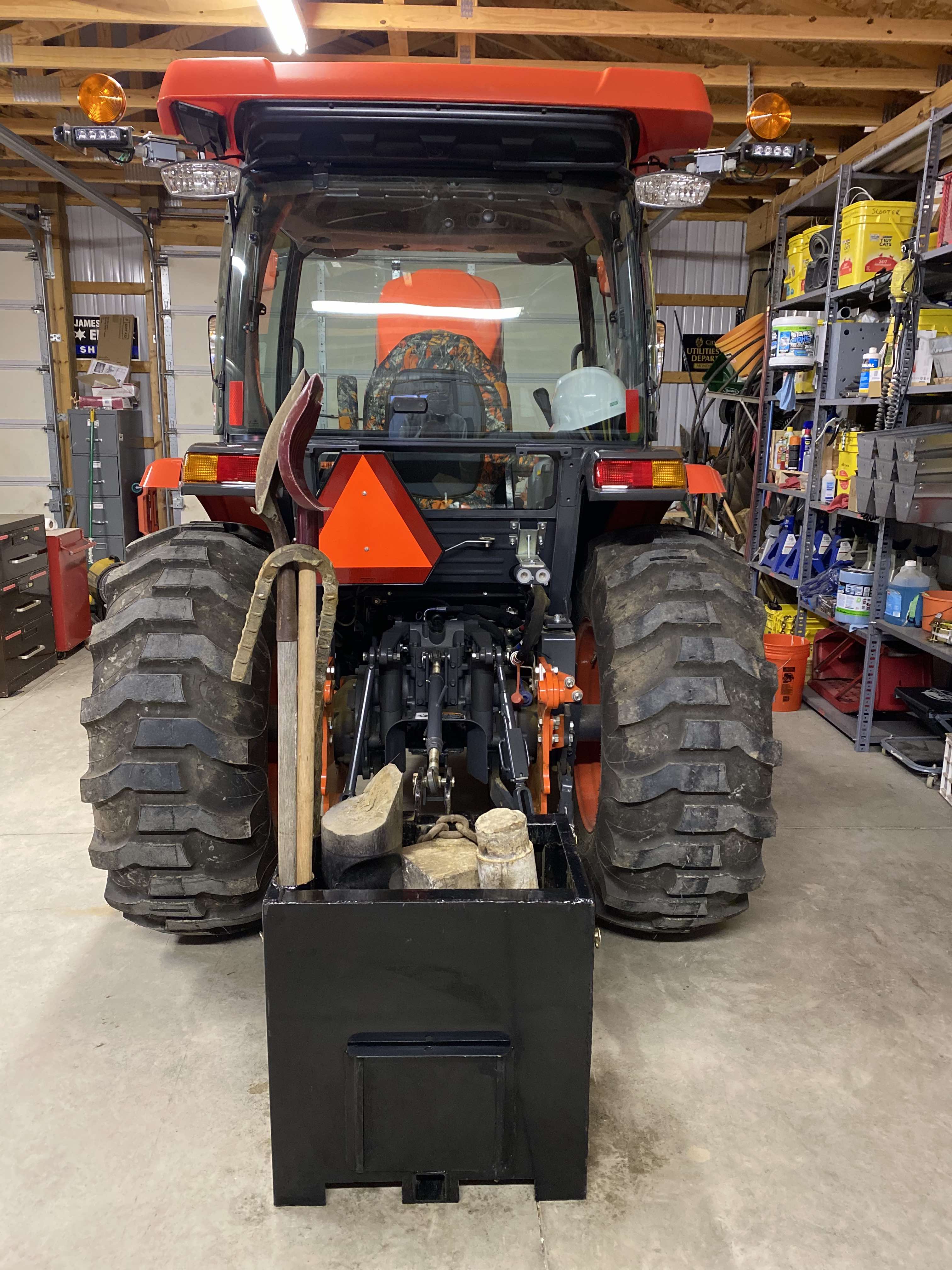

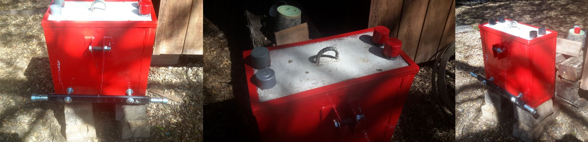

About 2x2x1 ft, weighs in about 600 pounds (cat 1 hitch) ..... NO problem at all with tubular tool holder only wish is I made better arrangement to attach milk crate for holding small misc. items (like chains and ropes and "stuff").... Only cost involved was cross draw bar and about 3 bags of sackcrete... All other materials were scrounged....
Also later added an angle iron low down on rear so I can add trailer ball or tow ring for what ever you need trail ball and tow ring for.... Some day I might do better picture spread....
Spray can caps keep leaves and crap out of tubes...

Very nice DL :)
How is the cross bar attached? Did u make some sort of rebar frame inside & weld to it? I look at you lifting hook and can't help but think a 'tree' right next to it about 2-3' tall with some kind of fasteners would answer all I (think) I need. I'd be able to hang stuff like chains or even a chainsaw.
I actually have been thinking about doing this but the last couple of Cat 1 cross bars I looked into had not so great reviews (tho they did have 2x2 receptacles). One said the frame wasn't that strong and another complained that the pins were undersized and weak. . . Which one did u end up with?

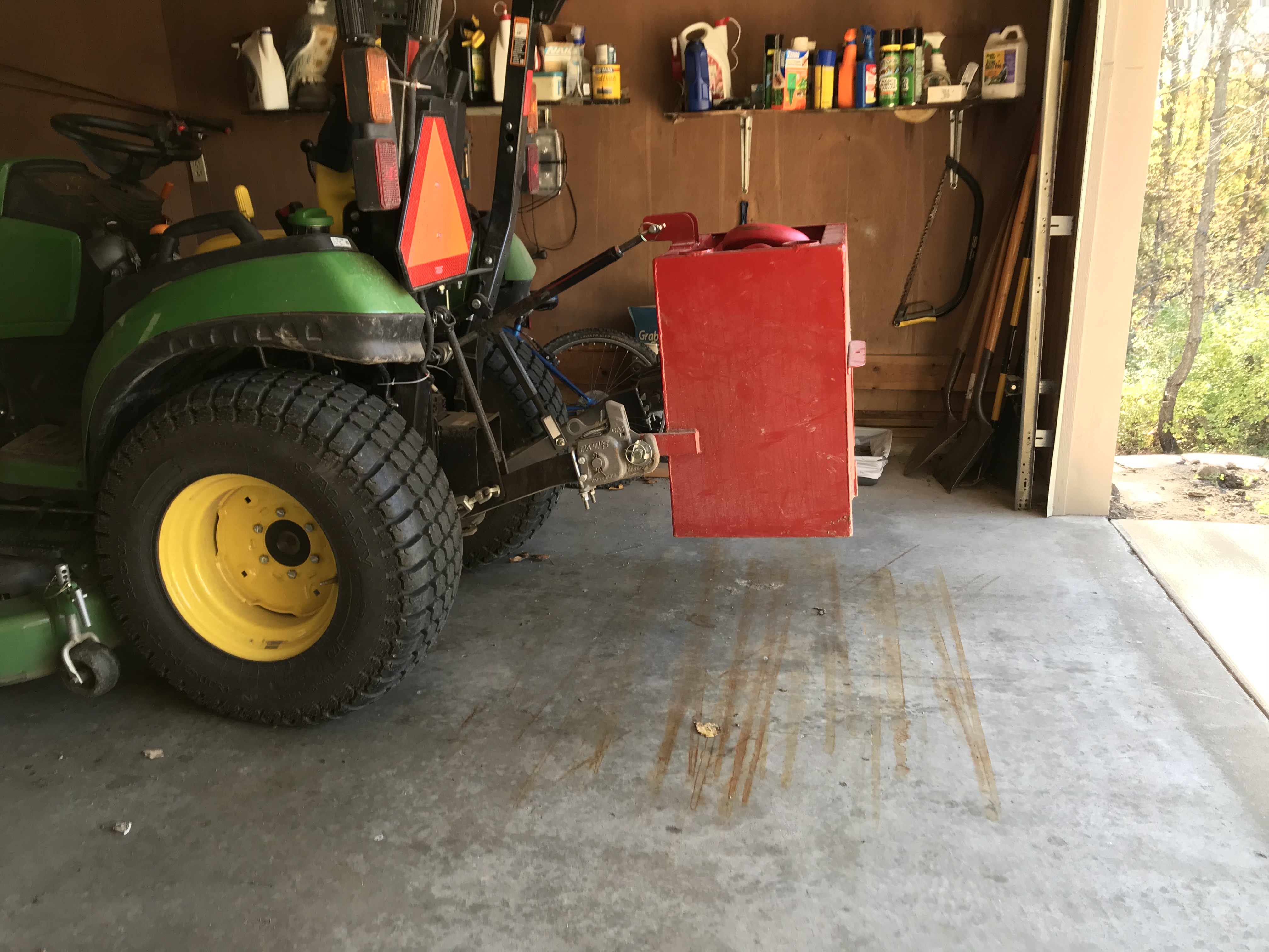

Here is a pic of mine, it was about the cheapest I could find on Amazon. It has a couple of round pockets in the corner in two places to hold rake or shovel handles. The only problem is if my ROPS is halfway folded the rake or shovel will hit it.

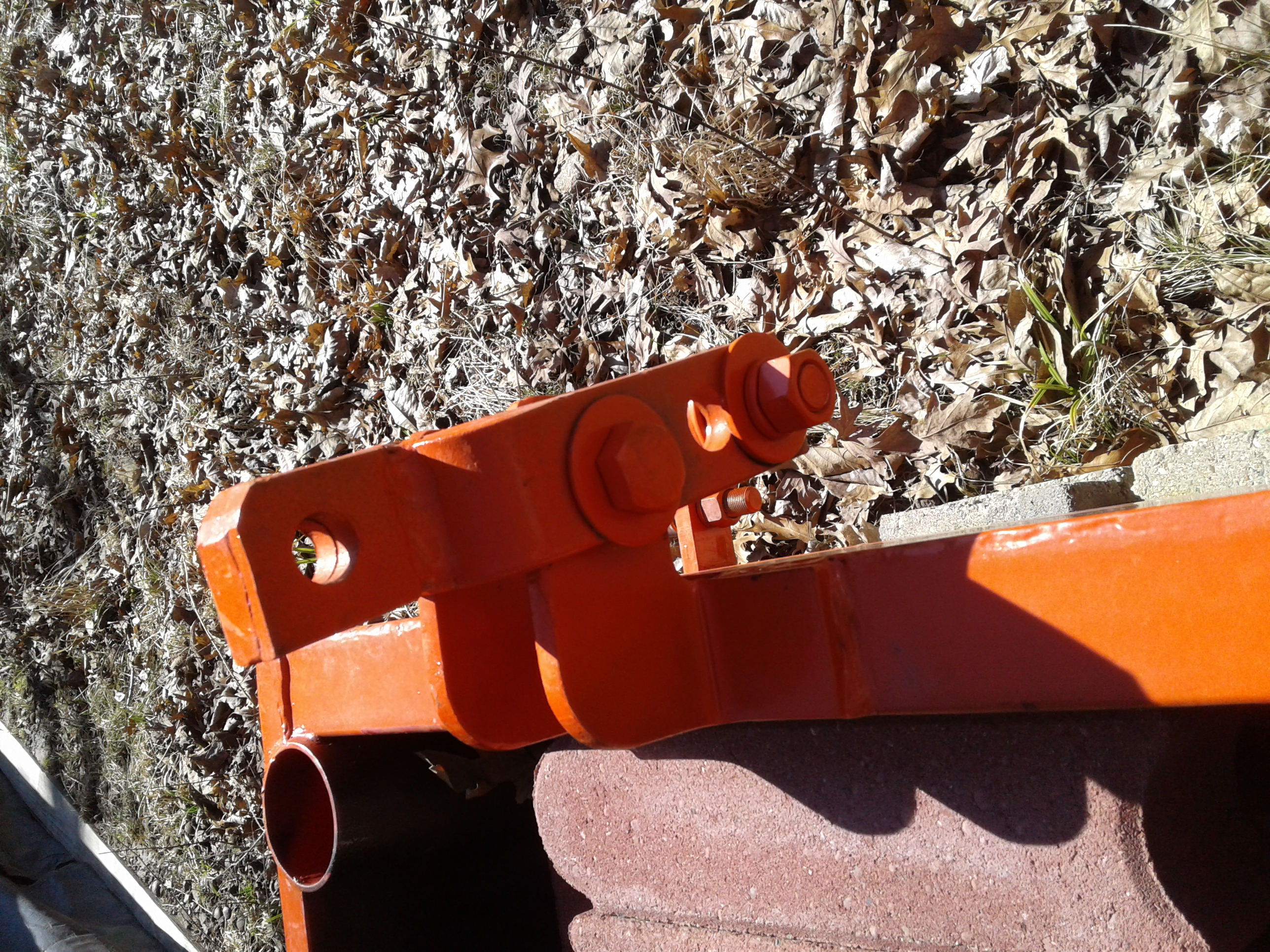

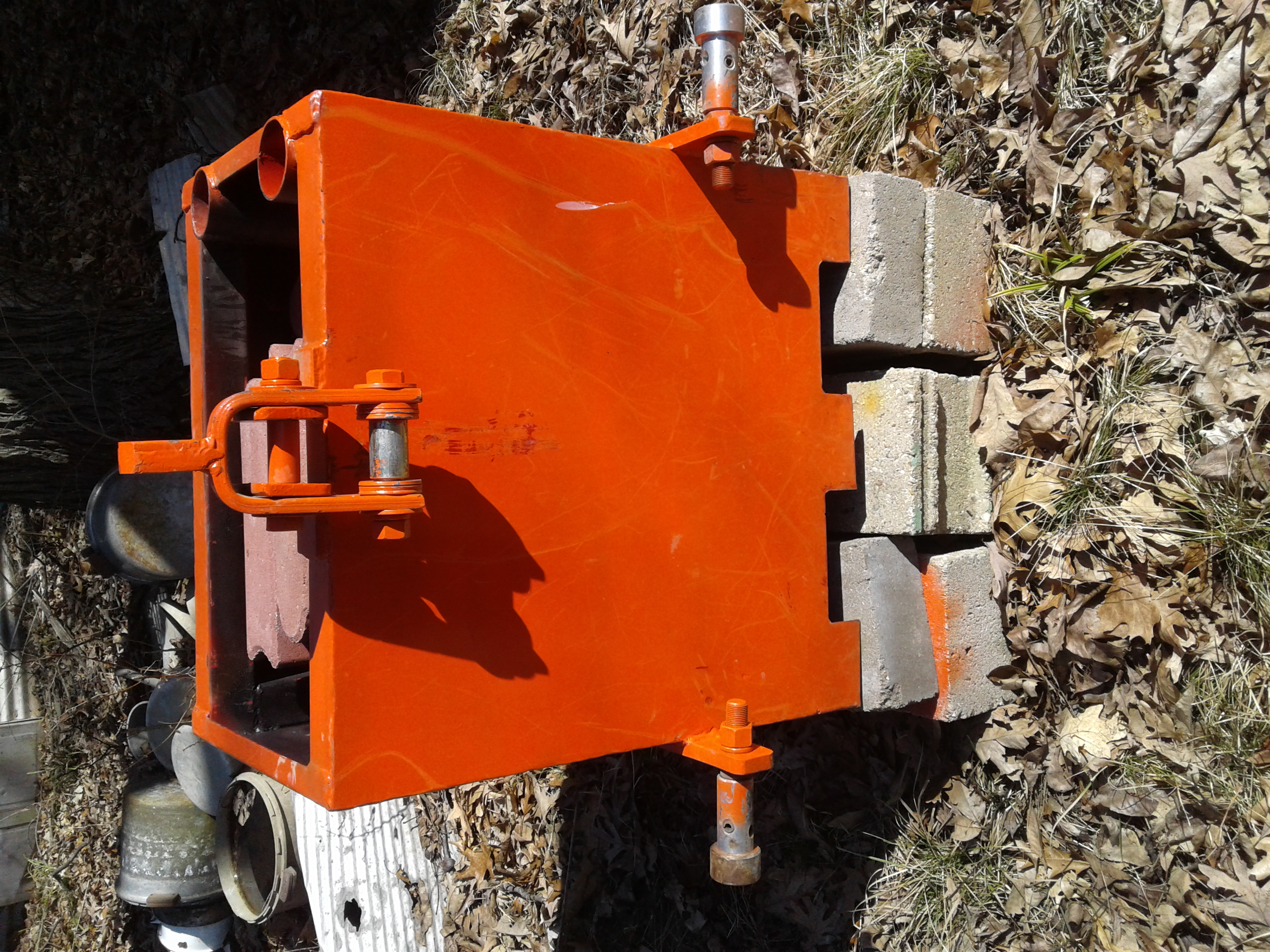

Bought titan box off amazon, top link too high and further behind bottom pins. Top link needed lowered and moved forward. After modding mine saw on titan website a 3pt box and QH compatible box for same$

Cross bar is attached by using a section of 1 inch steel tube going through box and use 3/4 inch threaded rod (all thread).... It was done this way to have the option of doing something different in future also not shone is angle iron attached to back of box with about half dozed holes for various ball hitch and shackles....... The rebar loop in attached internally to the tubes that go through the box so it remains in place even if concrete fails, I chose to put it in to have a lifting point in case it ever needed to be moved (not hooked to 3PH) or if it fell over and I needed to rights it...
Cat I bar is generic $39.99 TSC bar... Didn't give much though to how stout it is... If it bends, I will just bend it back...
Dale
