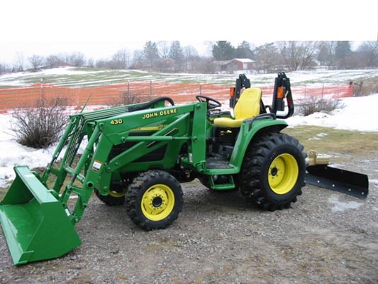

Well the weather finally looks like it going to turn for the better. Time to get outdoors and move something besides snow. I want to build a ballast box for my JD4310 using some of the steel from an old fuel oil tank. The tanks width of 27" works for the spacing between the lift arms, but what are the other dimensions on your ballast boxes for height and thickness. A newby's inquiring mind would like to know. Thanks for all the prior information and keep up the great ideas.

Went out this morning and got the dimensions. Someone turned the heat off again. 20 degrees. /forums/images/graemlins/blush.gif
Height = 22 3/8"
Width = 24 3/8" This is the 27" width of your tank.
Depth = 16"
Lower link pin height from bottom = 11 1/8"
Top Link pin C/L height = 24 3/8"
Pin C/L back from tractor side = 1 3/4"
Pins are mounted to a 3/8" plate welded to side of box.
