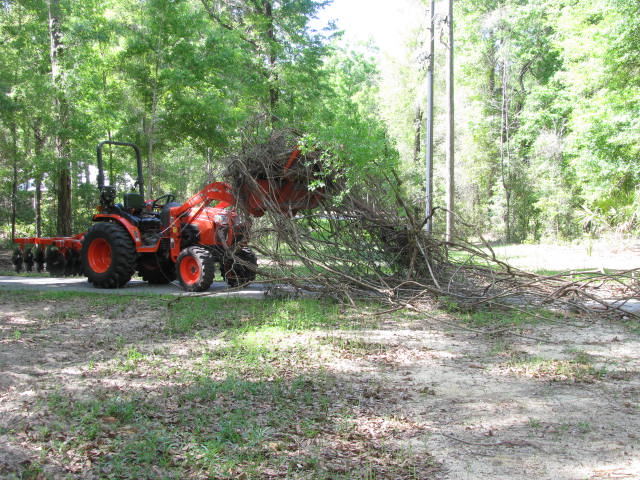

My Kubota B3300SU weighs 1,900 pounds.
For ballast I attach either my Howse Disc Harrow, 587 pounds (31% of tractor weight)
(or)
Bush Hog (brand) Rollover Box Blade, 630 pounds (33% of tractor weight)
Both give good balance when lifting a max load with the FEL. Rear ballast also takes a great deal of strain off the front axle.
Tractordata.com says your BX1850 weighs 1,255 pounds (loader?) so 300 - 350 pounds (+/-) ballast should be good.
Consider buying a 3-Pt. CARRYALL from TSC or King Kutter. Cheap and strong. Add ballast weight incrementally.

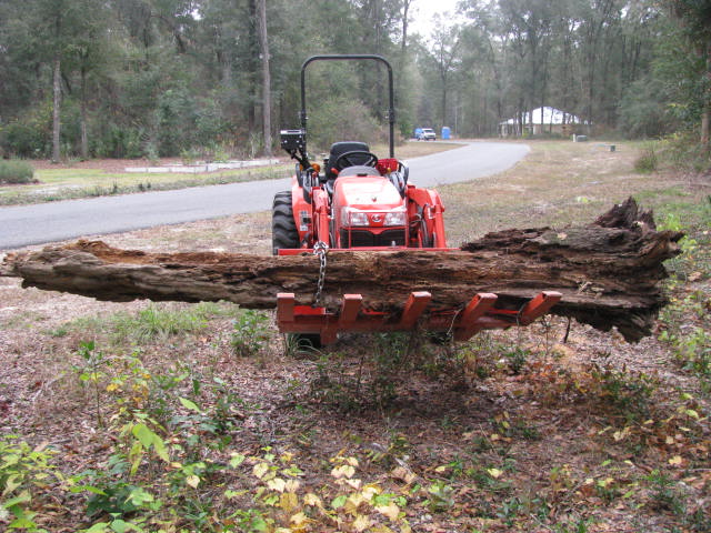

My loader lift is about 1400 lbs, and the manual says to have 1100 on the 3pt. I don't have that much, I have between 750 and 800 depending on how many log chains I am carrying. But I also have filled rear tires. a little more 3pt weight would not probably hurt. But it is pretty hard for me to lift the rears. Maybe could lift one on a slope or something if you hooked on the opposite corner of the bucket. You can always do something stupid, but my rig is pretty well planted.

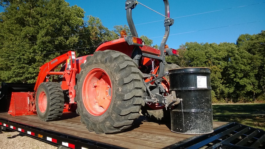

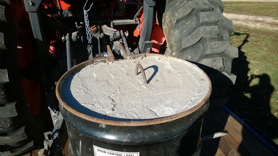

/ Ballast box weight #19
Here is the ballast box I made for my Mx5100, cost $25.00, turned the tractor into a new machine as far as what I could comfortably do with the front loader.
/ Ballast box weight #20
Truly, a thing of beauty in the REALIST SCHOOL OF ART.
