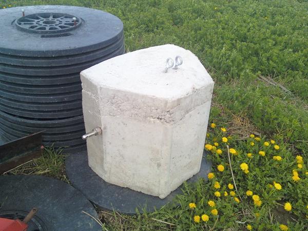

My manual states you need 800 lbs of counter weight for the loader to be used at it's max capacity. I have a 900 lb block of concrete that I made up that works great.
