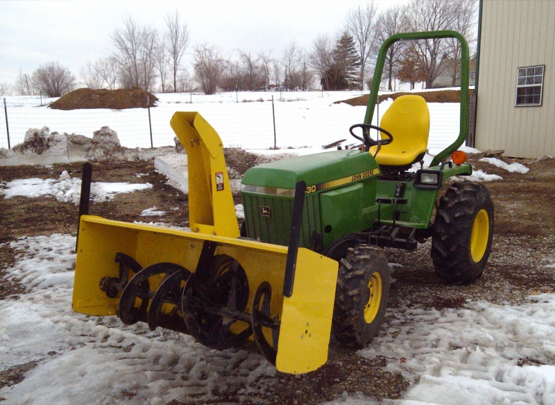

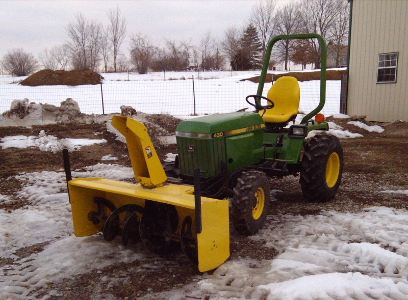

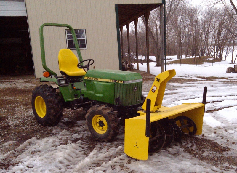

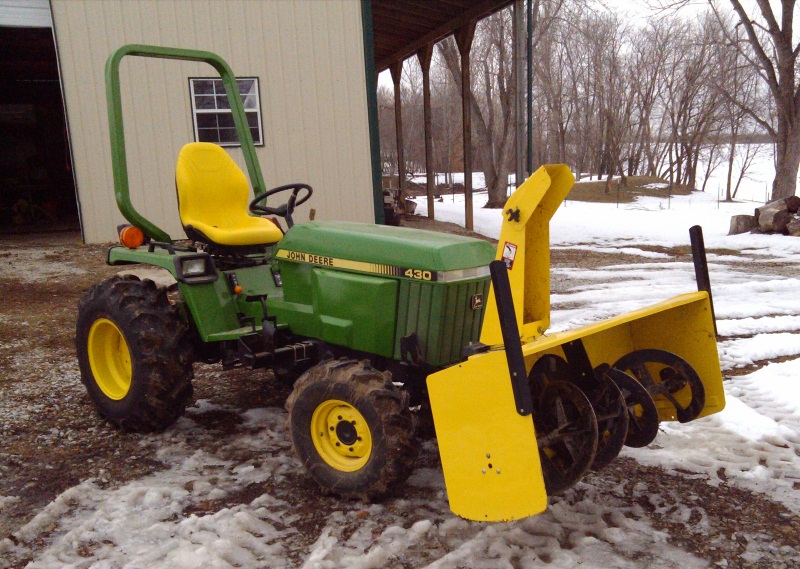

#9
Just what is a good deal? I believe the answer to that question is different for everyone. It depends on the condition of the equipment, the availability of the equipment in your area (number of units and frequency that they come up for sale), and the popularity of the equipment when it does come up for sale. I've seen pristine 59's for sale for $5000 (I would consider this unit pristine... extremely low hours), used but not beaten units for $2500 to $3500, and well used to beaten units from $1500 on down depending on condition... and sometimes, that is for the blower itself not including the quick hitch and driveshaft. The price for the quick hitch and driveshaft for my 955 from JD is ~$1300... used is considerably less but a rare find. Those are the going rates in my area... and stuff for 955's doesn't come up all that often.
Let's just say that I paid in the "well used to beaten" range for a pristine blower with the quick hitch and driveshaft... complete setup. For me, that was a honey of a deal. Here are a few pics of the 59 mounted on my "430" :laughing:
