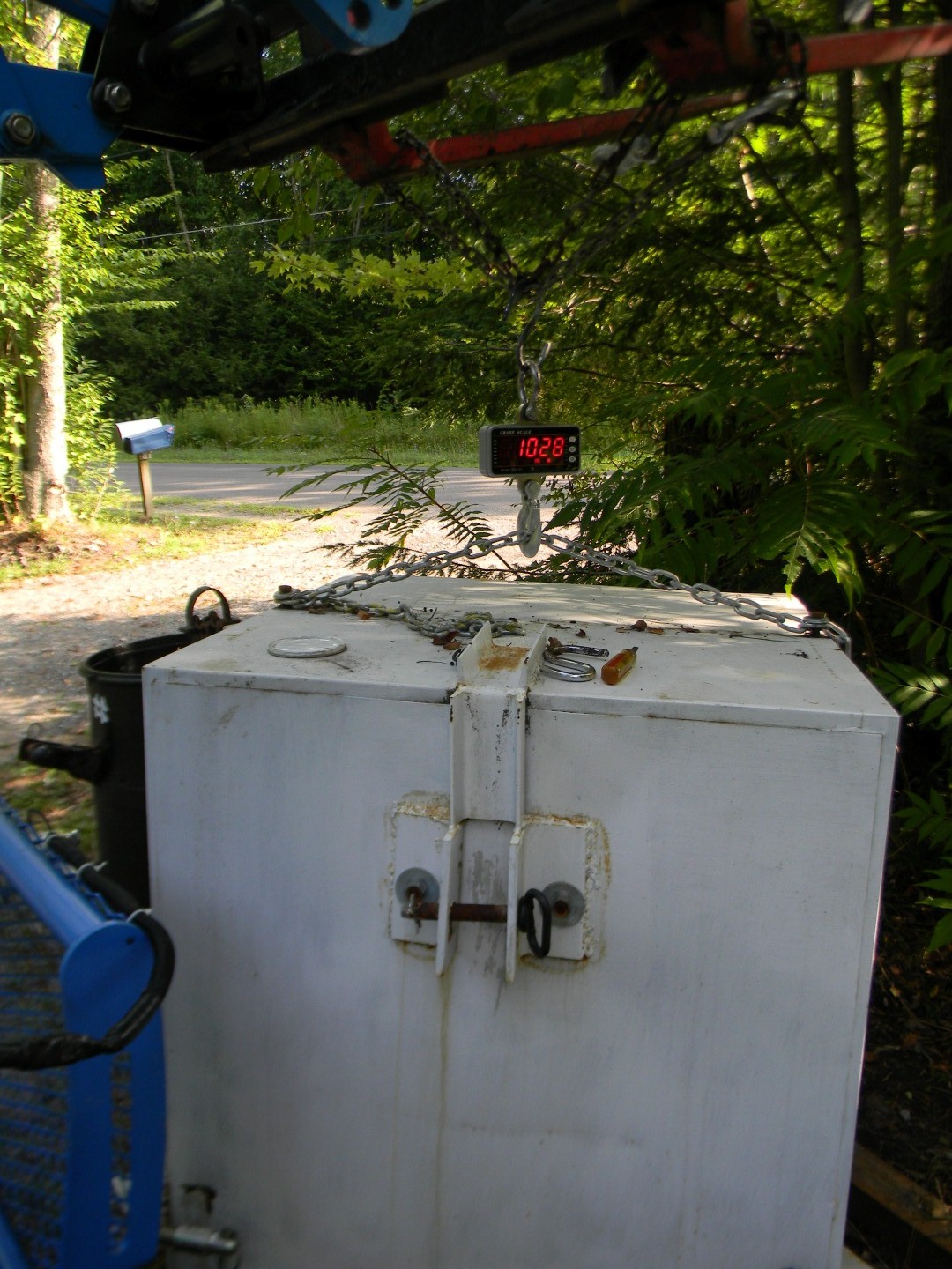

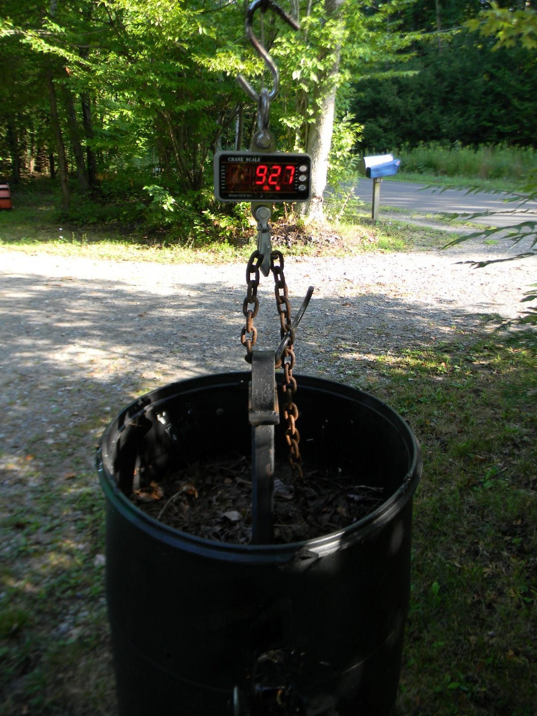

I run WW fluid in my rear tires. About 39 gallons in each fills them to 10/11 O'clock position. WW fluid is much cheaper than RV antifreeze or beet juice, just a little less weight per gallon. When I need more rear ballast I can put weight on the 3 pt. I have a couple to choose from and can add another 1000 or so. 55 gallon plastic barrel 3/4 full of ready mix and scrap steel or an old data records safe I made into a weight.
The safe weighs 1030 but I can open the door and add more weight inside if needed.
