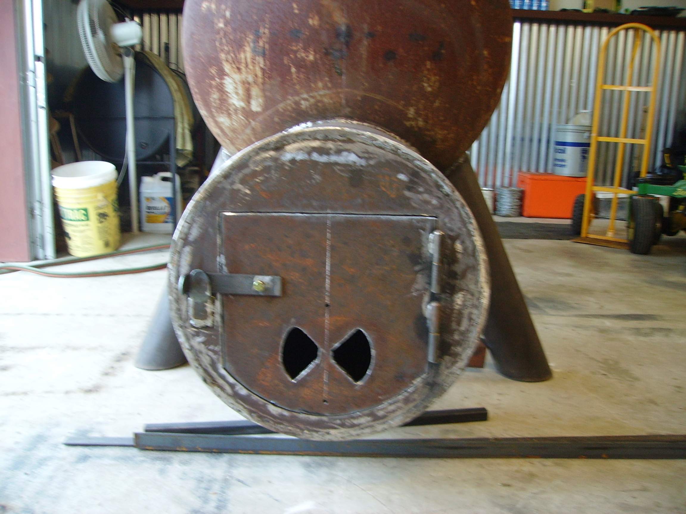

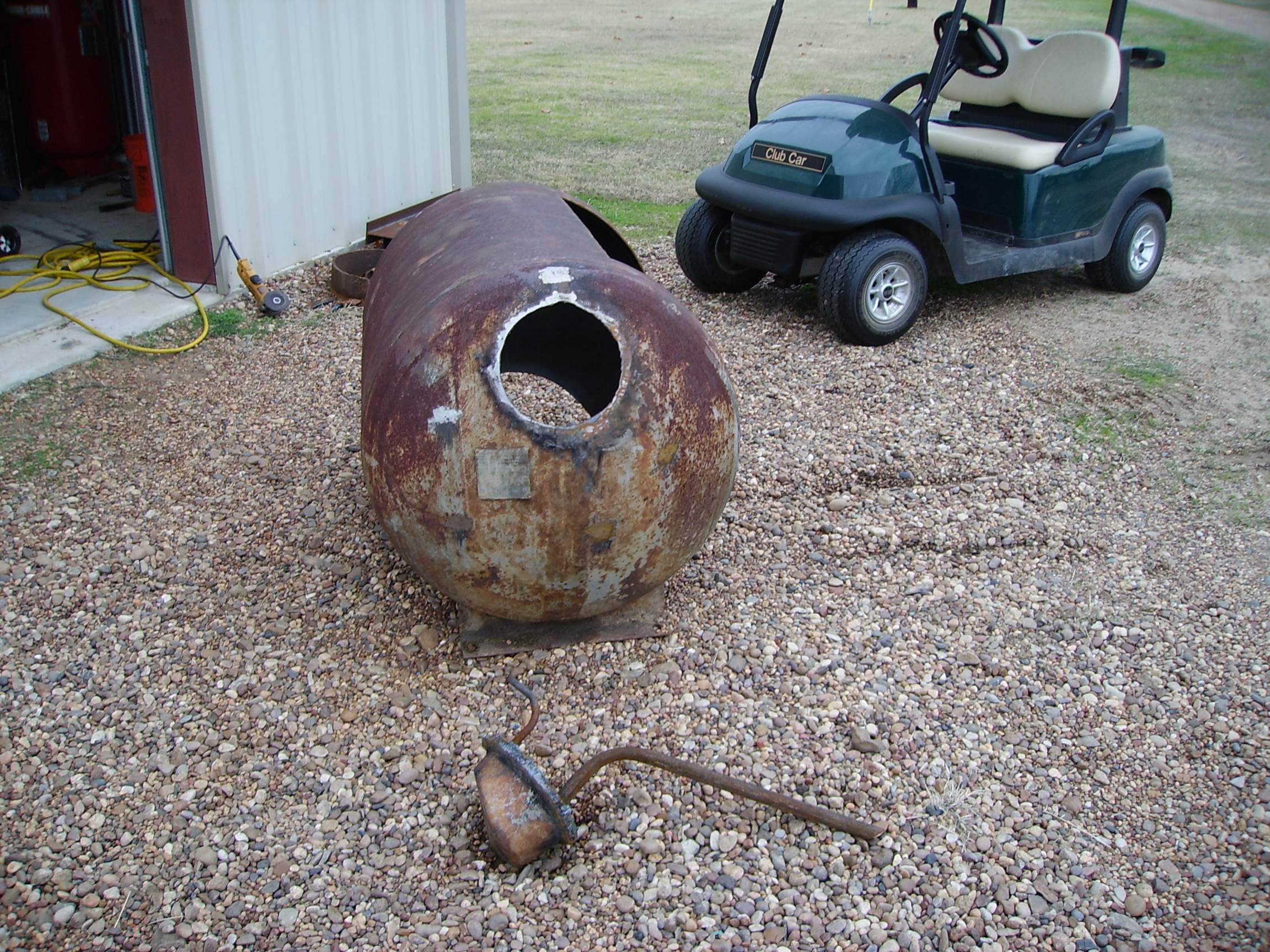

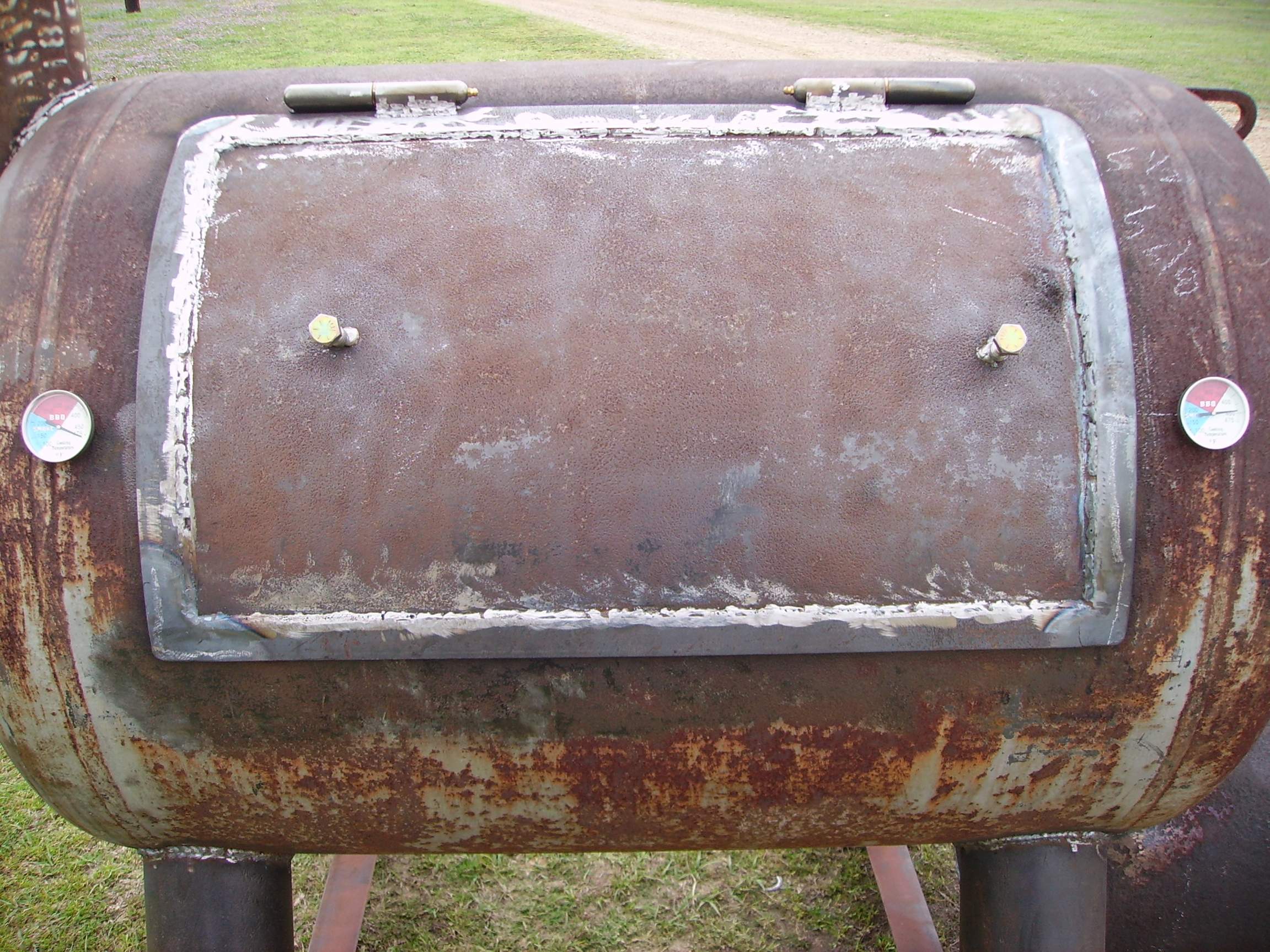

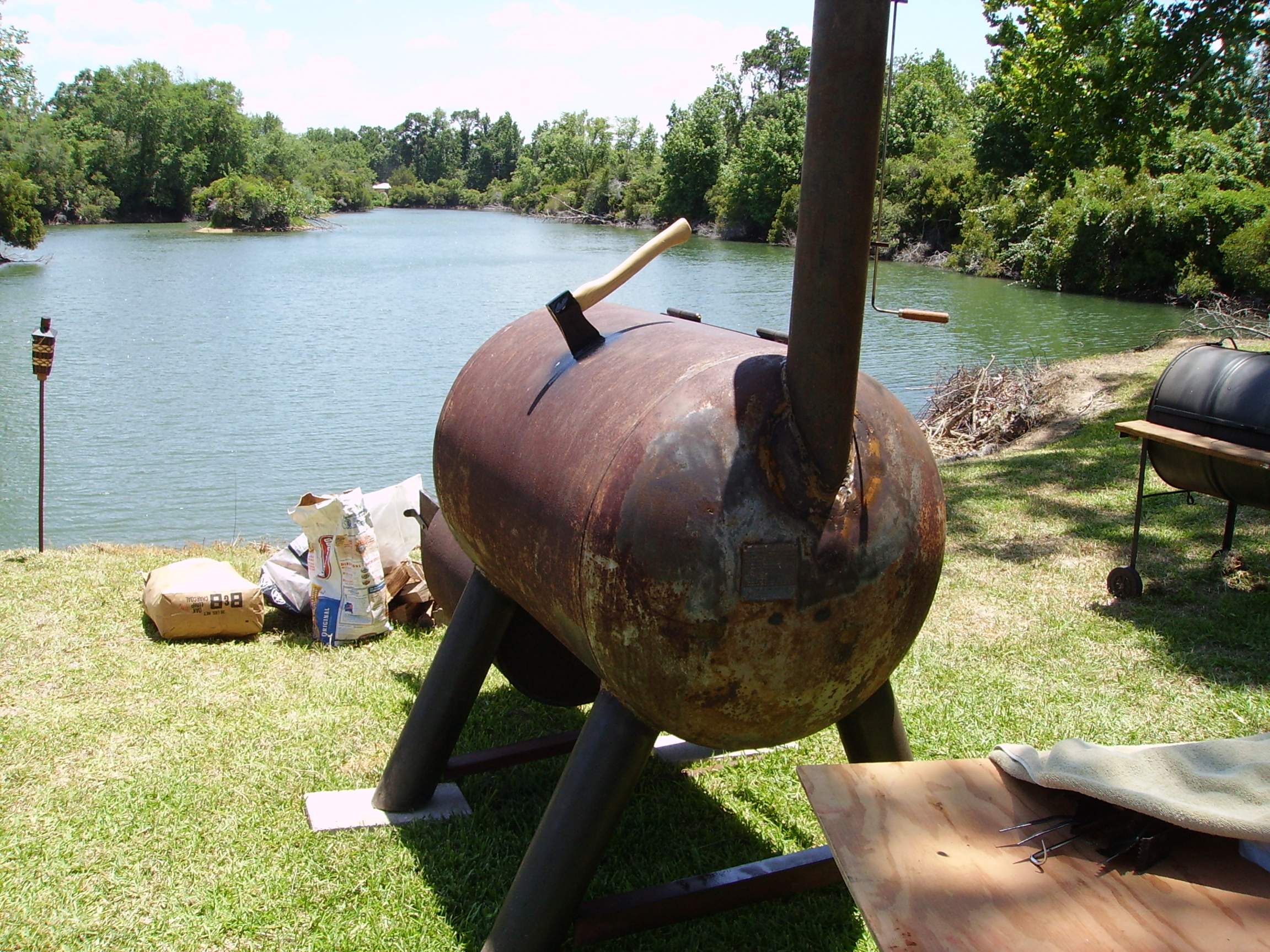

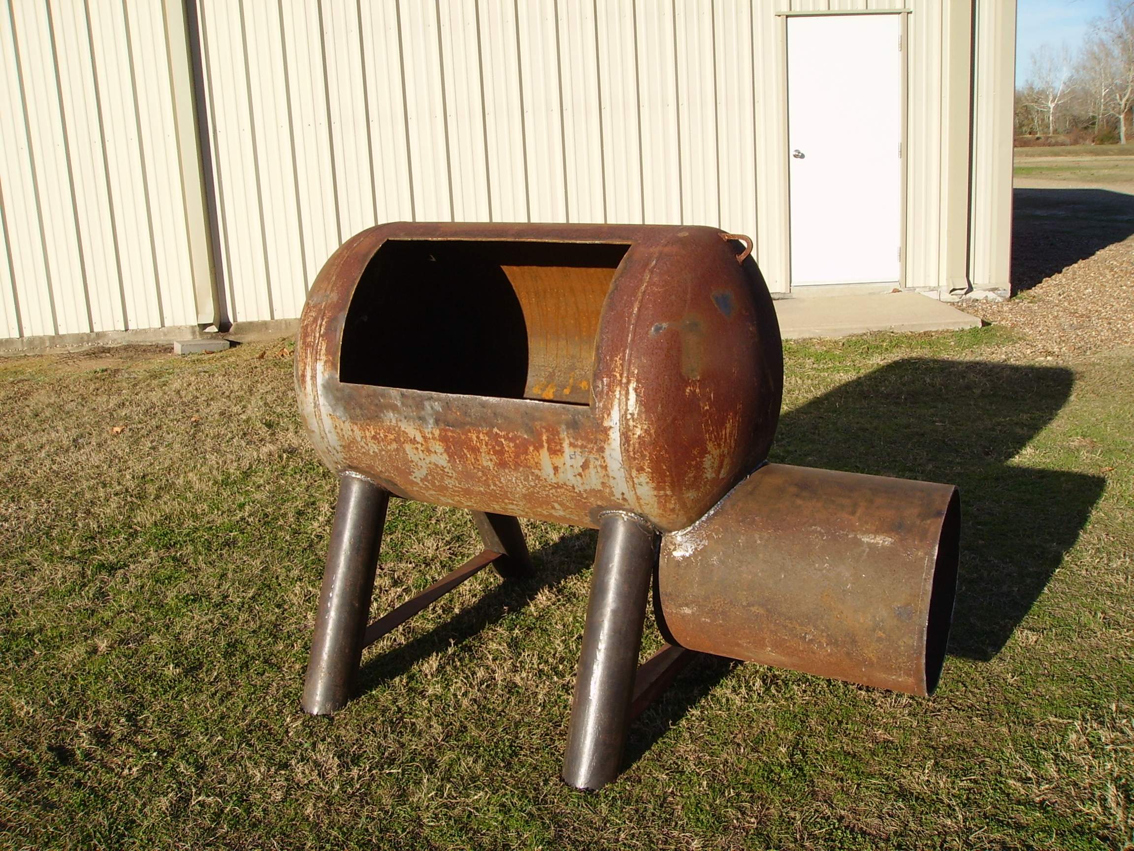

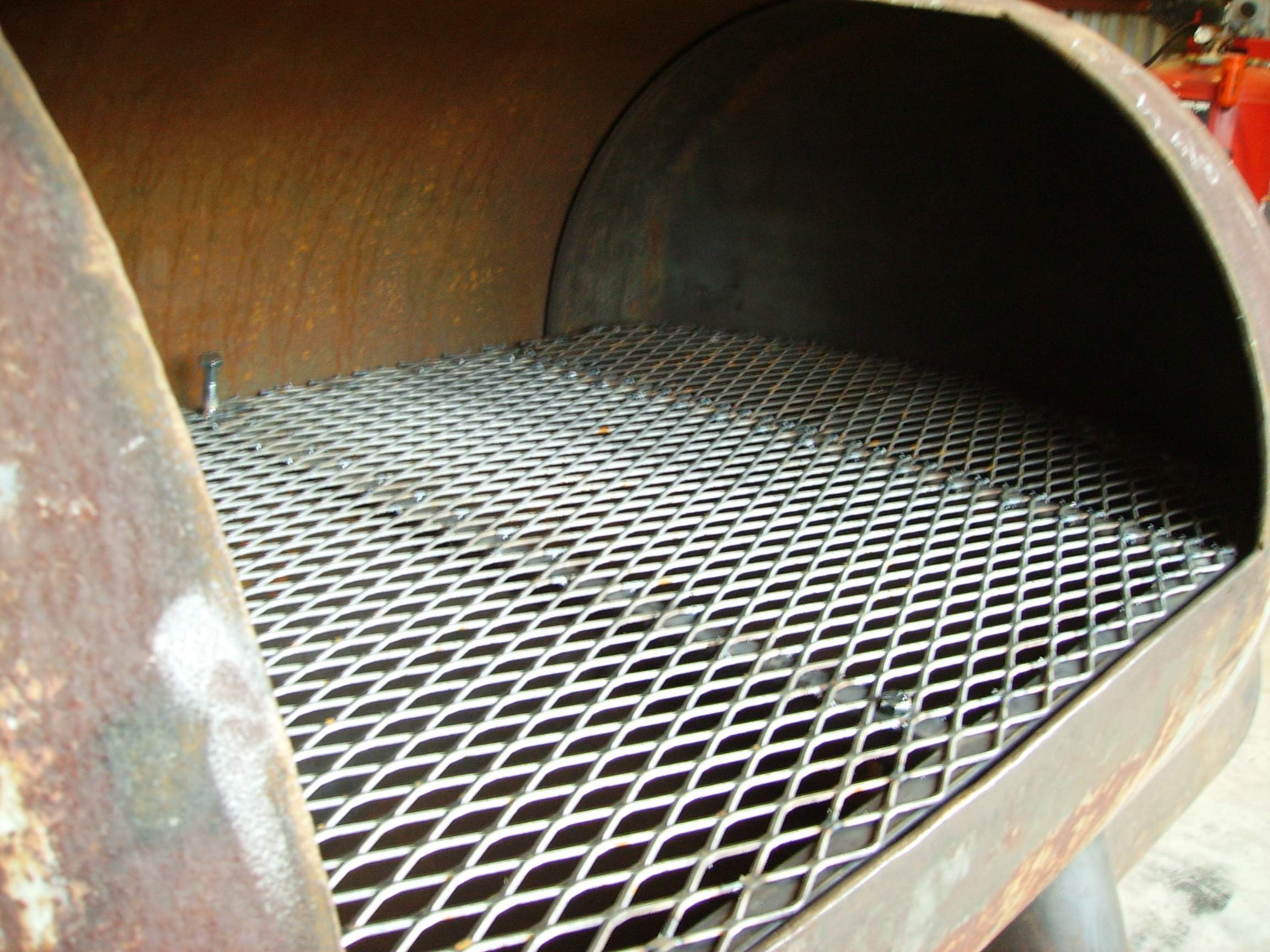

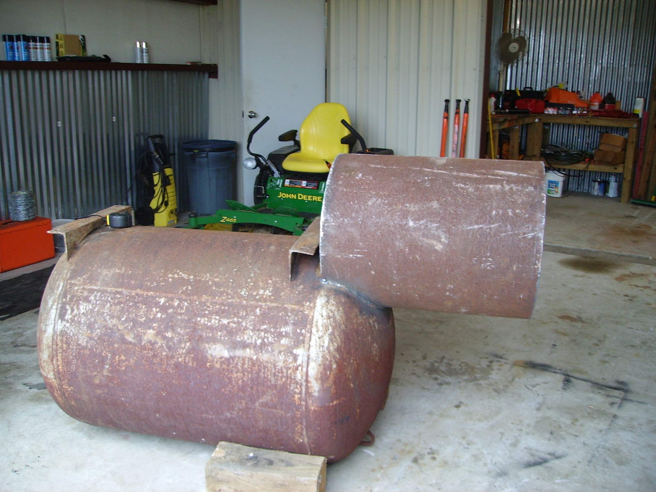

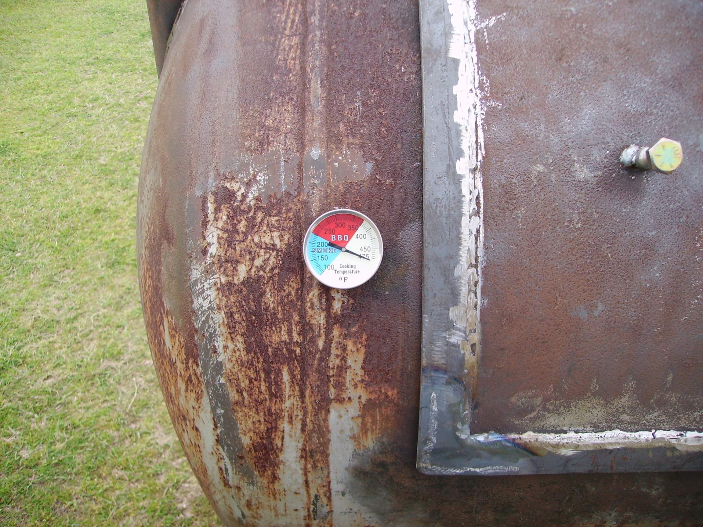

Thought I would post some picks on my home-made Smoker, Before I get bashed here, I removed all the fittings and filled the tank with water before cutting, and yes I was still afraid to cut on it, I drill a small hole in the door cut out to start the first cut easer. And to keep from warping the door, I cut about 4" and move to another corner to keep the heat down on the metal so the door will be true and have a flush fit when closed.

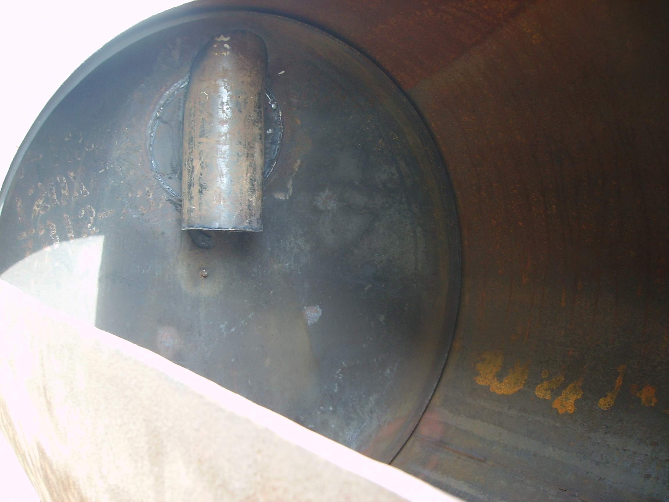

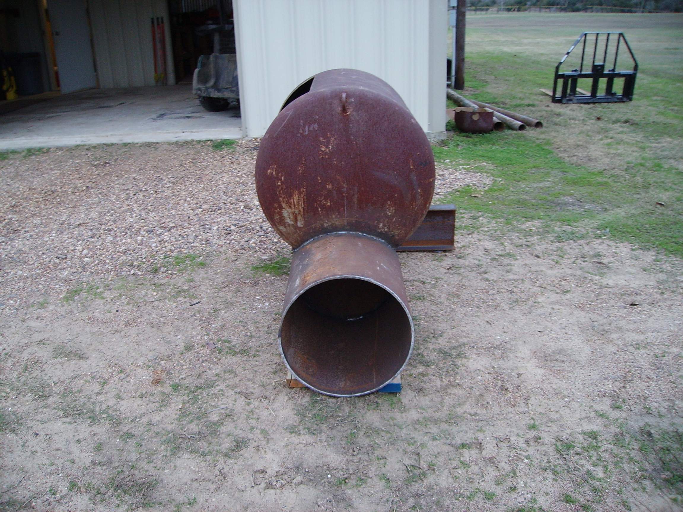

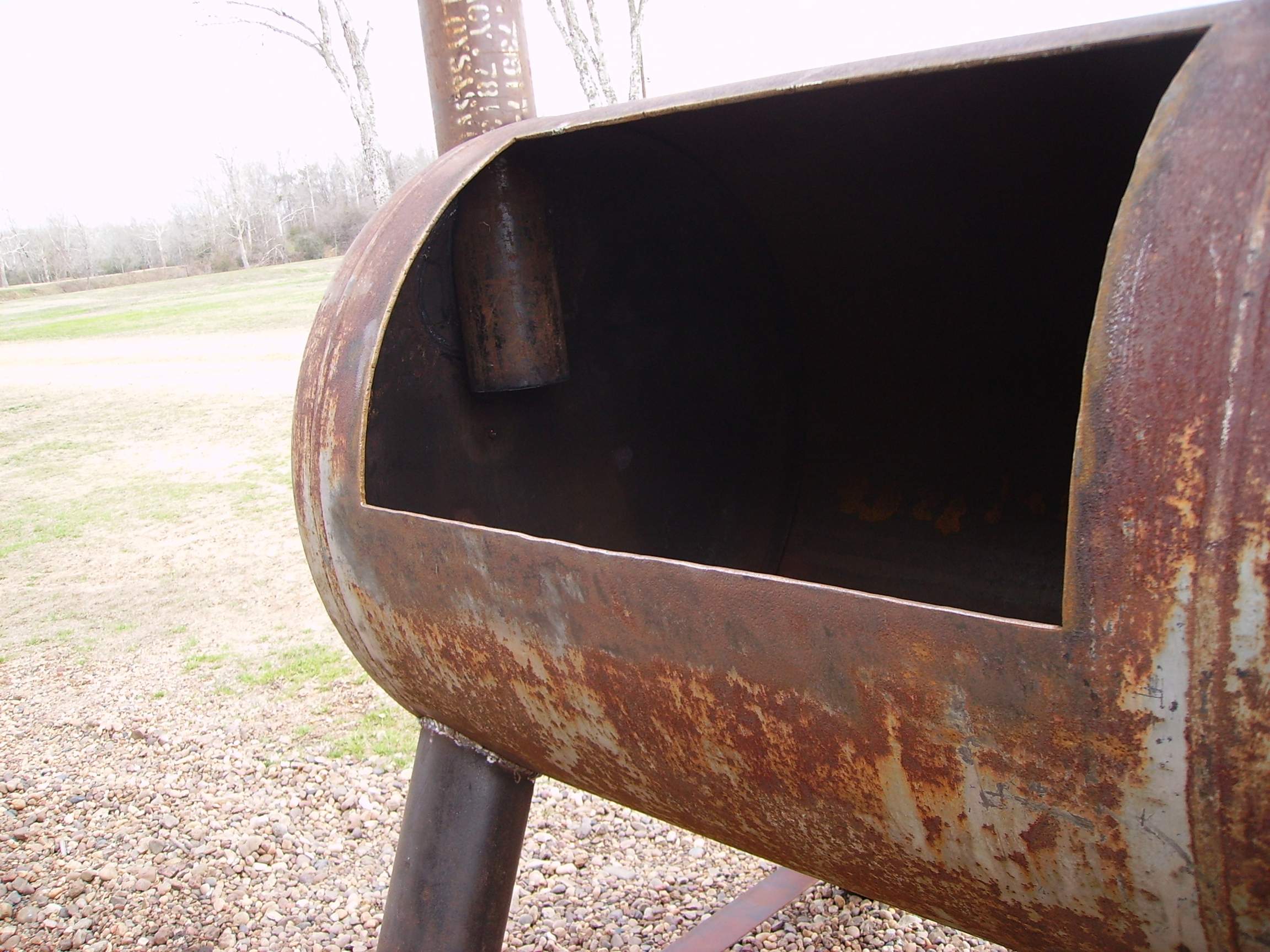

The fire box is 1/2" thick, and 22" pipe, that should last awhile. And the legs is 6" pipe and the smoke stack is 5 3/4" sch 80 pipe, I know the smoke stack seems a little heavy but it was cheap at the scrap yard.

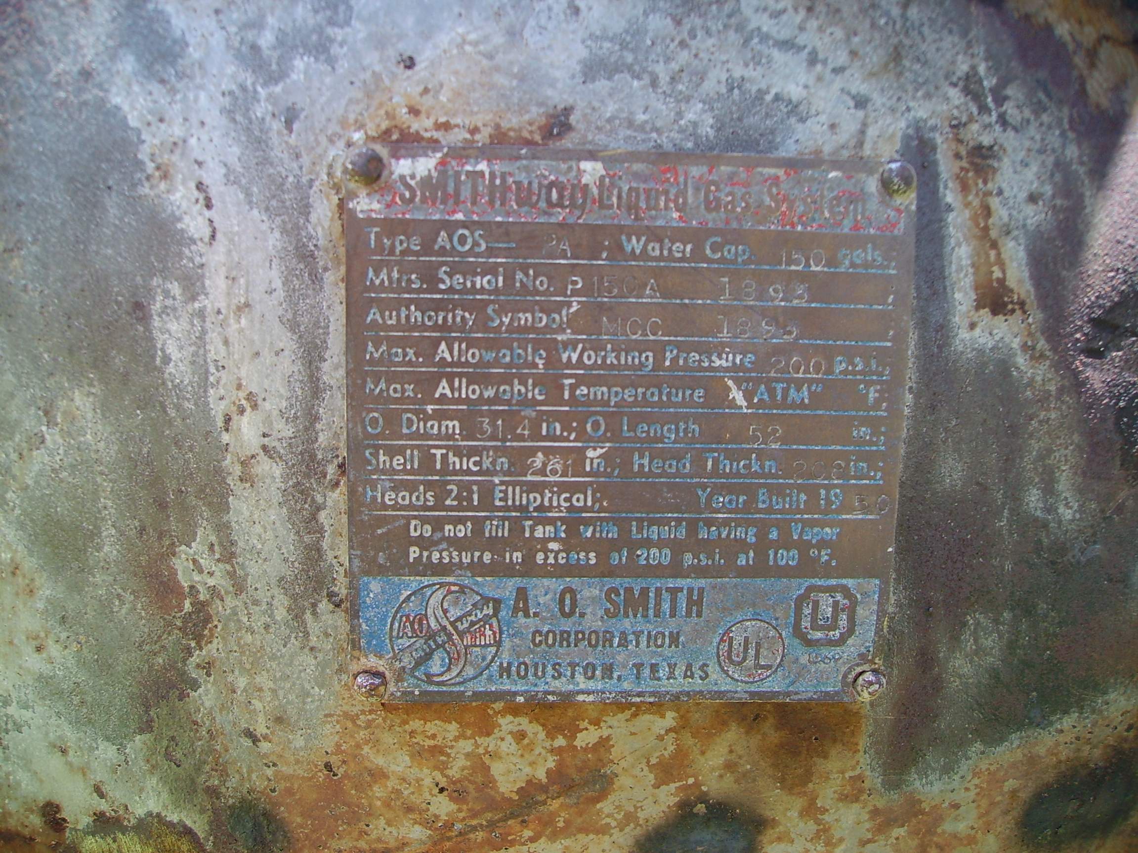

This tank is 60 years old and still has writting on the inside of the cap. 3rd pic.

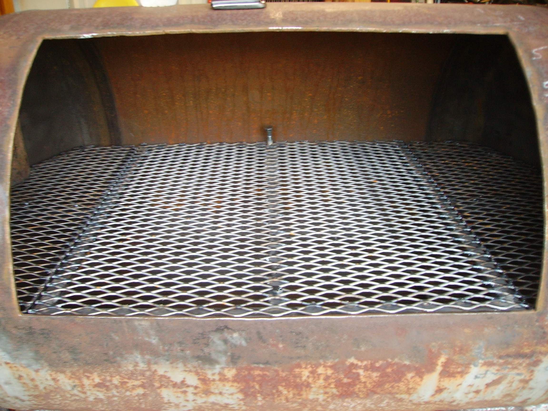

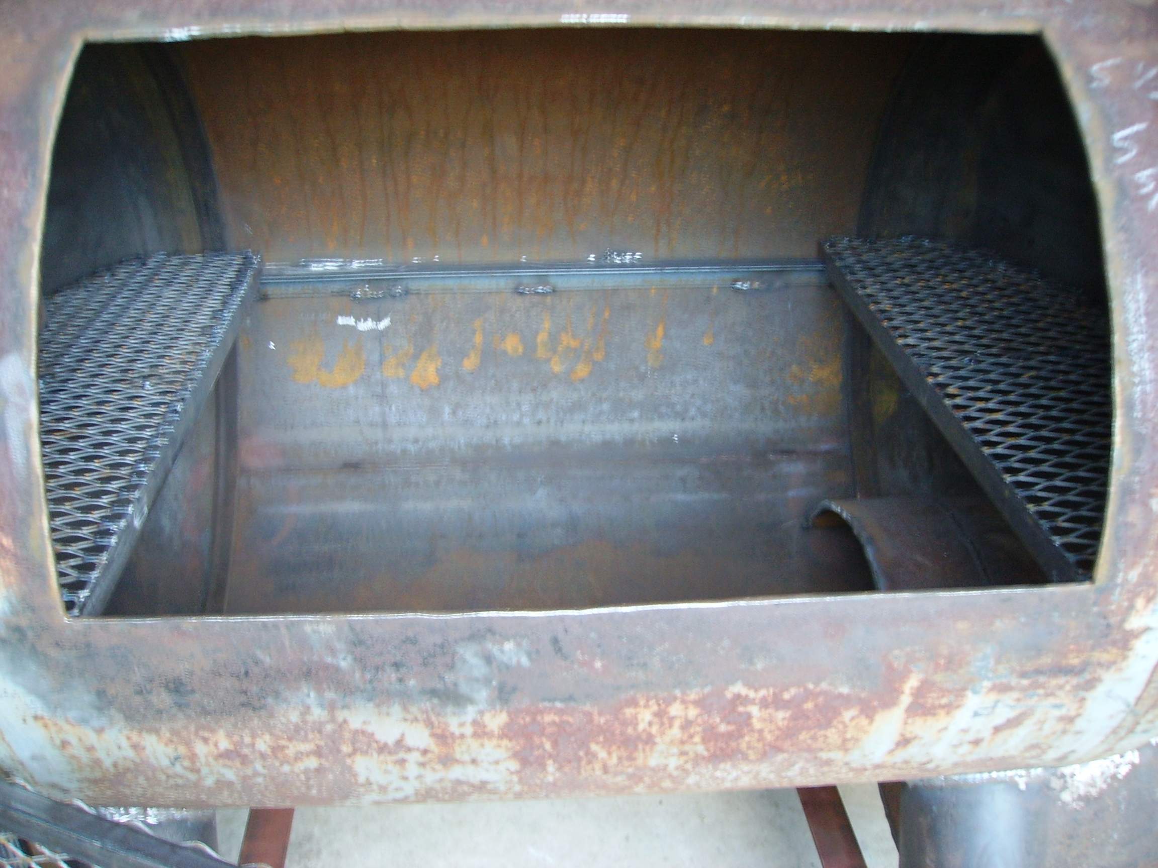

Grill area :drool:

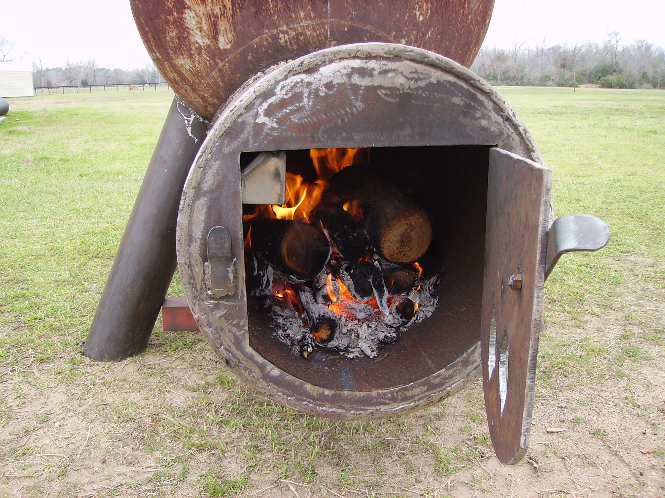

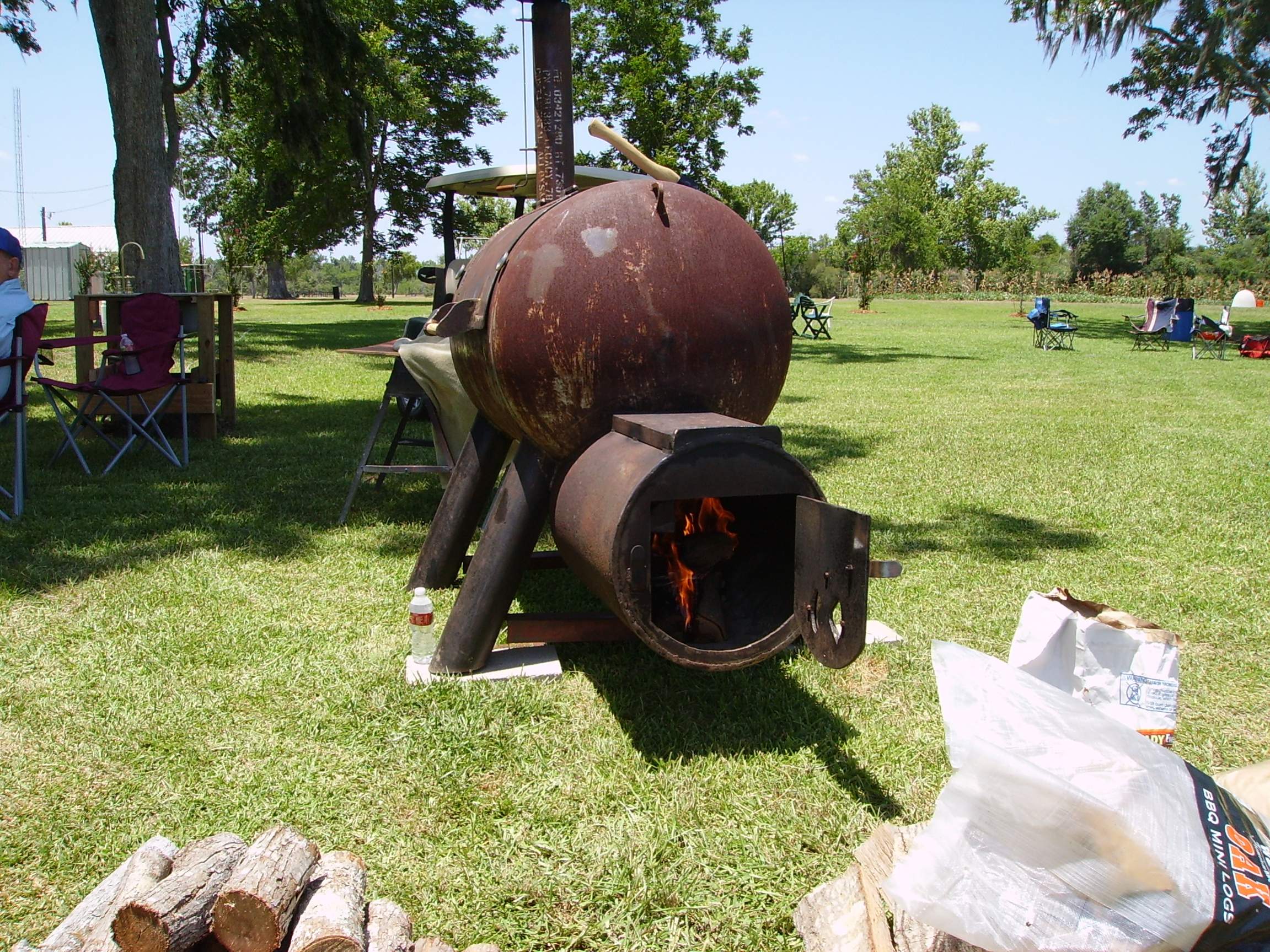

First fire to burn out smell and all the other good stuff, I got it hot as I could for 10 hours. I did this a few times before cooking on it, and for the first time to cook, I bought 20 lbs of beef fat and smoke it for a few hours to help season the pit, and wipe the whole inside with cooking oil before cooking the fat, I guess the fat was good, my dogs and the neighbors dogs ate the **** out of it, :licking: now the dogs realy like me now.

Not finished with it, the family couldnt wait, so I cooked on it the first time. Yes that is a hatchet, its for the stop when open so the door wont fold all the way back. And the 10" channel on the fire box is a bean warmer or what ever needs to be warmed up. It gets plenty hot.
On the pic with the ID tag, thought I would post it, the tank was made in 1950, Its been in our family the whole time. My mom put a folder together to show at reunions, when we used to play on it when I was young, we called it the steel Bull.
Like I said I am not finished with it, I just bought some 4x7" rect. tubbing to weld on to pick it up with my forks and to make a wood rack on the back of it.
If any of you guys see something to improve with what is already done, I am all ears.
