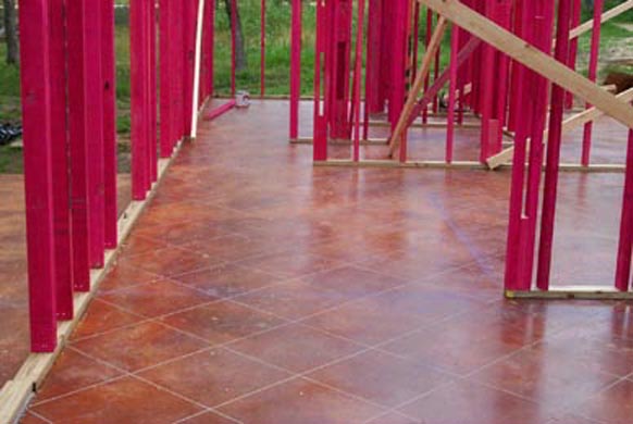

I have these type floors throughout the entire house. After the concrete was allowed to "cure" for a couple of weeks, the contractor cut grooves on 24" centers at a diagonal to the walls (diamond pattern). He then used a stain that we chose called faded terra cotta. Then a couple of coats of a sealer. Once dried, put the wall plates on the floor and proceeded with the construction.
After construction, another coat of sealer after a good cleaning. The floor temperature is not an issue where I live, except in the summer and then it is cooler. We use throw rugs on it as we would if it were tile. Works great from a cleaning standpoint and the appearance is a kind of "old floor" look. Interesting thing is because the groves were cut on the entire floor before walls were put up, the apprarance of tile is perfect and you can see the same "line" from room to room. Attached is a picture after the stain and sealer have been applied and the walls are going up.

Sorry - here is the attachment

Nice floors. Those red studs, isn't that a termite treatment? If so, how come the bottom plates are untreated pine?
   / Bare concrete floors inside the house #9
Why are the wall studs red?
Or I could have been a smart alec and said "Oh, I see you used redwood for the wall studs." /w3tcompact/icons/laugh.gif
