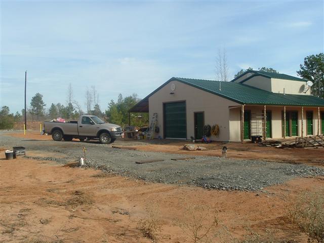

I finally got the foundation done for a 36' x 48' western style barn. I hired a GC to finish the rest keeping the barn door to myself as a project. I'm looking for sugguestions and comments on how to build the best operating barn door. I got a 10' opening on the plan. My initial thought is a sliding door. Any sugguestions? Here's a picture of the foundation pour in progress....

I might be in the minority here, but I think roll-up-doors are very attractive and in my opinion, but nicer looking than sliding doors.
The problem I have with sliding doors is making them weather proof. Due to there design and mounting methods, they tend to let allot of wind and rain through them.
Here's a picture of my rollup door. I have allot more if you're interested. Steph and I put in one afternoon. Not hard to do, but it does take more than one person.
