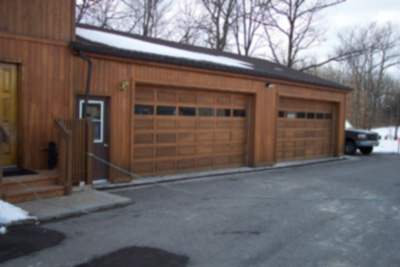

Ranchman
I think the choice of doors really depends on what you are going to use the barn and doors for. If you are only going to occaisionally move some equipment in or out such as your tractor, then one or more sliding doors would be appropriate. if you are going to store a number of pieces of equipment and/or vehicles, then I think overhead garage doors would be more appropriate. I have a 30' x 40' pole barn construction garage attached to our house in which I store four vehicles. In the winter I also store my tractor and ATV in the garage (three vehicles are for summer use only). I have two 8' x 16' overhead garage doors (see attachment) with electric openers. In not too distant future I plan to put a 25' addition on the garage including a 8' x 18' overhead door.

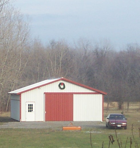

RanchMan,
My pole barn has a 10 ft. sliding door.
A concern I would have if I were you is that a sliding door prevents a significant space from having windows. My barn is 30x40 and I have attached a photo of it herein.
Buck
