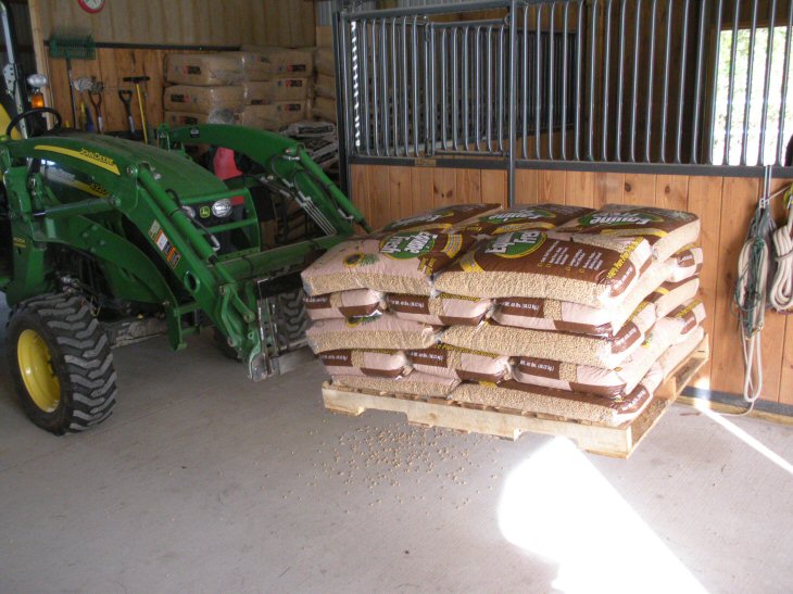

One mistake I made when we poured our barn floor, and my shop floor was NOT placing
insulating foam boards down above the vapor barrier, and before the concrete.
Steve
