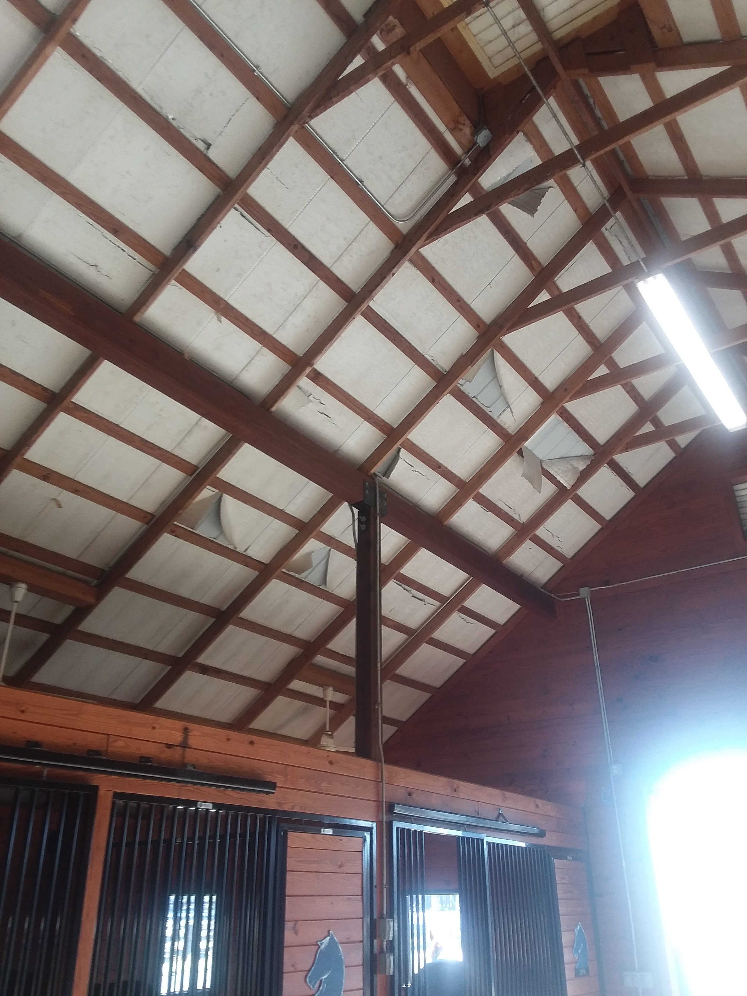

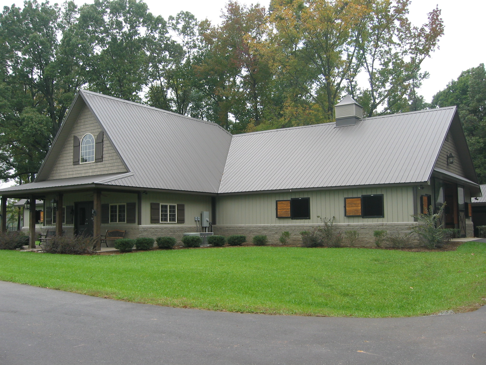

Need some of your thoughts. I built a barn for a customer almost 14 years ago and used that bubble wrap insulation under roof. Well its deteriorating and she is tired of looking at it.
I have a product that is better but my concern is stapling it to the bottom of the 2"x4" stripping. Won't we have an issue with condensation collecting at the stripping and rotting it? She's not interested in removing the metal and installing the insulation then putting the metal back down. Which, to me, is the proper way to do it. Aesthetically I don't think there is a lot of choices. She doesn't want spray foam and she doesn't want to cover it with a ceiling.

Removing the metal and installing the insulation then putting the metal back down. Which, to me, is the proper way to do it , Thats the only it will look right, Very nice looking barn

It is a nice looking barn by the way. I would live in it except for the crappy insulation.

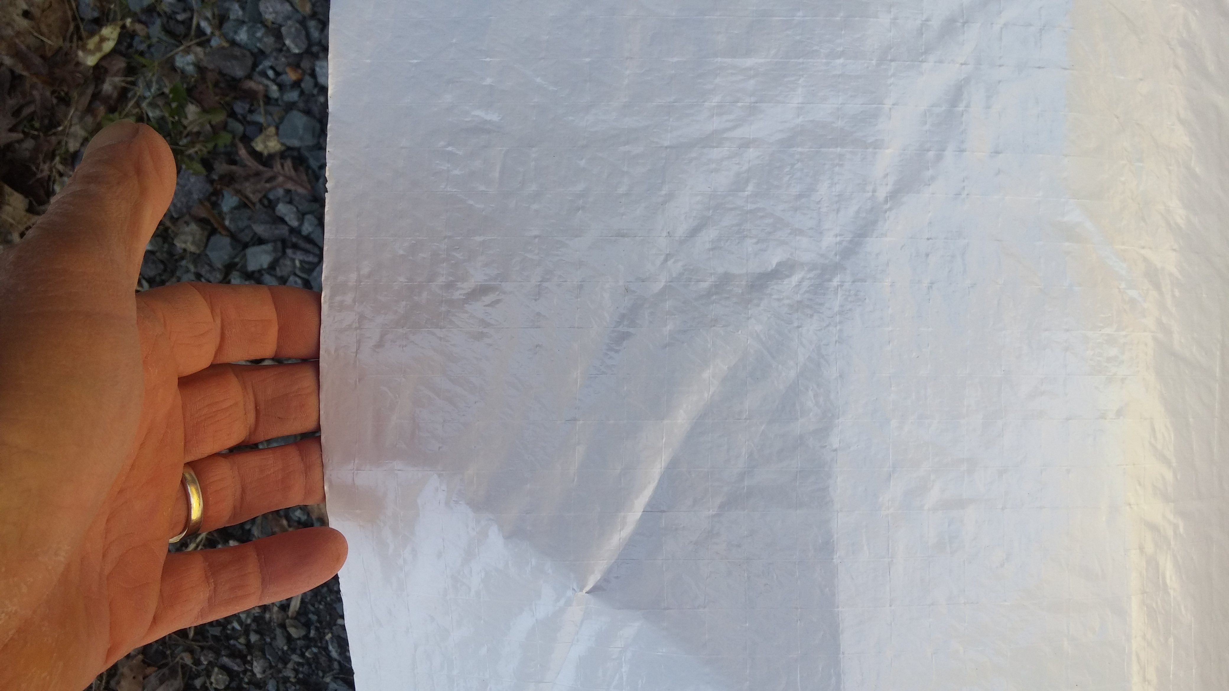

Thanks guys. Metal is screwed. It has a full apt over the tackroom where the caretaker lives. This is what I use now. Not a good picture but its foil one side white on the other. The white has string in it like shipping tape. Insulation is fiberglass, about 3/8" thick.

You'd get more R value out of it by stapling it under the perlins where it wouldn't be compressed ( also giving you an air space in between) and there's no reason for condensation.

Agree. I have always thought the idea was to keep the warm air in the barn off of the metal to prevent condensation. Putting it under the purlins with the air space would do that.

anything under 1" for insulation is in my opinion, useless. A good option is to add soffit and ridge venting if needed then install insulated sheathing to the underside between the rafters and paint it.
