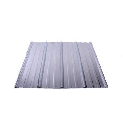

I have a 28'x22' barn/ garage with a metal roof I installed myself (metal from HD) ... & it leaks/ drips only when it's raining (i.e. not from sweating).
I used the twist-nails with the soft lead washers pre-attached to them. All nails are on the top of each metal sheet's "^" ridge (i.e. not down on the flat surface, which I have seen others do).
So far I haven't been able to figure out exactly where the drips come in, but I suspect maybe from the metal ridge cap overlap joints since the drips seem to occur mainly right down the center of the barn, under the ridge. When I installed the caps I overlapped them about 3"-4" if I remember correctly.
The barn has open trusses (no ceiling) so I can get up in there if I have to, although the ridge height is only about 4', so it's no fun :)
When I installed the metal roof pieces, I ran them up toward the peak to within about 2" of the peak, to allow for some air flow, but to still have enough for the ridge cap to sit on.
Does anybody have any insight/ ideas? I seem to remember reading where sometimes tar paper is put down under the metal first because the metal can sweat. I didn't know anything about that at the time, so didn't do it; just put the metal right down on my 2x4 runners.
I could replace the nails with screws if anybody thinks they're the problem. I could remove the cap & replace it, if needed, maybe more overlap between the cap pieces is needed?

OK, I went to the HD website to find the exact name for what I installed, & sorry but (not that it prob matters) I had forgotten that I actually used "Fabral 36 in. x 8 ft. Shelterguard 29 Gauge Steel Panel Galvanized". It's the 3' wide metal, & I was actually able to get 16-foot lengths, so no joints. Here's a pic: (I had used the 2' wide ^^__^__^^_ metal on my little well pump house)

I believe I could remove all of the lead-washered nails with vice grips & replace them with rubber-washered screws ... wouldn't be fun, but ... however, as I mentioned I'm pretty sure the leaks are at the ridge cap since the drips occur right down the center of the bldg under ridge line. There don't seem to be any other drips occurring further down the slopes anywhere.
Maybe I just need to, as said, get a wider ridge cap & attached it with the rubber-washered screws?
Edit: The metal that's leaking for me looks like the "Eagle Rib Panel" on this picture:

I think the space between the sheets at the ridge might be a bit wide. i agree with the wider ridge piece as at least the first step. or get under there when its raining and get a look see.
