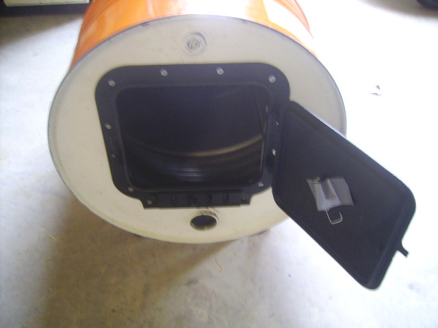

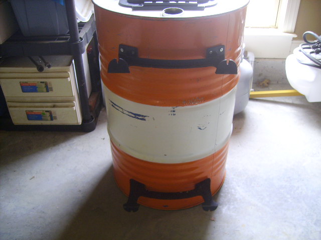

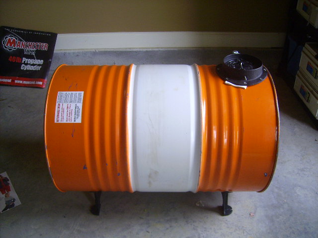

I have a small (around 1000 sq ft) hunting cabin. I have used a propane stove and space heaters to heat it since building it around 10 years ago. The propane heater has been acting up lately, and also someone recently stole the 20 gallon propane cylinder that sits outside, so I decided to build a barrel wood stove to replace the propane stove.

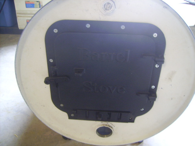

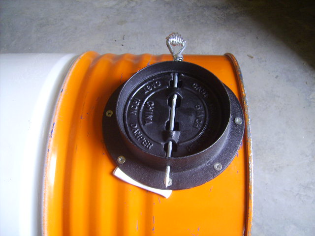

The barrel stove was fairly simple to build, lots of you tube videos on the subject. You just buy a kit for around $50.00-60.00, cut holes in the barrel (I used a jigsaw) and install with the hardware provided. The kit has a door, legs, and stove pipe insert with a built in damper. You do have to provide your own barrel.
I haven't installed the stove at the cabin yet. I'll report how it performs once it is in.

I think you'll like it, I've been using them for years. I currently heat my woodworking shop and my garage with barrel stoves, they warm up quickly and do a pretty good burn, if you get all the air gaps sealed up. I have found that the cheaper the kit is, the more problems you'll have in operation. I would recommend that you put some sand at in the bottom, fire brick works even better to help keep the bottom from rusting out.
Edited to add: I just looked a little close at your pics and it looks to me like that kit came from United States Stove, if so, make sure you put some flat gasket material between the stove and door and between the stove and the flue outlet, that will help make it a little more airtight. There isn't much you can do about the air damper under the door (they don't seal very good), but you will like the amount of heat it puts out, plus with a barrel, you can cut your firewood in longer lengths to get a better fill on those real cold nights.

As per above and make sure you light a good fire in it outside first so that the paint all burns off outside the cabin. Red or orange automotive silicone works great for sealing off air leaks. It's rated to 750 F which should be lots fro what you want to do.

Yes I plan on doing an outside burn prior to using inside. I will paint it with high temp paint after the initial burn has removed the original paint.

It is a US Stove brand. That is the only one I could find. All the retailers around here were sold out except for this one I found at TSC. It was their last one and all the other TSC stores in the area were sold out. Is the Vogelzang brand better than US Stove?

I do like the Vogelzang a lot better than the US Stove model, even though it's about twice the money, it's just made better and much easier to keep airtight. I have one Vogelzang and one that I ordered from our RECC magazine several years ago, it doesn't have a name stamped on it and I haven't seen them advertised for a long time.
I wound up using the Meeco high temp silicone, it's been on one of the stoves for 8 years now, no problems.

Instead of high temp silicone I used furnace cement on the mating surfaces of the chimney collar and door frame. I also used fiberglass stove gasket in the joint where the barrel lid meets the barrel. Idea being that I can remove the lid if necessary for maintenance and still have a relatively airtight seal. We'll see how it all holds together with use. I've also thought about installing a glass window in the door, and installing a smoke plate for a more complete burn, but those are down the road.
