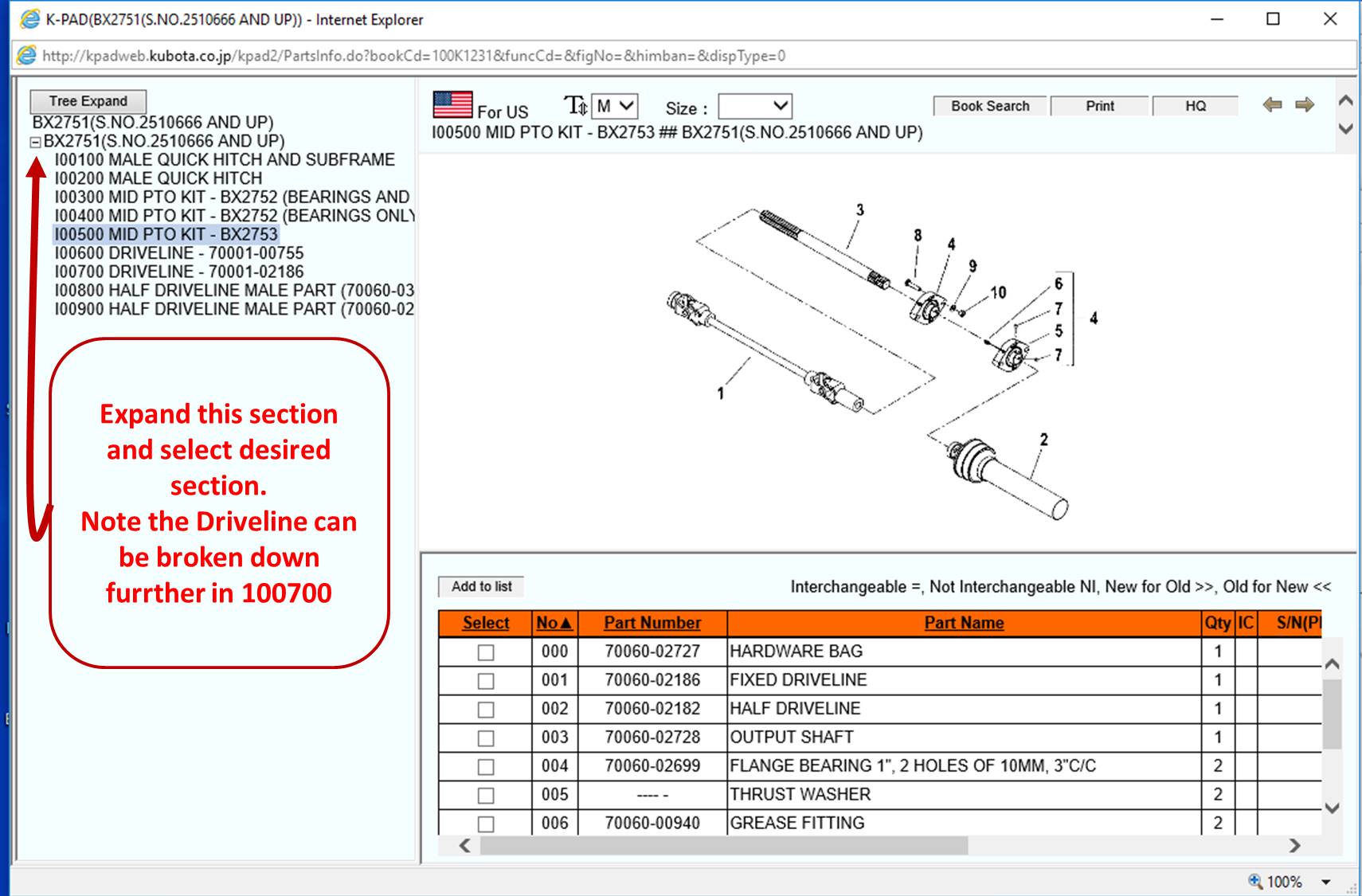

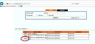

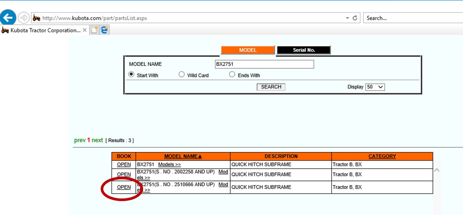

Go to Kubota.com. Select "Parts". Sign the agreement to proceed.
Enter BX2751 in the Search box Several Options will appear. You want the one at the bottom for the higher serial numbers. Select the Link under the "Book" Heading. Another window will open but no images will be displayed yet. Expand the Tree in the left hand side of window. Once expanded you'll find the desired drivetrain. Select the one you want and a parts drawing will appear along with a parts list.
I'd supply a direct link but it doesn't work. This will get you to the Term/Conditions page. http://www.kubota.com/part/partsList.aspx
Hope this helps.
You can buy the shaft with yokes or just the shaft and transfer the u-joints and such from the shaft you have
EDIT: Added Photos and pricing
70060-02186 Assembly $254.85
70060-02338 Shaft Only $131.38
(Prices per Messick's website)
