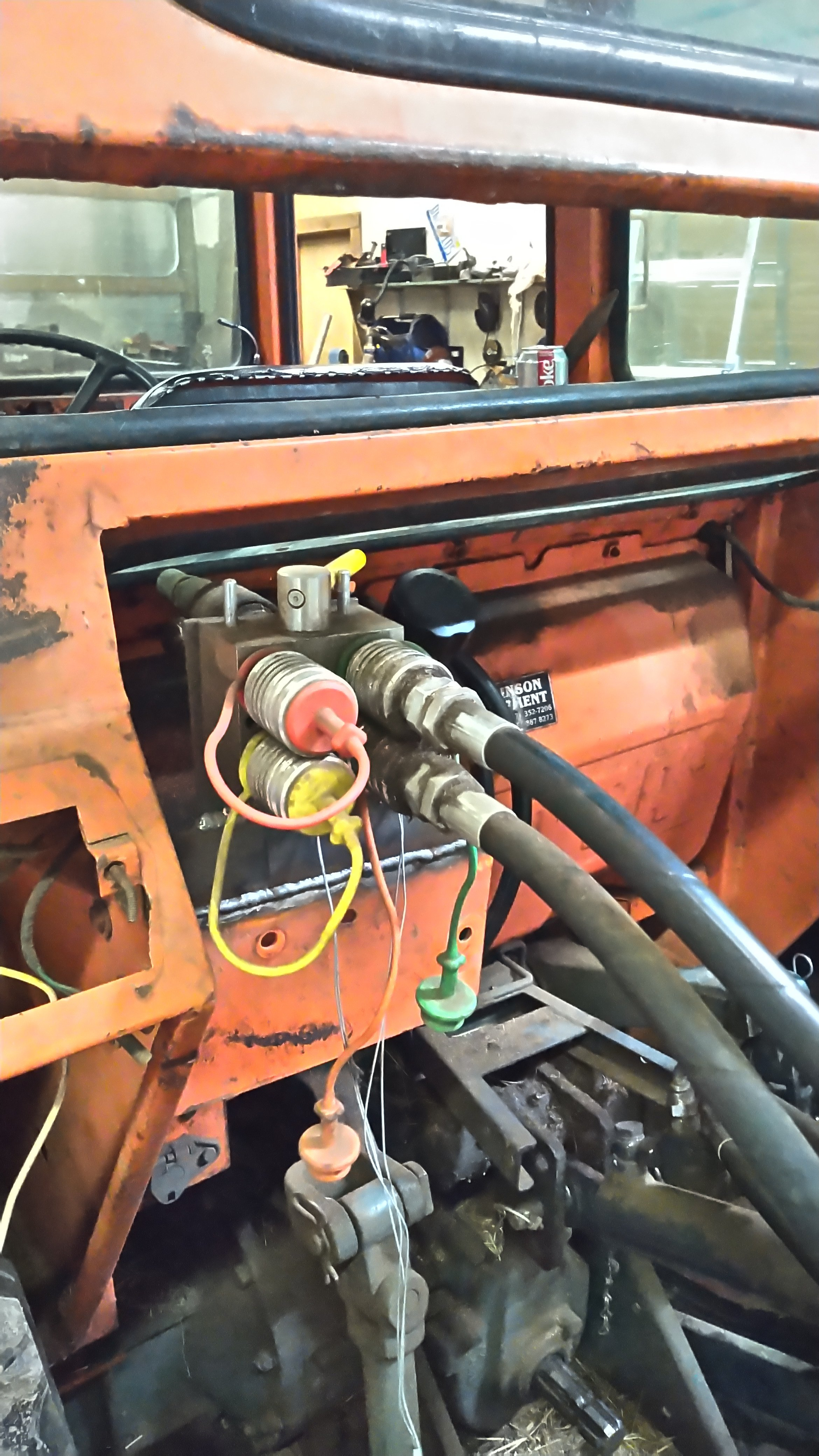

You can always get a manual lever operated multiplier. Less than $300 I like mine and it was worth it for me.

Please correct me if I'm wrong but all top and tilt is is a hydraulic operated top and side link? A manually operated multiplier is simple if you have only one remote, you can make a bracket to easily switch the circuit from your seat.
