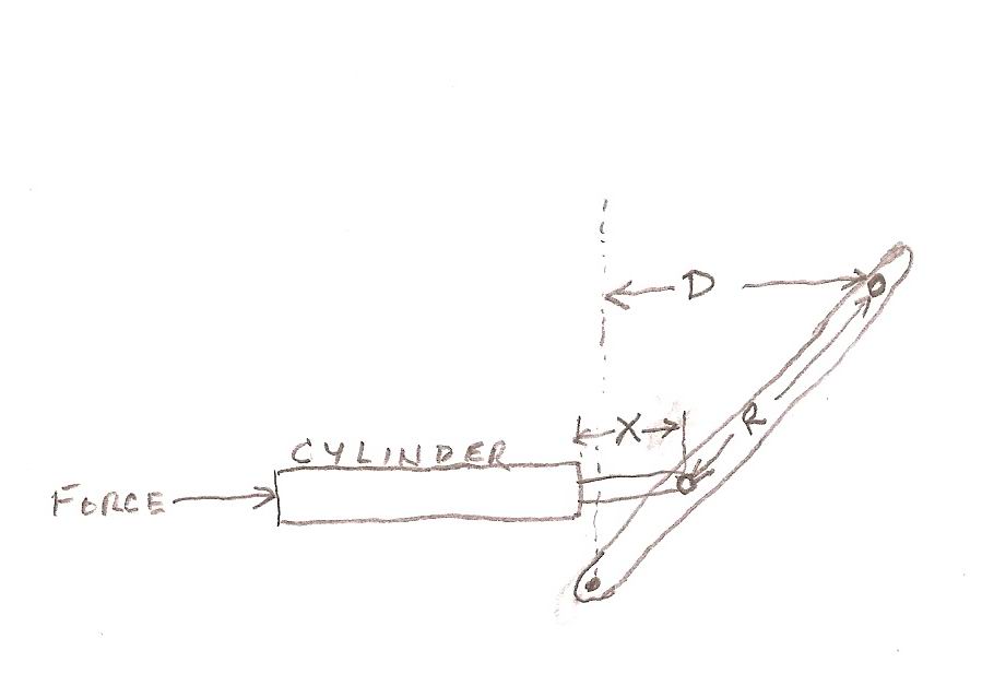

Hello all,
Last summer I bought a JD2305, and since then it's kind of gotten me interested in knowing a little more about hydraulics. Does anybody know if there is a site, sort of like "Hydraulics for Dummies" available? Is there also anything available with formulas that would cover the drawing I've tried to make, in other words, if the rod of the cylinder travels 'X' amount, what distance 'D' would result, depending I guess on how far away, 'R' is?
I know it probably takes a long time to fully understand hydraulics, but as I said, I would like to start with the basics?

Since you show your cylinder as being horizontal, then your answer is simply geometry. You need to know the distance from either point on the arm to the arm pivot point though.
However, if the cylinder pivots separately from the arm, then things get a little trickier.
I have some text books I got from John Deere that are pretty good and easy to understand. Don't have the tittles handy though. I think you can find them on their site (somewhere).
Sizing the ram travel is again, just geometry. Sizing the ram bore will require more info like what kind of work the lever arm has to do. Then you size the system requirements to the ram. Once the system pressure is enough to actually move the ram (under load) then more pressure will just just make it move faster.
