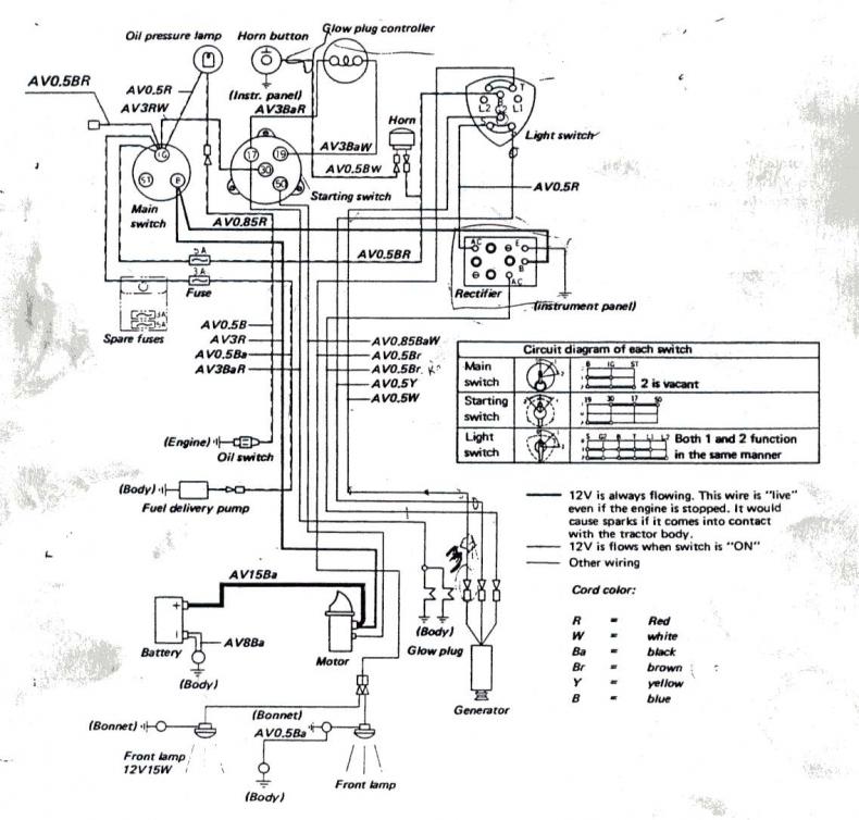

I doubt it is a 3 phase PMG, if it has an extra leg for light wiring, it may have separate coils which it switches into circuit to supply the lamps.
EDIT: I reckon I found a similar circuit to yours, which appears to switch in extra capacity (I expect extra coils), when the light switch is turned on.
   / Battery charging problem #10
There's no extra coils in your diagram. It's set up to run the lights on AC and charge the battery with DC. It the lights aren't on, there's no flow of AC. Many older lawn tractors do the same thing using a 2 (sometimes 3) segment alternator, especially the Briggs engines. One wire from the coil will have an in-line diode to charge the battery and the other one/two wires are used strictly for lights. Others had a separate diode bridge, and depending on the load, used DC for lights.
The OP stated there were separate modules for the rectifier and regulator. Perhaps the regulator is used strictly for gauges or something. That's why I'd like to "see" what he has.
