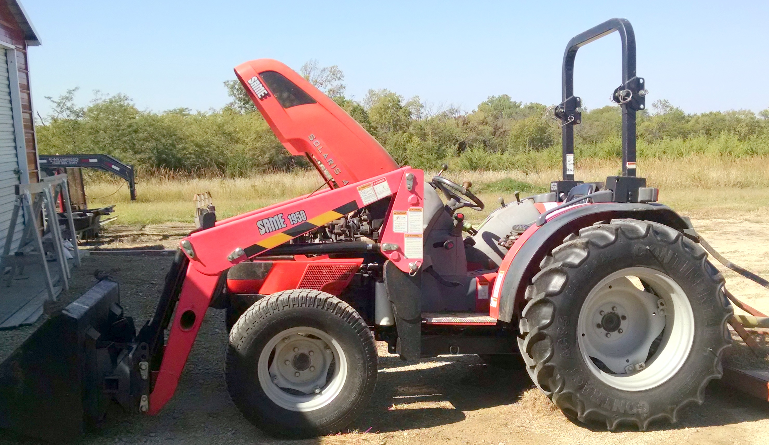

SAME 40hp turbo charged 4cyl diesel w/fel

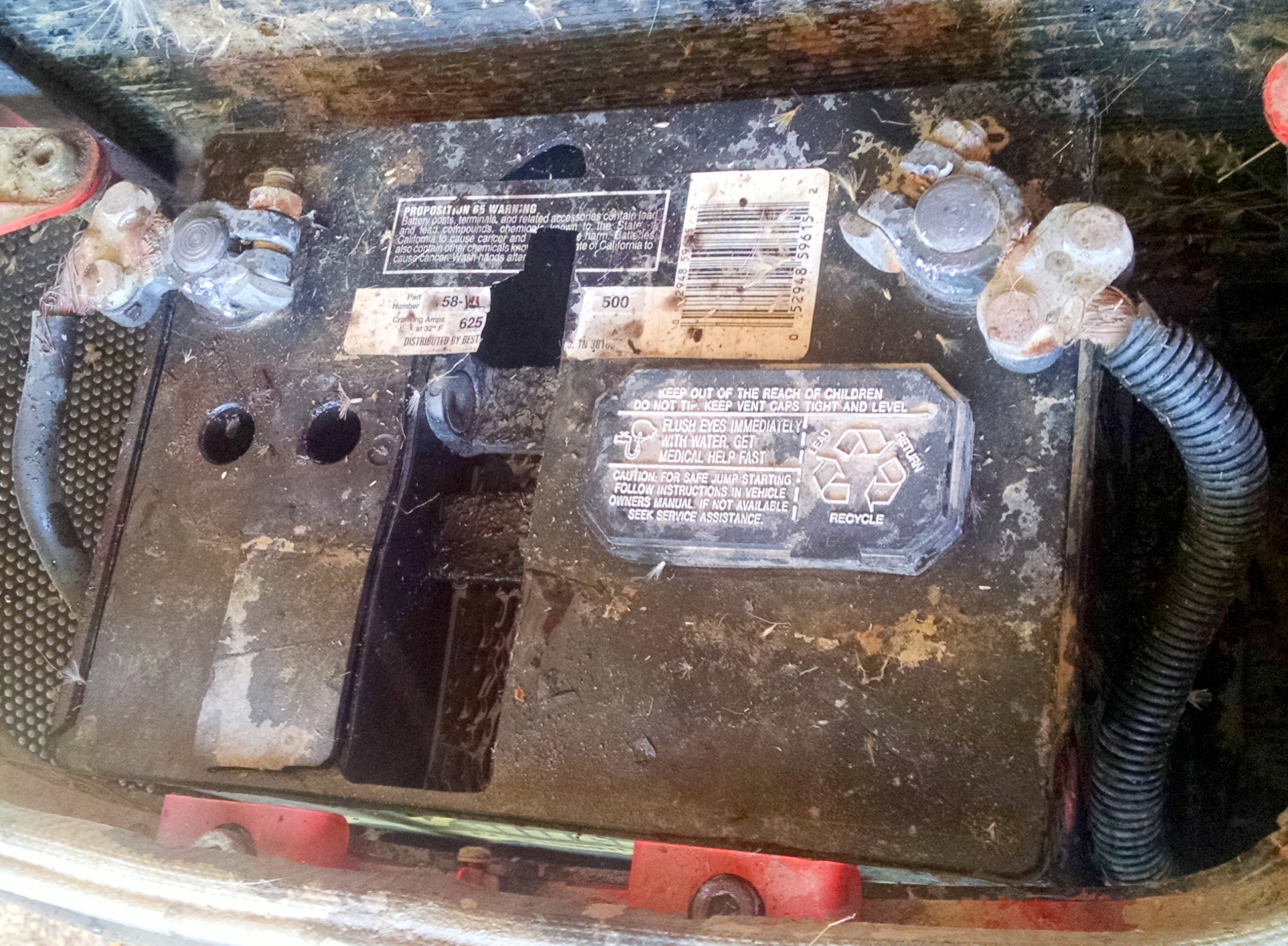

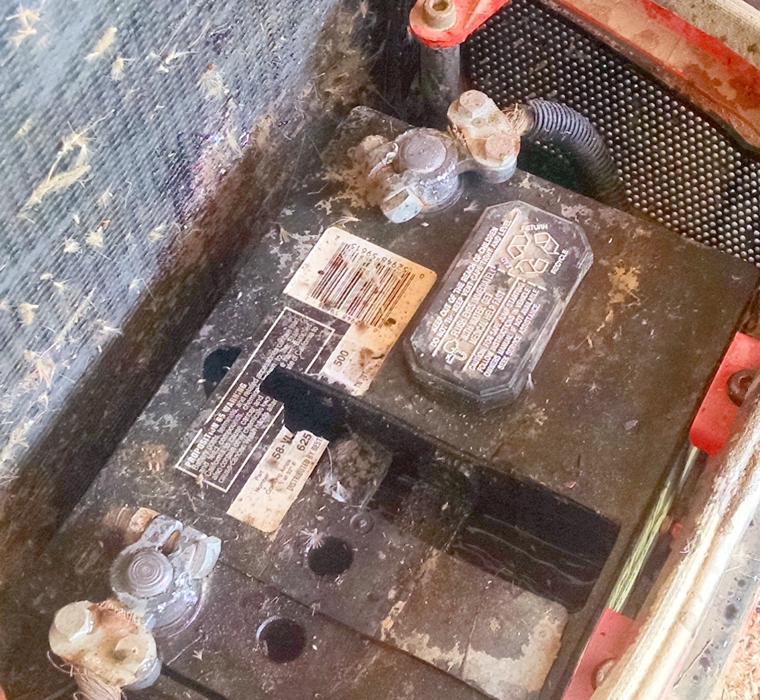

Well my 35hp turbo SAME ran fine yesterday. It started a little a slow...like battery was under charged but it had been a couple of weeks since I last ran it. I parked it as under the machine shed area. Then I noticed later in the day I was getting a bad right rear flat so I went to start it and the when I turned the key it just went click click click....like battery was dead.
Hooked up the smart charger over night and went out this morning and turned the key and BOOM!!!!! I think I have some other than just a bad battery, something maybe in the charging system.
Photos and video below

What probably happened is that you have a bad cell in the battery, which caused the slow starting and eventually discharged it. When charging, it wouldn't get to the proper voltage so it overcharged, venting off Hydrogen gas, which ignited when you activated the starter, causing a spark that backfed into the boiling cell, which would appear to be #3 or 4.
A new battery after a washdown of the area with baking soda and water should cure the problem, don't see any system problems indicated.

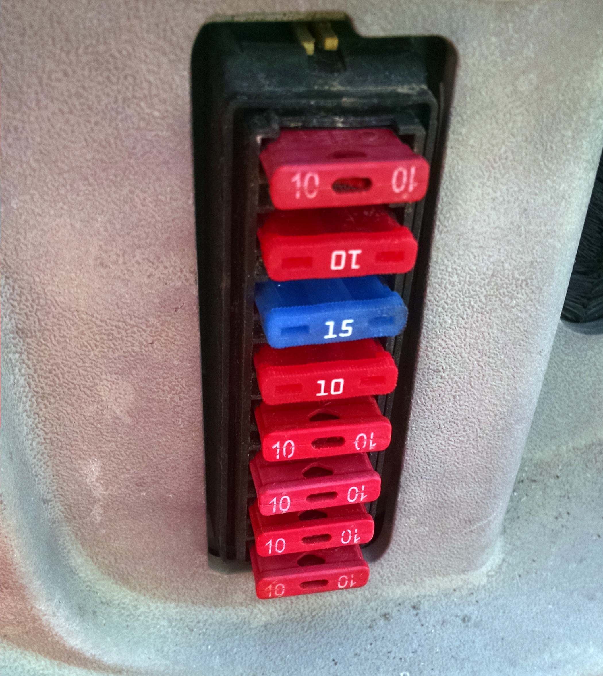

Good Afternoon Dave,
It kind of sounds like the selenoid is trying to engage when you were pushing that fuse in. Definitely some electrical issues.
I don't have an answer on that problem, but I would suggest that you neutralize any areas that may have gotten covered with battery acid !

Thank you, I washed the whole engine compartment as well as the front of the tractor to get the battery acid removed. Talk about a surprise....almost dove for cover when it went off :shocked:
I kind of thought I had a bad cell on the battery afterward but perplexed as to the other items noted in the video. As much as I hate to have to do it, I might have to take it to the dealer....painful $$ so i would like to try to solve this. :confused3: I don't want to drop a new battery in until I hve sorted out those items as I am concerned something caused the bad cell given what happen to the antigravity jump pack
