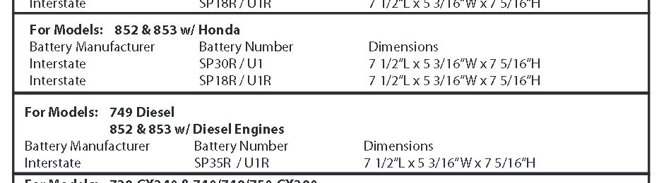

The parts manual for the BCS 853 only shows a 14-16ah battery. Does anyone have a brand and part# that they use? The 948 doesn't show anything regarding electric start, but the battery/tool tray and 0lastic cover are the same part numbers.

BCS service bulletin https://s3.amazonaws.com/bcs-america/manuals/Service-info-2-7.pdf shows Interstate battery #s.
Hope that helps?
