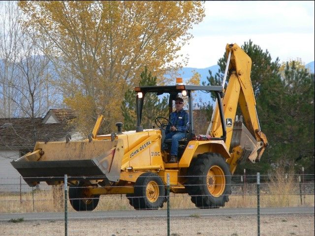

Anybody know whats a good replacement battery for a full sized hoe? Wal-Mart sells a 'Marine' battery thats supposed to be a deep cycle (what ever that means) with 875 CA. The case is bigger than car batteries, but cranking amps is lower /forums/images/graemlins/confused.gif Price is right at $64, anybody use one of these? Its called a MAX 29. Any suggestions short of the over priced dealer? Its getting cold here these days and that 4 cyl diesel is hard to spin with the small car battery it now has.

Thanks all for the info. Using two 6v batteries sounds like a very good way to get a lot of juice, never thought of that. I checked the starting amps in the book and to my surprise my machine only requires 375 CCA, but thats at zero degrees. Still, I think I'd be OK with the Wal Mart deep cycle battery as it has 675 CCA at 32 deg. The write up on that model battery says its made special for vibration, which comes with use in a heavy machine. So I think I'll get one of those, for $64 its priced right.
Attached pic of my backhoe is where the battery will go.
