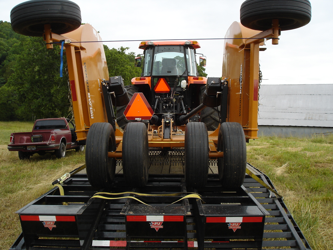

Another batwing question, getting ready to pull the trigger on a MX15 John Deere, it comes standard with four tires, two on the main frame cutter and one for each wing. Each axel can have another tire added to it to make them duals, my thought was to add two more tires to the main frame cutter since they are carrying all the weight, but the dealer salesperson said it would be better to add the extras on the wings to help keep them from gouging.
What do you think? Extra tires on the wings or extra tires on the main cutter? Or both? Each extra set of two costs $800...

Except that the center deck wheels are handling their weight plus the weight of the wing decks while the wings are up and their weight plus about half the weight of the wing decks while the wings are down.
I would dual the center deck wheels and leave the sides as singles.
Here is a video of one that has duals on both: John Deere MX15 Mower - YouTube
And the Deere site which shows it with duals in the center but singles on the wings: John*Deere MX15 Rotary Cutter Medium-Duty Rotary Cutters & Shredders JohnDeere.com
It looks (from the Deere site) almost like the duals are just a spindle that goes into a pipe on the other side of the existing bracket, so you could switch them from the center to the wings if you don't like them in the center.

Aaron, I've seen both those links, been doing a few searches. As you stated so well, the center carries all the weight, thought that should be the one to get the extra tires - but then the dealer said I should put them on the wings so they don't gouge.
Was hoping someone would chime in that had run a batwing. Do the wings gouge, either on a down or upward slope?

Looking on Tractorhouse and Ebay, I see many (7/10?) with duals in the center and singles on the wings. A few (2/10?) with singles for both and very few (1/10?) with duals on both. I did not find any with duals on the wings but singles in the center.
Thinking, the only scenario I can see where the wings would rut with singles but not with duals would be if that edge was in soft ground while the center was on hard ground. If the whole thing was on soft ground the center would sink worse than the wings.

This is the best option, IMHO and it is available on Bush Hog as well. 1 wheel per wing deck is sufficient.
   / Batwing question - how many tires are enough?? #9
my jd 1517 has 4 on the center and one on each wing... not a problem at all..
Likewise my BH 2515. I really don't mow if the ground is so soft that the wheel sink in.
You want all the stability you can get when the wings are upright, you don't want it tilting while going through a gate.
