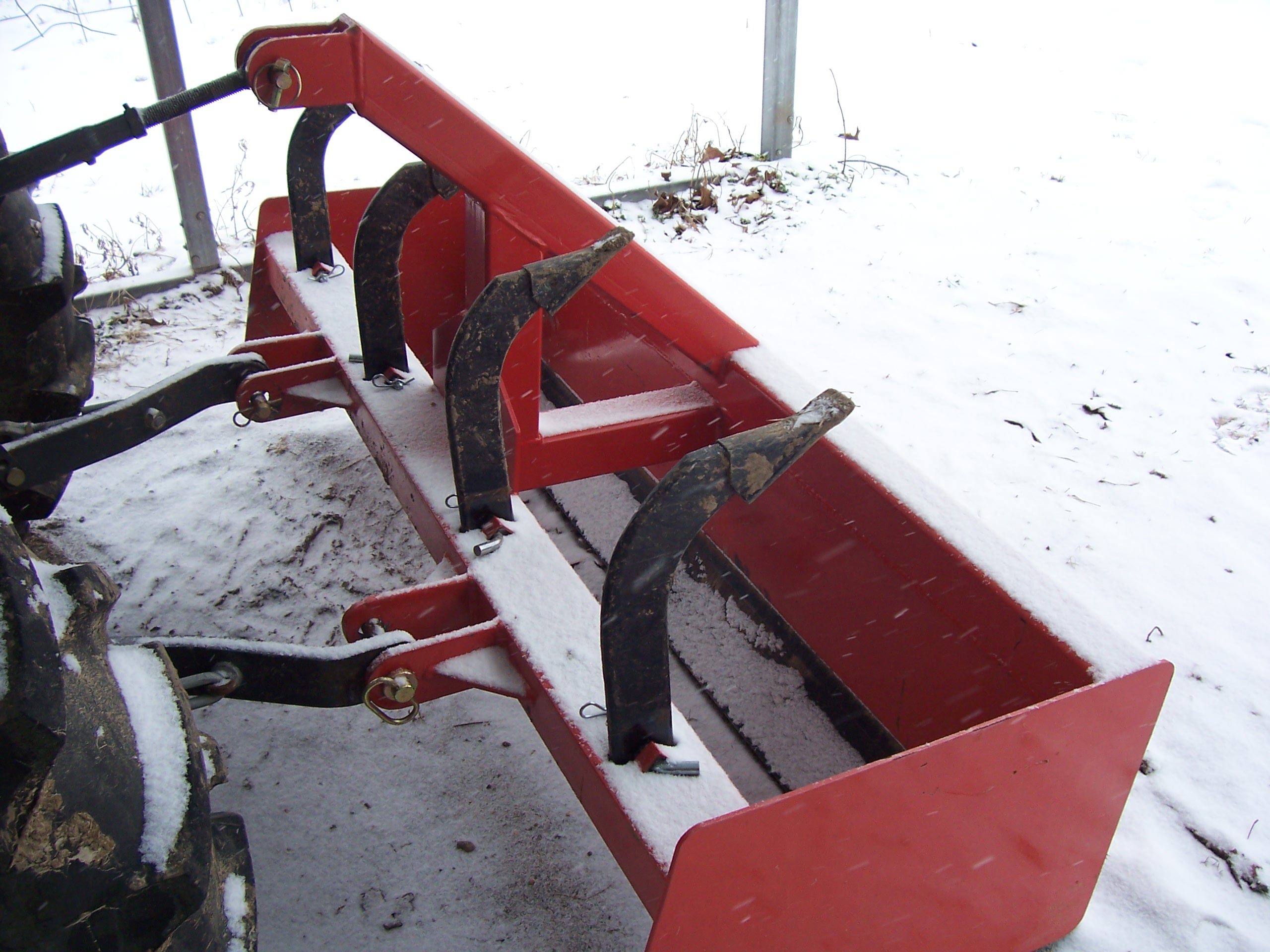

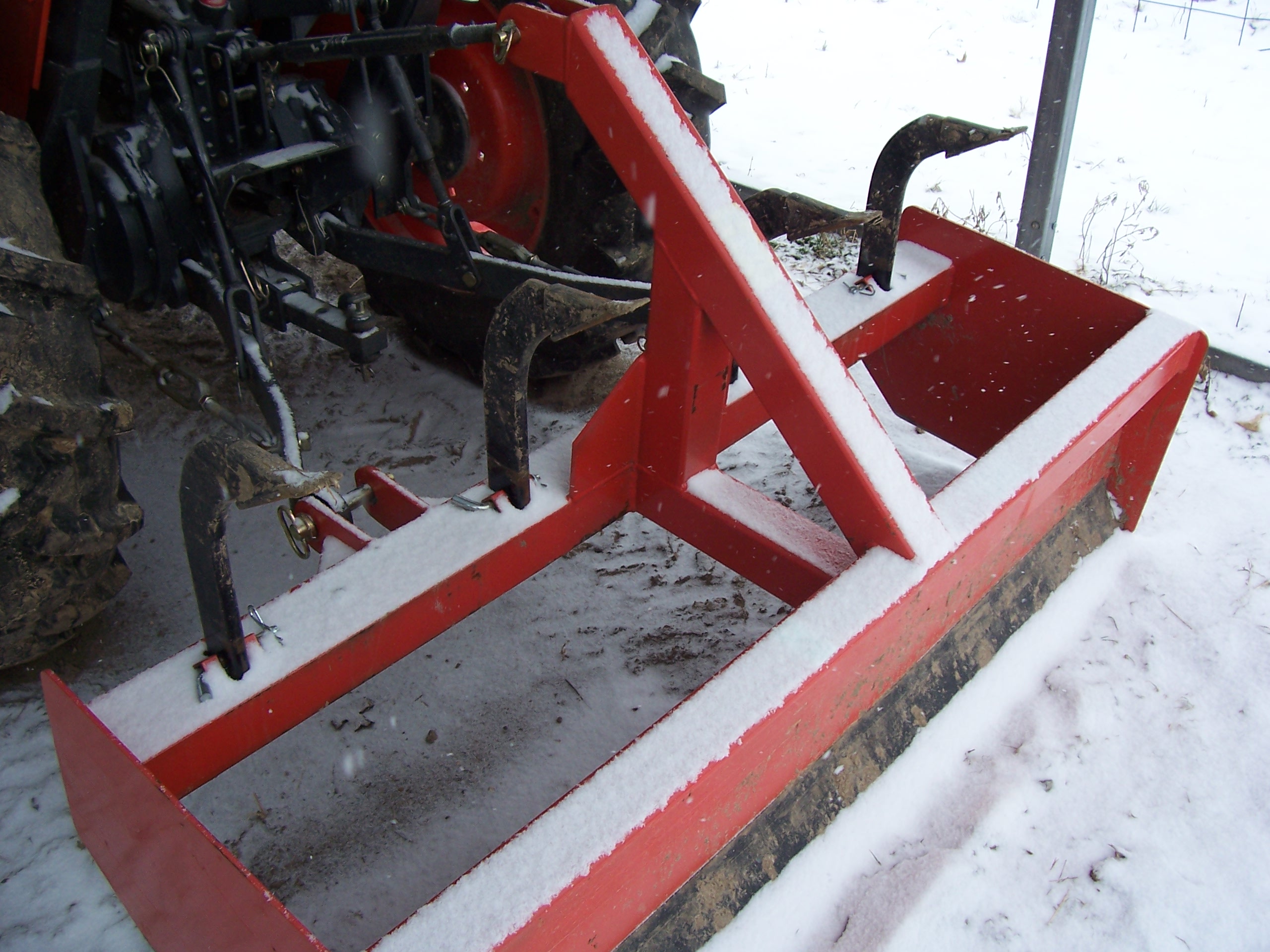

Thanks for the input. I found a locally made BB for a good price. In practicing using it, I snagged something that stopped the tractor dead in it's tracks. All four wheels digging holes. Nothing broke. I guess that's a good sign. Now I want a hydraulic top link.

MB - don't know if your pins fit your lift arms, but they're too small for the bb holes, which will get egged out. If they fit your arms, maybe you need Cat. 2 bushings for the box blade? Something for a snug fit would improve the life expectancy. The thing looks rugged enough - nice to find something locally made.
