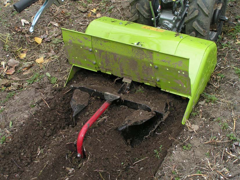

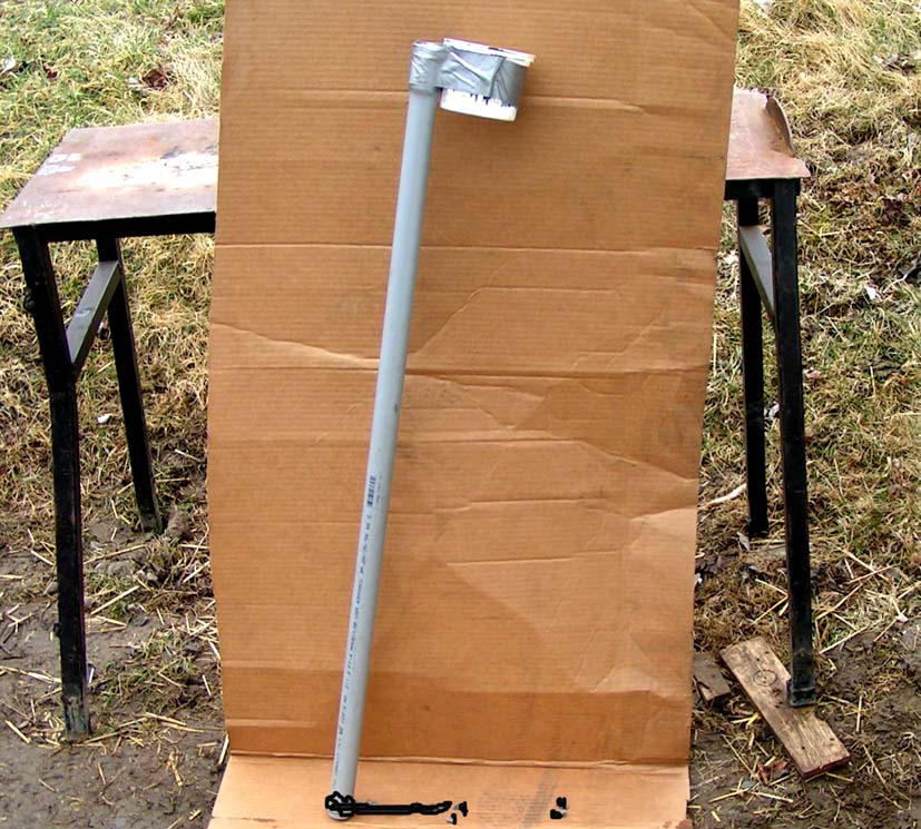

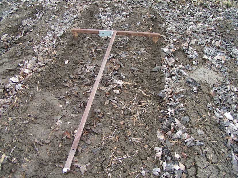

Hi! For rows I use Home made Marker(ajustable). I pull it by hand. Very fast and easy.
At spring I use my Grillo 107d with My special tool For make small hills about 3 in. high I till 2-3 in deep make hill and row in one operation. I run one wheel in marker row.
I make tests small hills give a better germination for beans.
I make one hand seeder I put seeds usually two ( Beans corns peas etc ) in tube and seeds drop in good place 6 in. distant Save your back I like it.
Between rows ( 32 in.) I till 1-2 in. deep for weeds.
Good gardening . Oldmech

Hi! Voyageur. If you make a lot of potatoes. May be a Bed chaper DOUBLE RIDGER (ajustable) implemnt. When plants 2 in.high After a good tillage 3 in. You adjust double ridger for cover potatoes row. at least 2 in over leafs. You drive in center or over row . Later you can reverse the double ridger for go between rows. This implement can save a lot of hard work. I would like to have one. Good gardening Everybody! Oldmech
